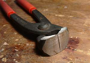

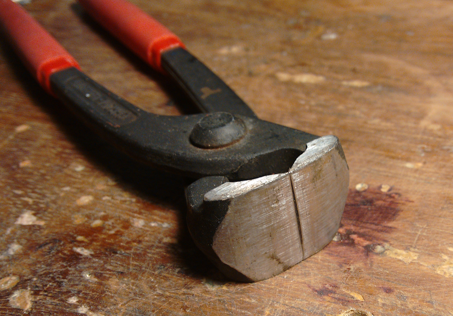

    Testing testing is it just Chrome?
    I got these from the green shed. Used my rotary tool to grind it flat and sharp.
    Removes the frets well, just be careful and they shouldn't get bent.

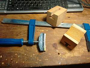

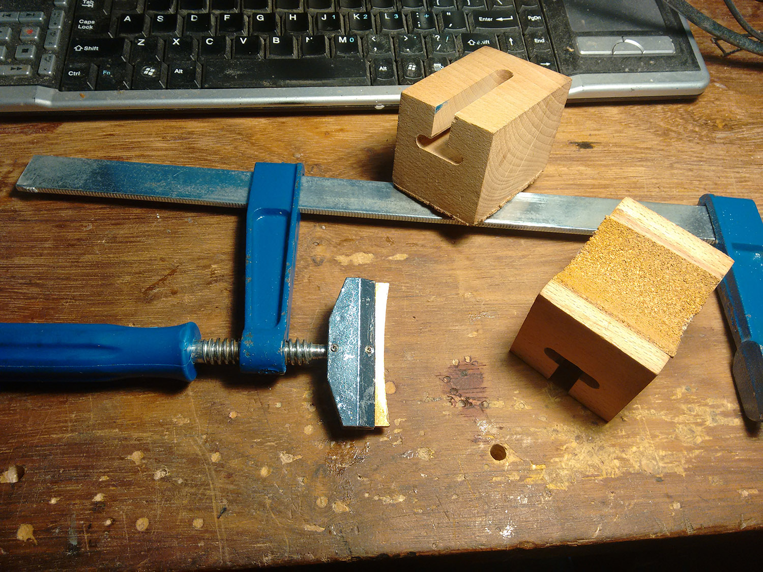

    Here's my fret replacing system.
    Fairly cheap on ebay
    Alright now officially switched to 'Opera' browser.
    cheers, Mark.
