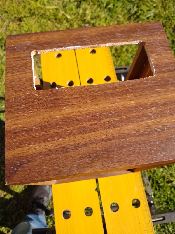

    The coping saw I bought for the tele headstock worked nicely for this job too. This is the cutout for the controls. It will be hidden by the MDF control plate which I also cut today. I didn't drill it though since I haven't tested whether I can omit the preamp volume or not.Click image for larger version.
