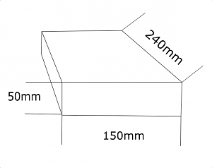

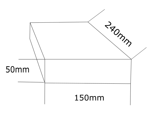

    I just tested using a few books I have around, and found one that fits perfectly under foot, is a comfortable height, and is high enough for the potential electronics and wiring.
    Two people have generously offered to help with the box construction, so please let me know if those dimensions are OK. Otherwise I am sure I can knock something together with BGS pine.

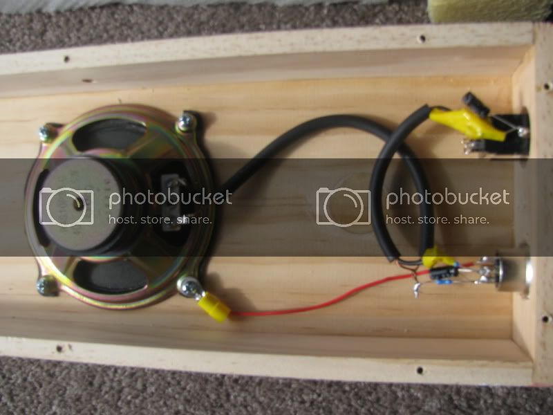

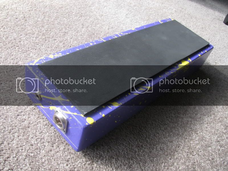

    Plan 1 for the speaker is to fit the piezo transducer, a small amp and the speaker all in the box, to see if an all in one solution can be made. I suspect the thump would be less than satisfying, but it might work for home use. Feedback might be an issue though. OK, ditch plan 1.
    Plan 2 for the speaker is that some people have used a small speaker as the microphone instead of piezo pickups. Some claim they give a better thump. For example, here is a simple design that doesn't even use a preamp. Not sure if they have something off-board or run straight to amp or mixer:
ID:	35317Click image for larger version.

    For the electrical side of things, if a speaker works well enough without a preamp then I would probably fit a passive tone and volume control, maybe something like the Fender Greasebucket - the high and low pass controls might be nice, but then it might be better to have separate pots for bass and treble.
    If I use a piezo or if the speaker-mike needs an amp, then I will probably use a simple preamp on stripboard along either a 2 or 3 pot tone circuit and volume. The box dimensions should have room along the top edge (150mm) for 4 pots, DC jack, and 6.5mm output jack.

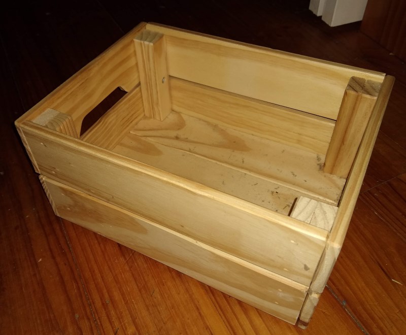

    Or, I could keep Mr Stompy simple, and build a very cheap combo amp from this Ikea box and a noisy cricket:
Name:	future combo amp.jpg
    And yes, I tested that box as a stomp. It's much too high for comfort.

    Those dimensions are not an issue, JD. There’s a couple of options for it, I’ve a couple of blanks that could be hollowed out to suit, or a spec box built to house what you want.
    are you going to stick with the flat format or did you want to wedge it a bit for ease of use?

    1,181
    A bit of taper might be nice. Even 1 cm difference would work, so 50mm at the back and 40mm at the front.
    I had no specific plans for how the box would be constructed, beyond "box, with lid screwed on the bottom". I think in my mind it was sort of a wooden pedal enclosure. But I know almost nothing about building things out of wood, so please suggest whatever you think might work.
