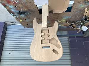

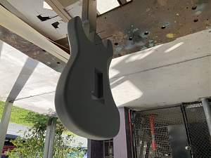

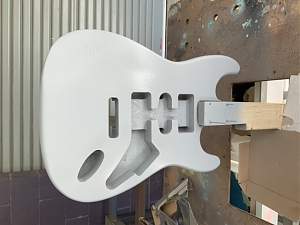

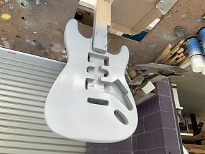

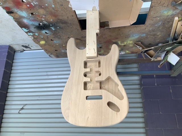

    Latest update,
    Built a guitar holder with a piece of stud pine and an inanimate carbon rod. =P
    Put some alli rod through the neck clamp holes and into the jig.
    Hit the guitar with 3 passes of SCA Primer Filler, with the intention of sanding it back with dry sand paper to expose high and low areas in the ash timber. From pics, can already see spots where more sanding is needed. Mainly around the edges, as a better job is needed there.

    I am glad you used an inanimate carbon rod, those animate ones are a world of trouble. Mine wouldn't stay still while I spray, so my guitar holder is a length of chain hanging from a wooden beam in the shed ceiling. A d-bolt lets me adjust the length. The guitar hangs down into my makeshift spray booth (a large cardboard box).

  9. #27
    Good work Kirk!
    But the perspectives of those photos are just doing my head in! Please... no more upside down left side right pics!

    You do it on purpose to confuse any paint runs. They don't know which way to go, so stay where they are.
