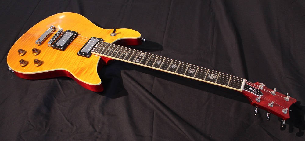

    This is my PRS-1TS which I used those dyes on:

  8. #28
    Apr 2020
    Brisbane
    28
    You won't be able to mix those two products.
    The Angelus Leather Dye is alcohol-based (and work really well btw) the Feast Watson is an oil-based stain.
    Two different solvents and two different pigments used in each of them. They won't mix.
    I have used the Angelus alcohol-based dyes and mixed them with powdered aniline dye which is first dissolved in alcohol with no problems. The Angelus dyes are essentially the same thing but in a liquid form instead of a powder.
Name:	MRC-DC 1 1k x 462.jpg
