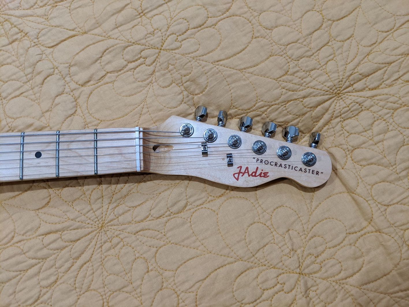

    Apr 2020
    Brisbane, QLD, Australia.
    21
    Here she is! Almost finished, just waiting on some extra shielding tape. Surprised how quickly this came together.
    - Upgraded to Gotoh SG381 Tuners, definitely worth it. Holding tune well, and intonation is good.
    - Gotoh S21 solid steel saddles
    - Pickups TBA!
    - Working on a headstock decal. Will be called "Procrasticaster" as I built this instead of doing my PhD work hahah! Oops.
    Will post more photos later of the back, which I think turned out beautifully!
    P.s. ignore that the strings are wound the wrong way, I was half asleep haha! Have a set of elixirs on the way so will fix it when they arrive. Unfortunately means my string trees will be in the wrong spot but not the end of the world!
  9. #29
    Apr 2020
    21
    Finally finished. Ended up getting Wilde (Bill Lawrence) Alnico Microcoils. They took forever to get here, but boy were they worth the wait!!
