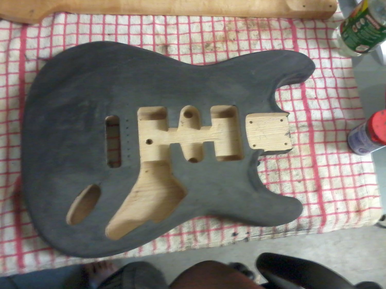

    Update:
    I decided to go ahead and apply the Ebony Timbermate to the Strat body, I managed to dilute the TM to a nice thick creamy consistency, because I couldn't find a Squeegee, or Spatula, I put one of my spare nitrile gloves on and used my fingers to spread the TM over the body of the guitar, all that's left to do now is wait till the TM has dried and then sand it off, hopefully I got enough of it in the grain to make it pop, here's a pic of the body covered in the Ebony Timbermate:

    Hi Doc, Beware of drippage down the sides! I found this with the EXA body, if you are a little too fluid on the tm then it can leave runs, and even if you attend to them right away, you will get a run mark.
    I managed to get around this by sanding back and re-coating with a thin TM solution which effectively filled in around the run marks, leaving it even, although when i first saw them, there was bad words, so many bad words.
  10. #290
    Cheers, I think I must have gotten lucky with the consistency of the TM since I didn't get any runs or drips that I could notice.
