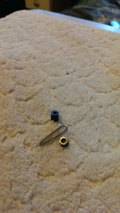

    ok....heres the bits ive got left over... any ideas anyone??

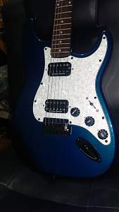

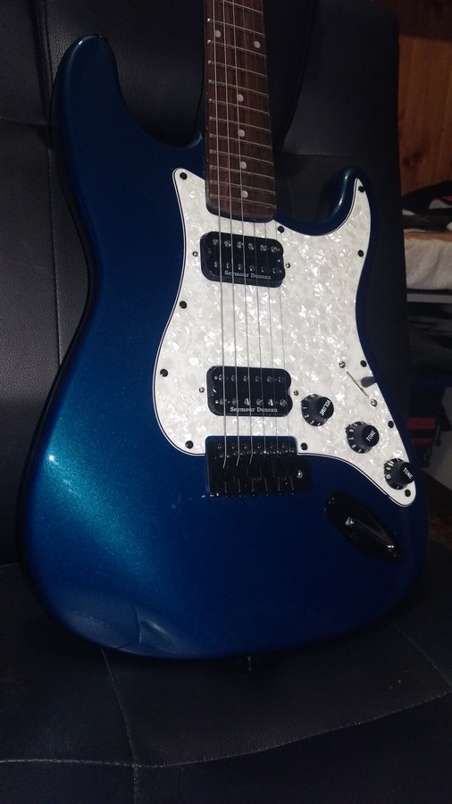

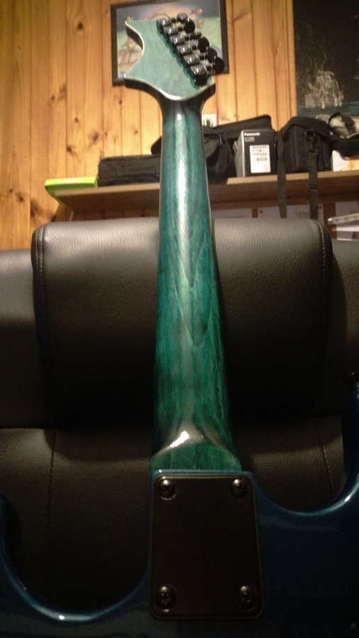

    Completely finished
    Its all done. tonight i took the strings off, pulled off the pickguard, upgraded the caps to better ones, removed the nut again, shaved off about 1ml to fix buzzing on low E string, put it all back together again. Upped the hight of the pickups, then lowered the high E pole, upped all the middle poles and lowered the low E pole.
    Tuned the strings, set intonation and plugged it in.
    WOW, sounds better than my factory strat, the pups are the bees knees. Balanced highs and lows throughout, both tone pots work great now and no drone from lower strings.
    A HUGE THANKS TO ALL THE GUYS THAT HELPED ME EVEN IF IT WAS A SMALL CONTRIBUTION. THIS SITE ROCKS...THANKS AGAIN GUYS!!!!

    Looks like the piece of solder that comes with the kit, and the spacers for the string trees.
    Right, thanks
