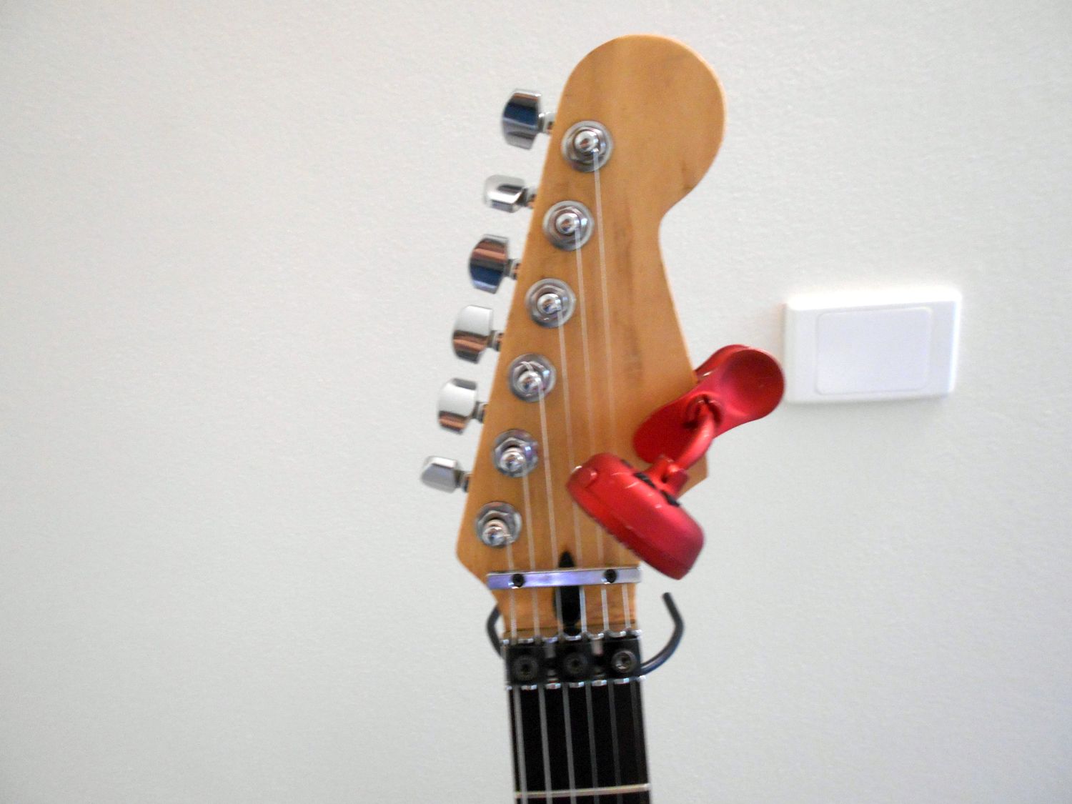

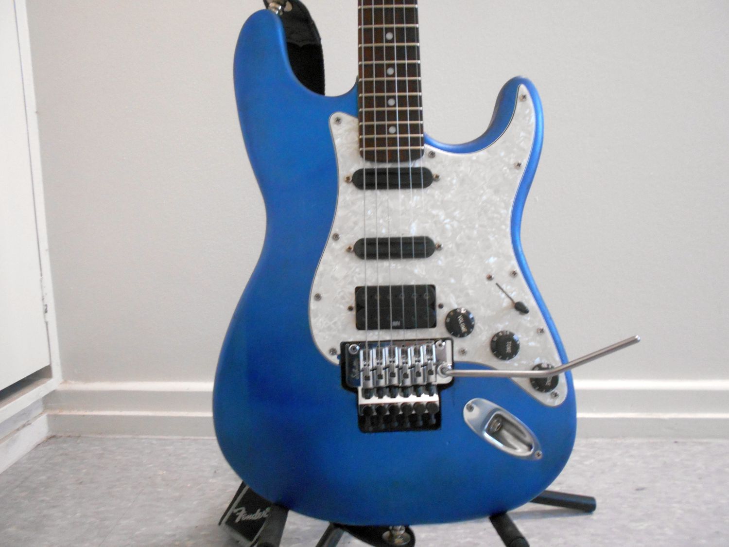

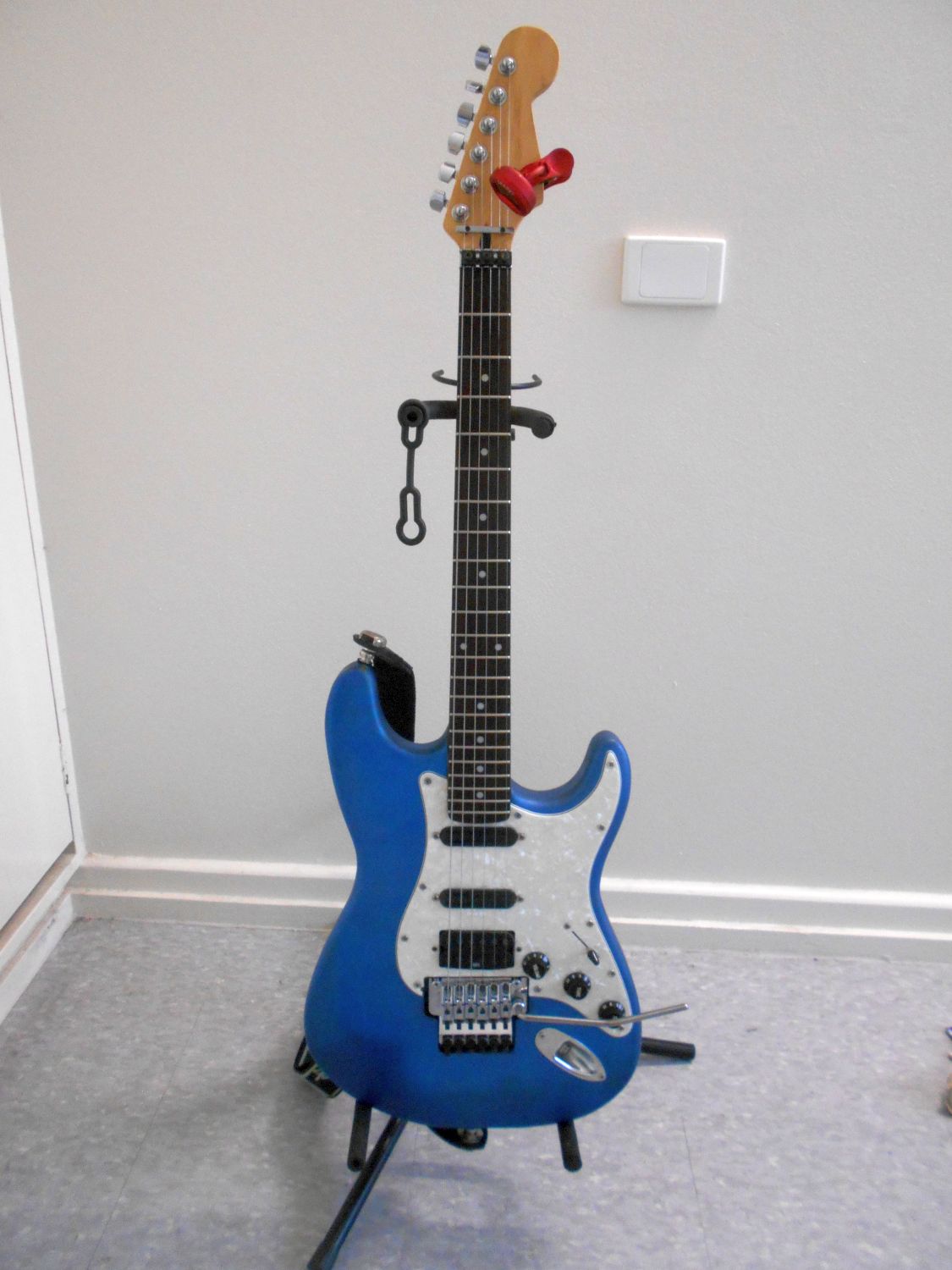

    Here we go, some new pics of the Hot Rod strat, she's all set up with a set of DAddario 42-09 gauge strings:
    I just tried doing some dive-bombs, pull-ups, and pinch-harmonics as well as some general whammy-abuse and it still stays in tune.

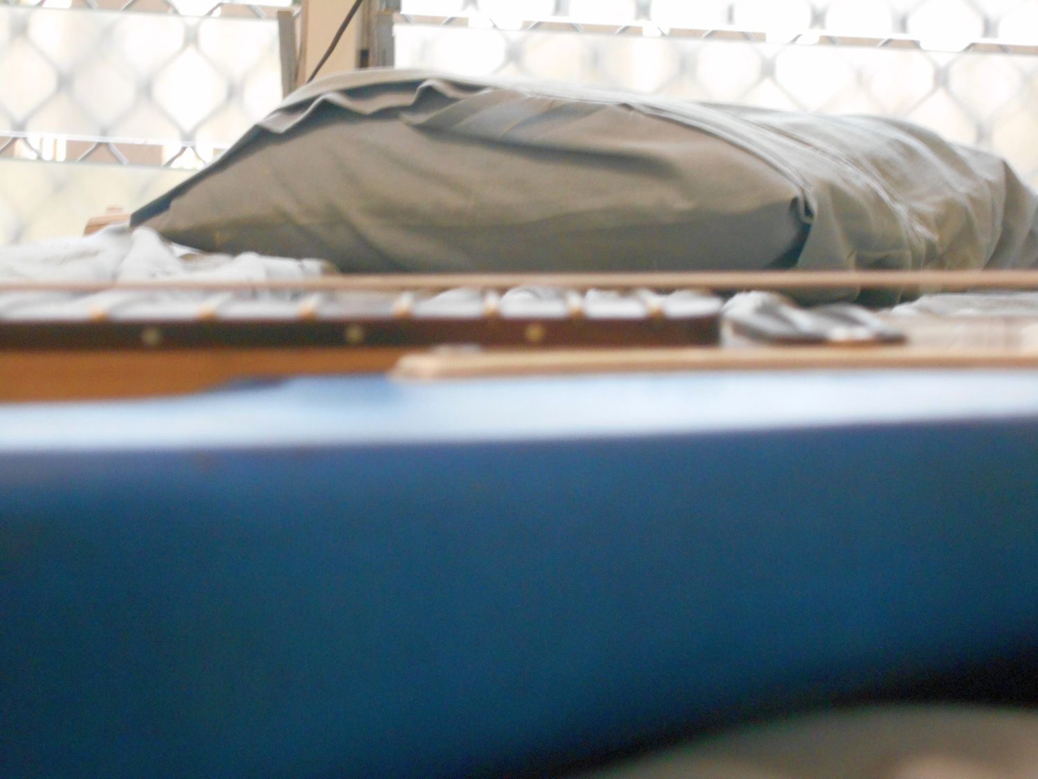

    Check out how low I managed to get the action at the 17th fret in the bottom pic, it's about 2mm.

    Here's the current pickup-configuration of my Hot Rod strat:
    Neck:
    Black Kent Armstrong Dual Blade single-coil sized Humbucker.
    Middle:
    Bridge:
    Ibanez Infinity 4 full-sized Humbucker.
    Note: All three of the pickups are passive types.
