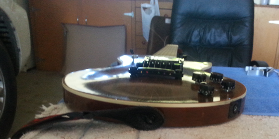

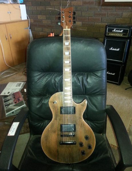

    Anyway everyone....here is an update.
  10. #240
    Nice & shiny. How does it sound through the micro Marshall Stack?
