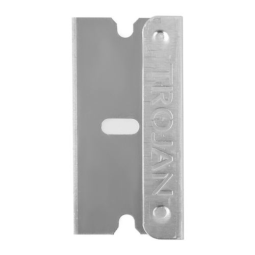

    I have been known to do things that are stupid, like using the razor blade to very carefully cut off the top of a big drip to get it to cure faster. I won't say this has never worked, but I will say it can go either way.

    With regard to the razor blade. I was definitely referring to the "American" type. We have what you call the "Indian" type too...but only for shaving. I would worry that it might be too flimsy for this usage. If you can't find the American-type razor blade how about a utility knife blade?

    thats not stupid at all I use the same methods but I use the other type of blade but I will put 3 or 4 coats over a drip or run 1st, yes even I have had dips or runs with 2k clear but only on guitar body never on a car even when I was an apprentice, I do scrape it down a little I will read his whole thread as he's not doing it correctly by the look of the results , @Drashkum find my build post as I have put a lot of info in it, I don't agree with you (@fender3x) I always use orbital sanders on most of my builds especially Strats and Tellies even when I wet sand but you need a soft pad for it so you don't go through the paint and you need more coats but I've done so many guitars over the years
