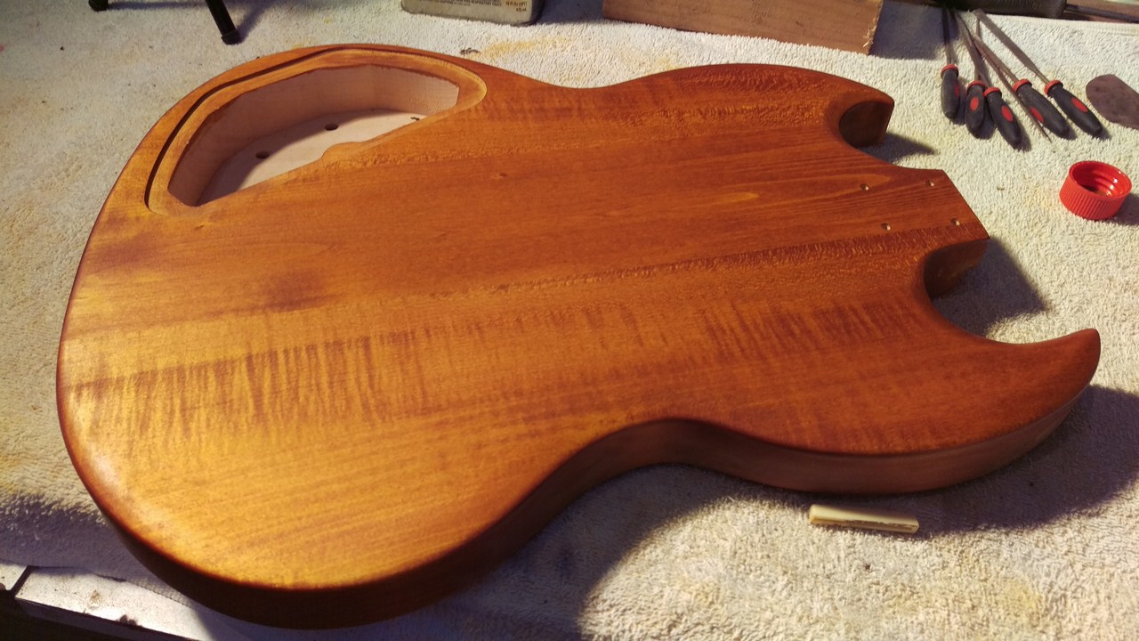

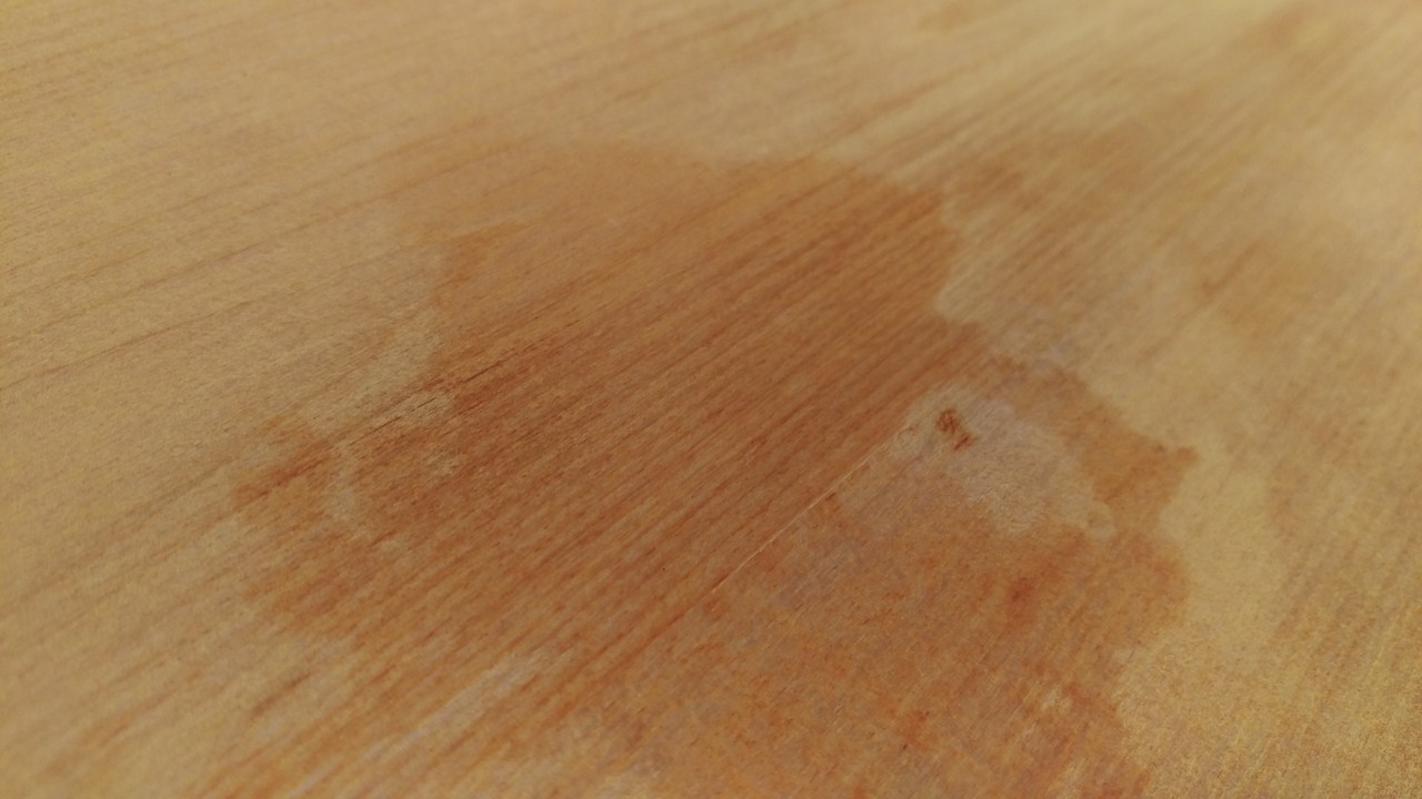

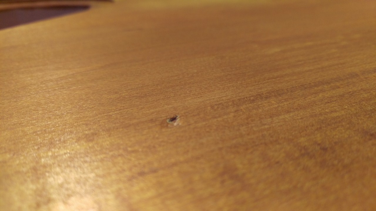

    Had a spare weekend so decided to some more work on the SG.
    When i glued the veneer on the the top of the guitar there was a bit of gravel that got caught between the bench and the back of the guitar, leaving a considerable dent!
Name:	IMAG2840 (Copy).jpg

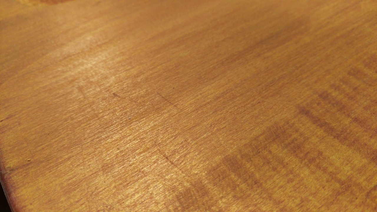

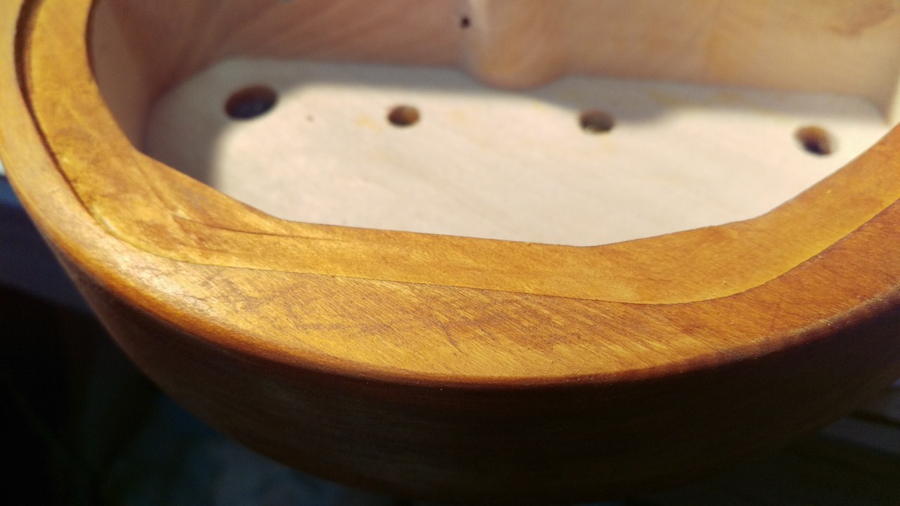

    So after some considerable youtube research i decided to have a crack at it. I had to sand and redo the stain on the back again anyway as the stain brought out some considerable scratches that i had been too slack to sand out..
Name:	IMAG2841 (Copy).jpg
ID:	15020 Click image for larger version.
Name:	IMAG2842 (Copy).jpg
Name:	IMAG2843 (Copy).jpg
ID:	15022 Click image for larger version.
Name:	IMAG2844 (Copy).jpg

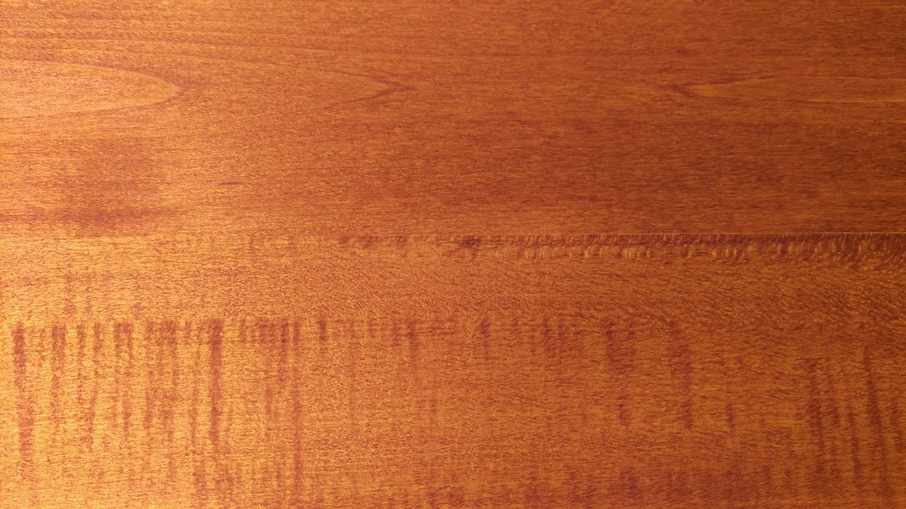

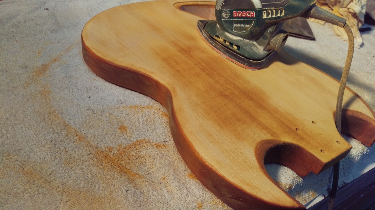

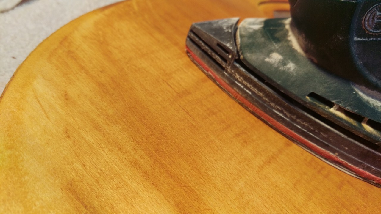

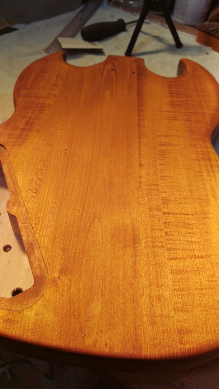

    Youtube said that if you use a wet cloth and a soldering iron the wood will swell, esp if it is bare, so i power sanded out all the scratches and went over it with 240 and then 400 grit
Name:	IMAG2845 (Copy).jpg
ID:	15024 Click image for larger version.
Name:	IMAG2846 (Copy).jpg

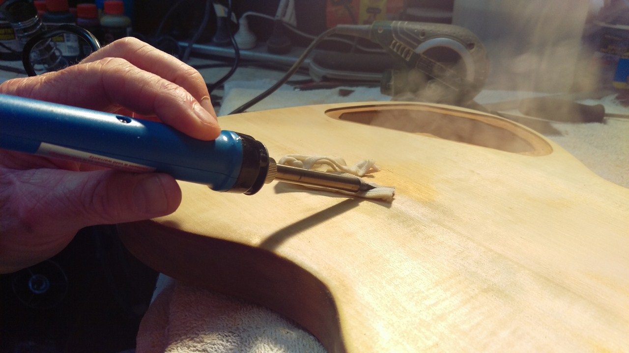

    and then used the wet rag and soldering iron technique
Name:	IMAG2847 (Copy).jpg
ID:	15026 Click image for larger version.
Name:	IMAG2849 (Copy).jpg

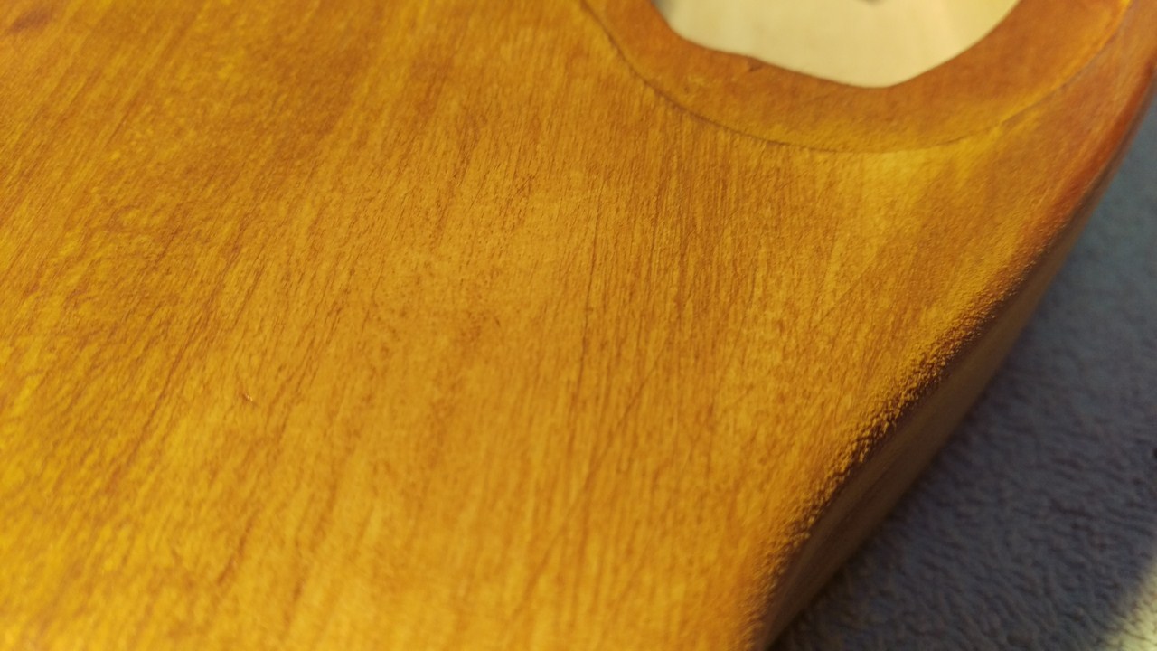

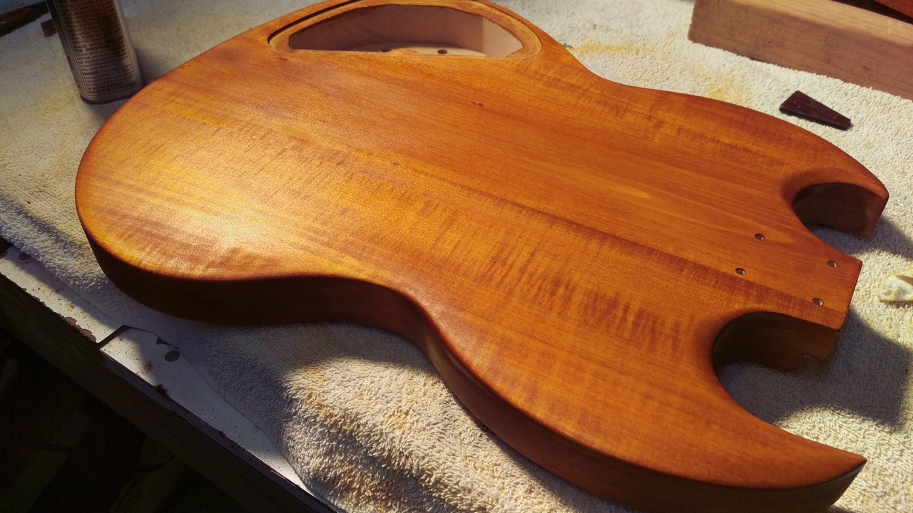

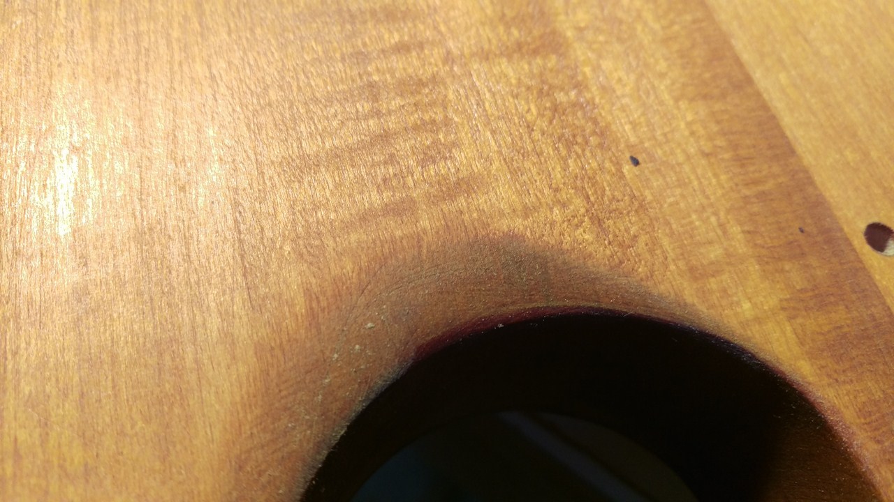

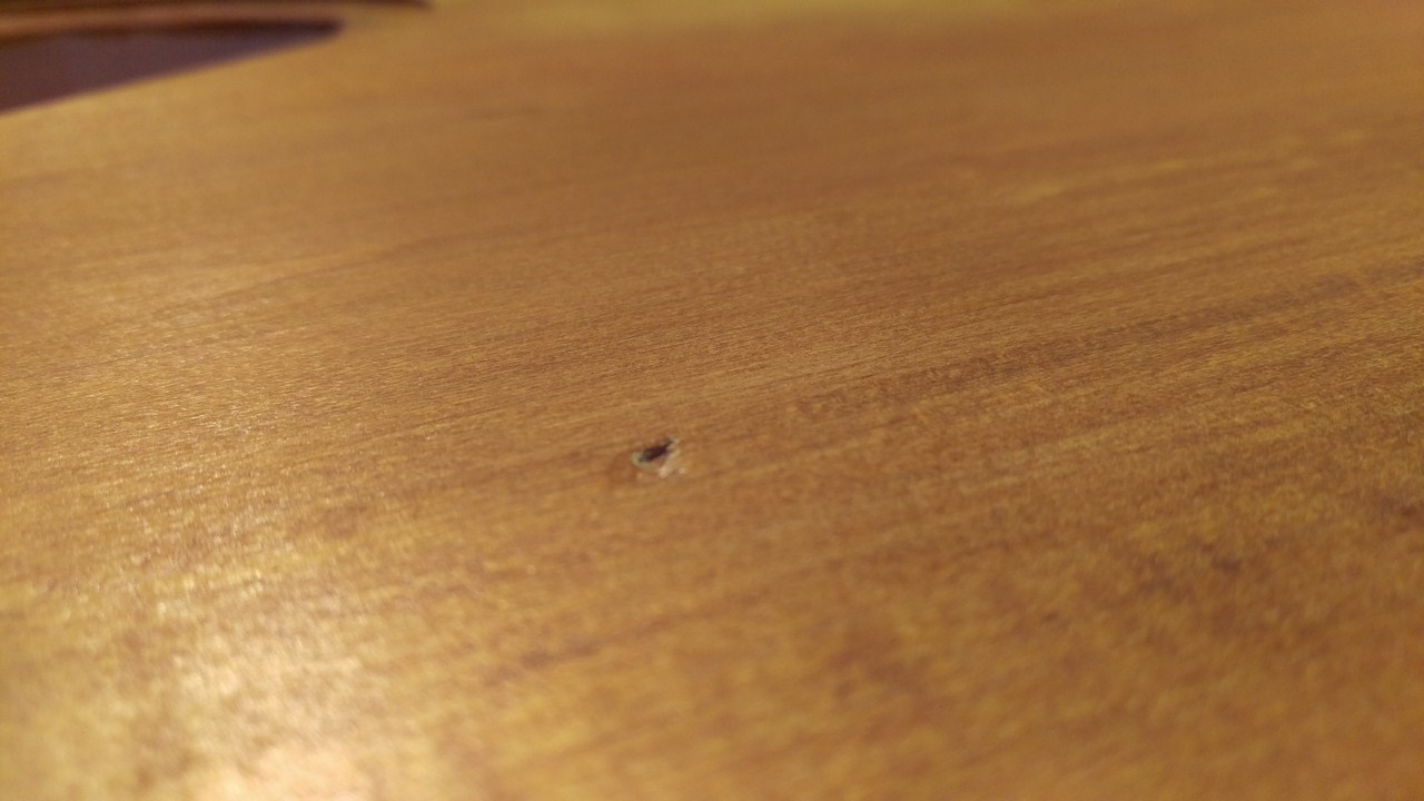

    As you can see it turned out a treat.
    I put on a coat of stain and you could hardly see it.
Name:	IMAG2850 (Copy).jpg
ID:	15028 Click image for larger version.
Name:	IMAG2851 (Copy).jpg
ID:	15029 Click image for larger version.
Name:	IMAG2852 (Copy).jpg
    ( On the pic above the dent is in the exact center ) 2 coats of stain and one coat of wipe on poly, very happy with the results.
Name:	IMAG2854 (Copy).jpg
  5. #215
    Good save and looks terrific.
  6. #216
    Jun 2016
    Mount Gambier Australia
    1,171
    Thanks heaps mate, never thought it would turn out so good.

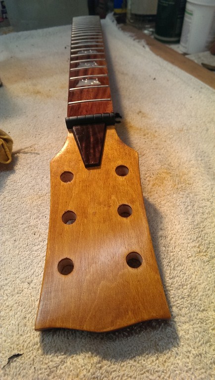

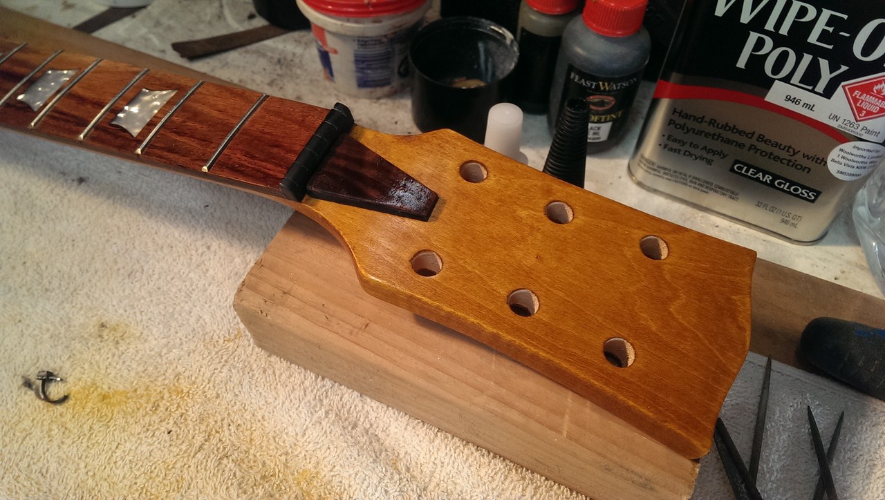

    Next...... I didnt like the plastic trussrod cover so i glued a veneer of the walnut onto it, shaped it a gave it a few coats of poly.
    Looks good with the new graphite nut.
Name:	IMAG2866 (Copy).jpg
ID:	15047 Click image for larger version.
Name:	IMAG2869 (Copy).jpg
  9. #219
    Another good idea. On both my Explorers I found rosewood truss rod covers on eBay and used them instead of the daggy standard plastic one that comes with each kit.
  10. #220
    Jun 2016
    1,171
    They would look sweet esp if you have a rosewood fretboard
Page 22 of 45 FirstFirst ... 12 20 21 22 23 24 32 ... LastLast
