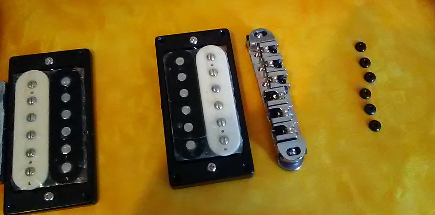

    547
    hey guys did the string ferrules top and bottom and the bridge it was nerve racking as took he the whole day before i was confidence to drill it the 5mm top ferrules i used a 3/16 drill bit which was 4.72mm and the 6.5mm bottom ferrules used a 1/4 drill bit which was 6.2mm both fitted good Thanx goes to Simon B and Sonic for the advice which i would have buggered it up with out there input the bridge inserts where 6mm so just did a 5.5mm drill
    and Simon who has become the forums tech adviser and go to lol

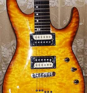

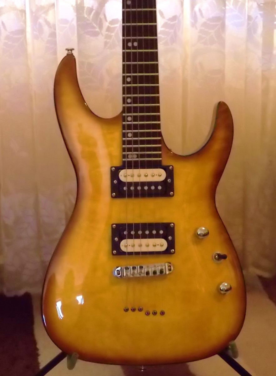

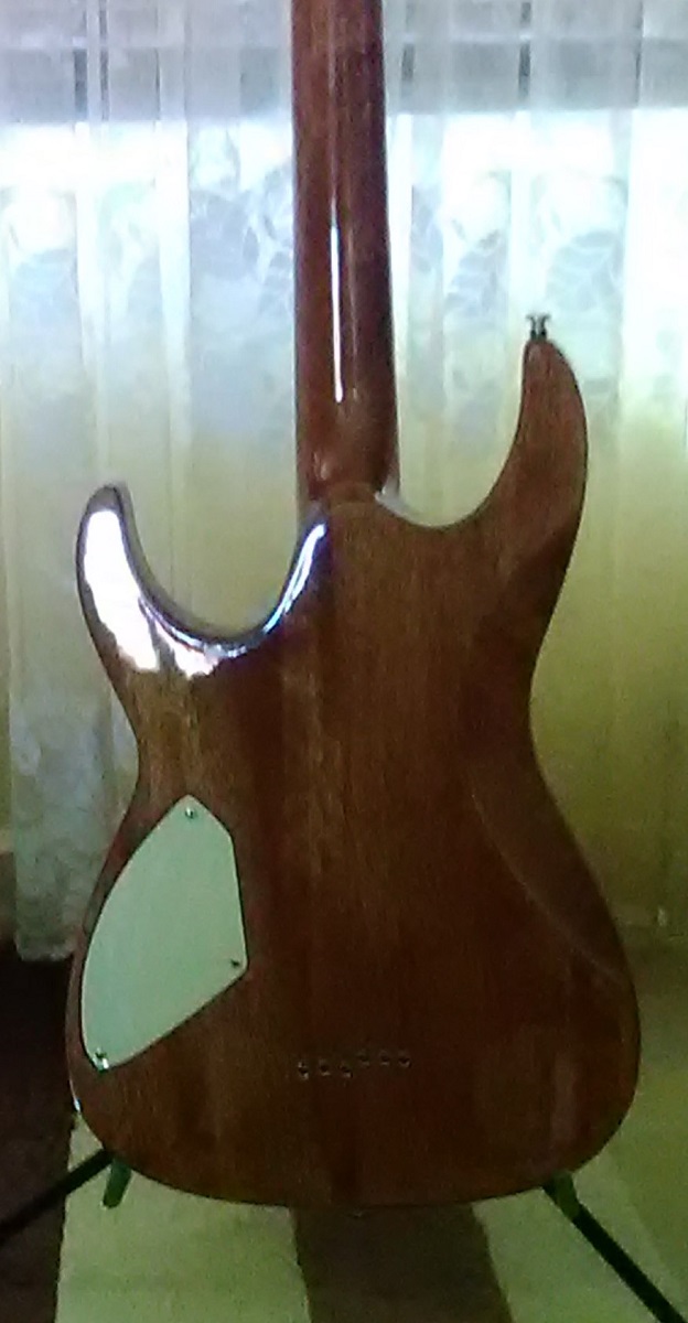

    ok guys finally finished had some issues in the set up i had to replace 3 frets as had a number of dead notes over the neck as not set right before it was glued in the nut was glued crooked which i replaced any way. It would be the worse neck i think i have had, i would not recommend this kit to any one who hasn't done a few kits, 1st problem was the binding looks like it was put on before the quilt veneer so the veneer sat up 1mm higher than the binding and in places over the binding so sanding it down with out going through the veneer had its problems also some of the binding was put on by Edward scissorhand pieces missing or cut wrong then you haft to drill the holes for the bridge and tail piece easy enough if you know what you're doing which i didn't lol. Once you get all that sorted its a beautiful guitar i really haven't be able to take a pic to show how nice it looks finished, definitely in my top 3 guitars the 2 piece mahogany body was lovey bit of wood and the ebony fret board i really liked I will be doing another of them the experienced guitar builder is required to finish this kit
    here it is finished and the last pic is the best pic's i could take to show the quilt used rit yellow dye and brown and lacquer over the top

  5. #205
    Looks superb, Phroz. Yes, my GPR-1 is from the same factory and it left a lot to be desired compared to the other kits.
  6. #206
    It's come together pretty well all told. Quilt looks great in the last shot.
  7. #207
    That is HOT phrozin. Great finish as always.
  8. #208
    Absolutely stunning.
