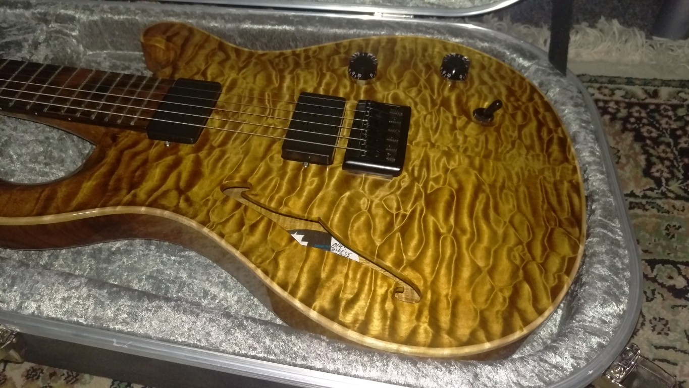

    Yea i got the idea from my luthier bro in law, he seals all his fretboards and they look awesome, heres some pics
    Name:  IMAG2625 (Medium).jpg
Size:  12.1 KB Click image for larger version.
Name:	IMAG2351 (Medium).jpg
ID:	14826 Click image for larger version.
Name:	IMAG2352 (Medium).jpg
    And this site is all about being unique and different, so......im willing to give it a go

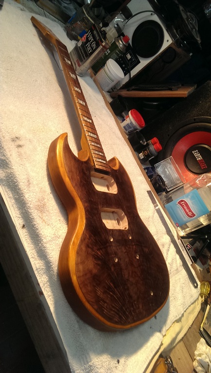

  8. #208
    Jun 2016
    Mount Gambier Australia
    1,171

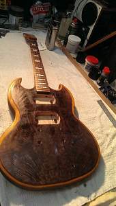

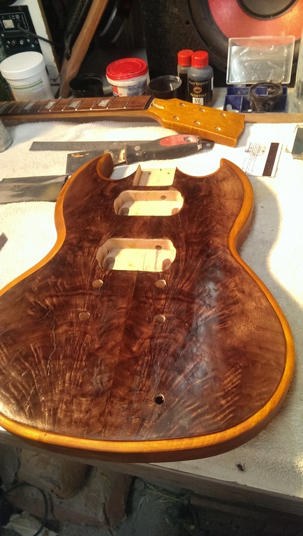

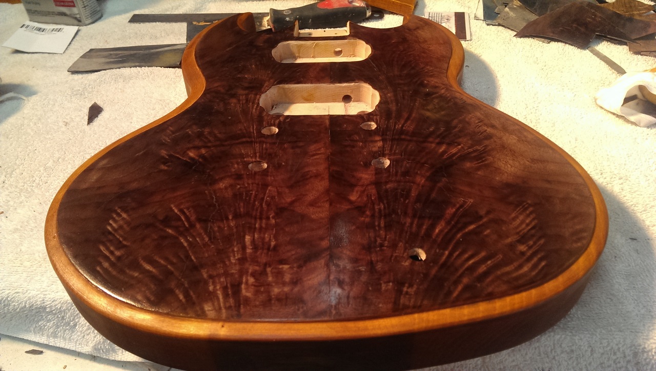

    Double filled all the veneer cracks with the black timbermate and gave it a good sand, came up well.
    Gave the neck only 2 thin coats of wipe on poly, a light sand with 1,000 grit and one more thin coat. It looks good, matt finish but it has highlighted the grain without a heavy buildup of poly.
    Gave the veneer a coat of wipe on ploly
Name:	IMAG2855 (Copy).jpg
ID:	14864 Click image for larger version.
Name:	IMAG2856 (Copy).jpg
ID:	14865 Click image for larger version.
Name:	IMAG2857 (Copy).jpg
    and fitted the neck for some pics....
Name:	IMAG2858 (Copy).jpg
ID:	14867 Click image for larger version.
Name:	IMAG2859 (Copy).jpg
  9. #209
    it's coming up well, great looking SG
  10. #210

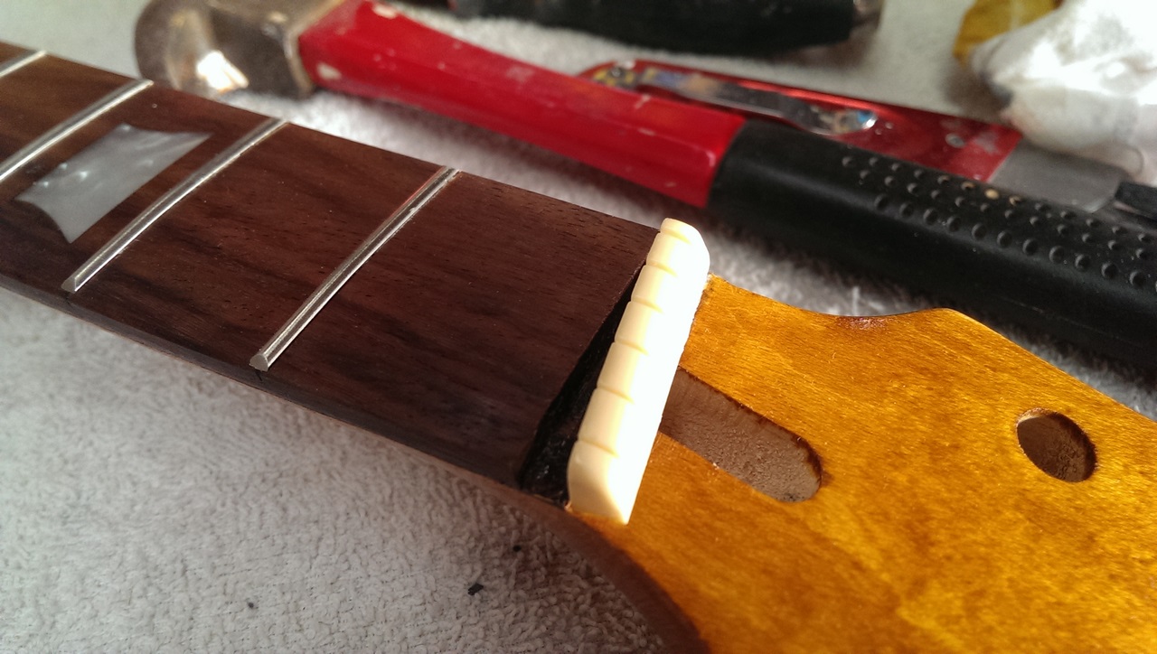

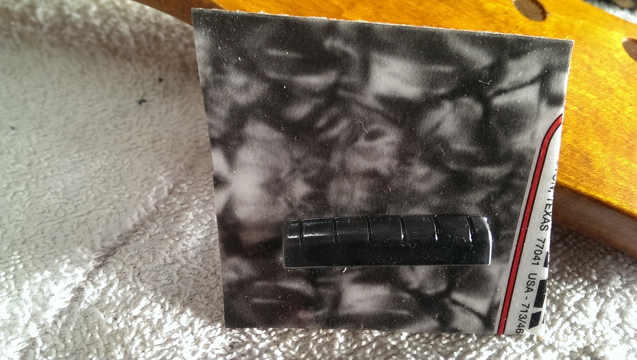

    Ordered a Graph Tech TUSQ XL Guitar Nut and it came today
Name:	IMAG2842 (Copy).jpg

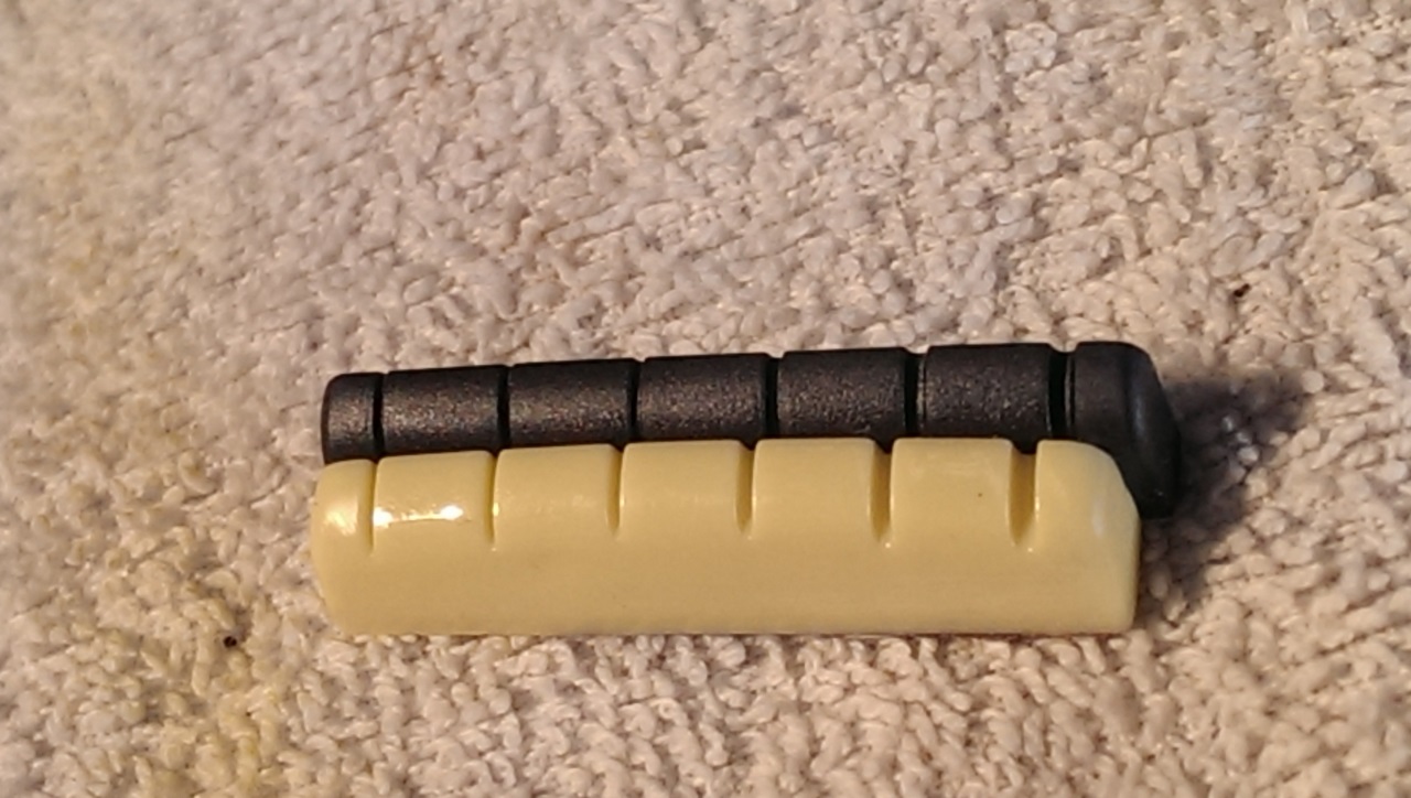

    needs some work to fit but should be ok, its a bit thin but the custom truss rod cover should butt up to it.
Name:	IMAG2843 (Copy).jpg
ID:	14870 Click image for larger version.
Name:	IMAG2848 (Copy).jpg
