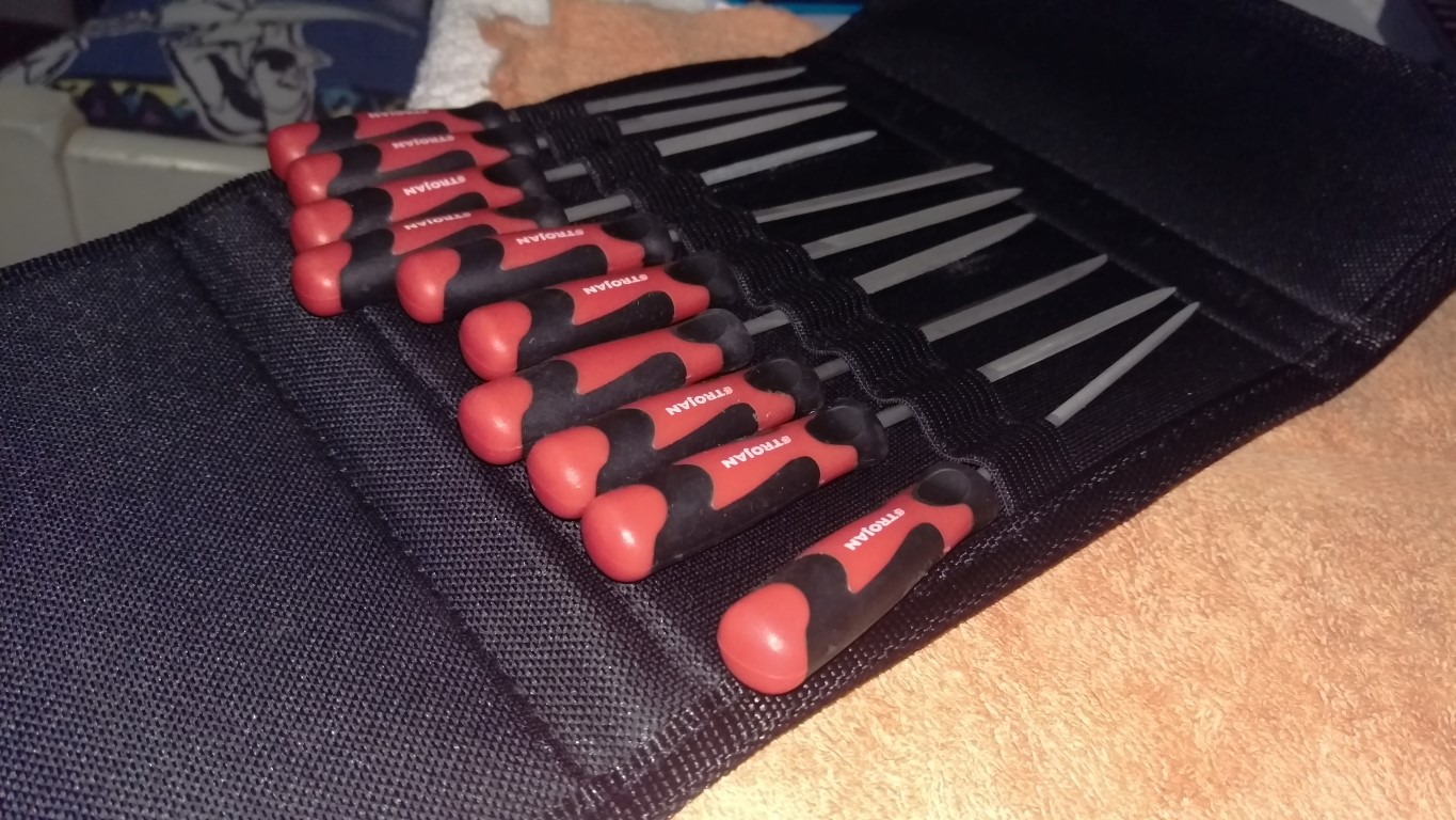

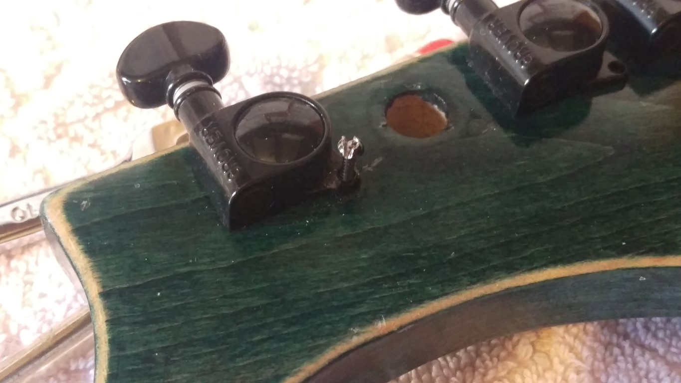

    OOPPSS... first major booboo. Didnt predrill the hole deep enough for the tuner screw and managed to burr over the head of the screw so it wasnt all the way in but couldnt get it out. Went and bought a set of needle files and cut a slight but deep groove across the head of the screw and with a normal screwdriver managed to slowly screw it back out. WHEW.

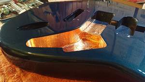

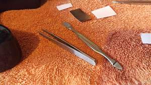

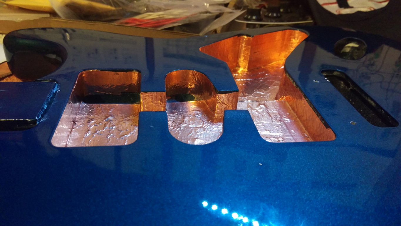

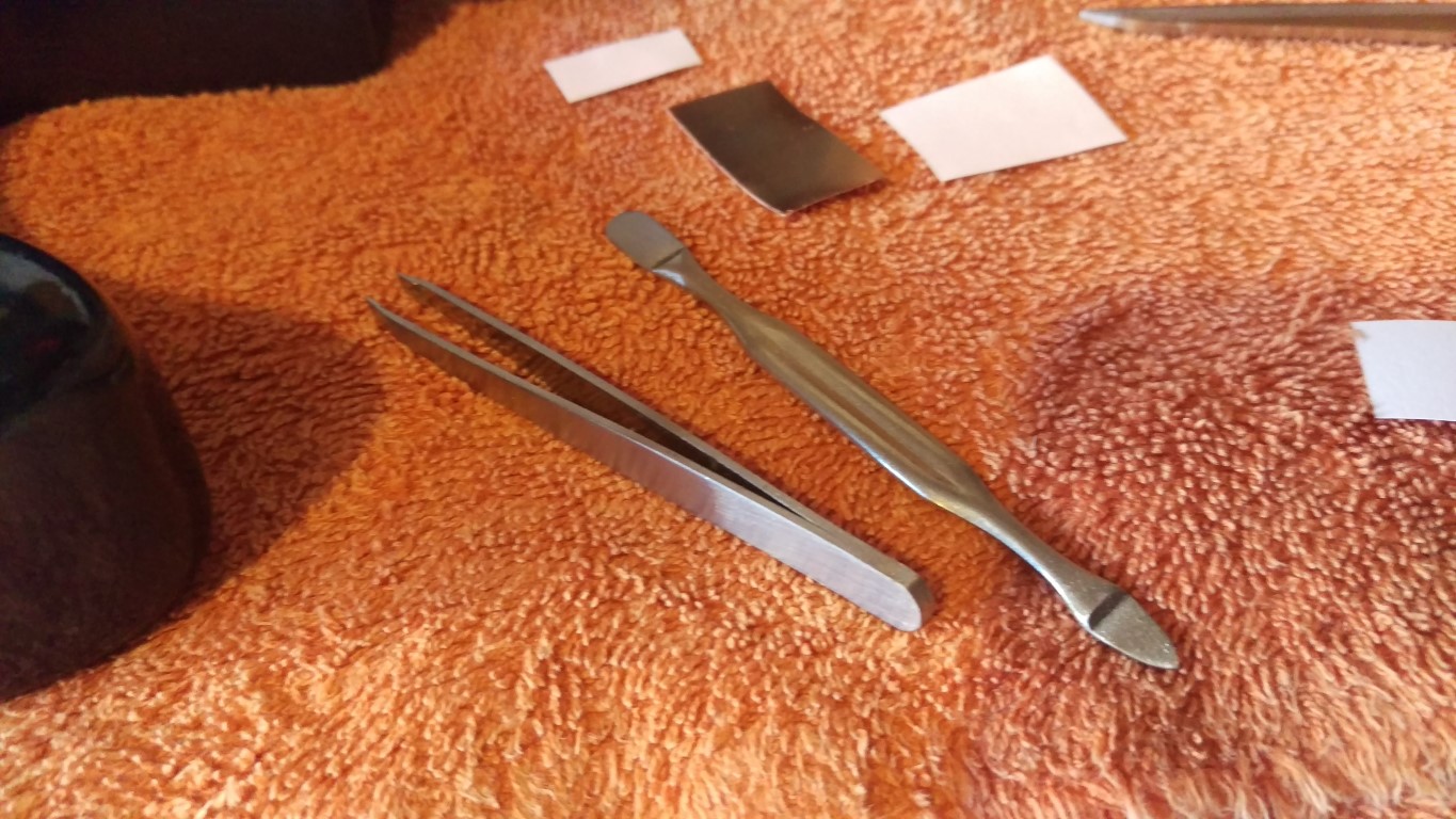

    Next step.... copper shielded the pickup cavity. (Note to self......dont cut too big a piece of foil as it tends to rapidly fold in on itself!)
    So learning the hard way i cut myself small bits of foil just to be safe. Nicked the wifes manicure set to use tweezers and some other weird looking device, but they worked as the stuff kept sticking to my fingers

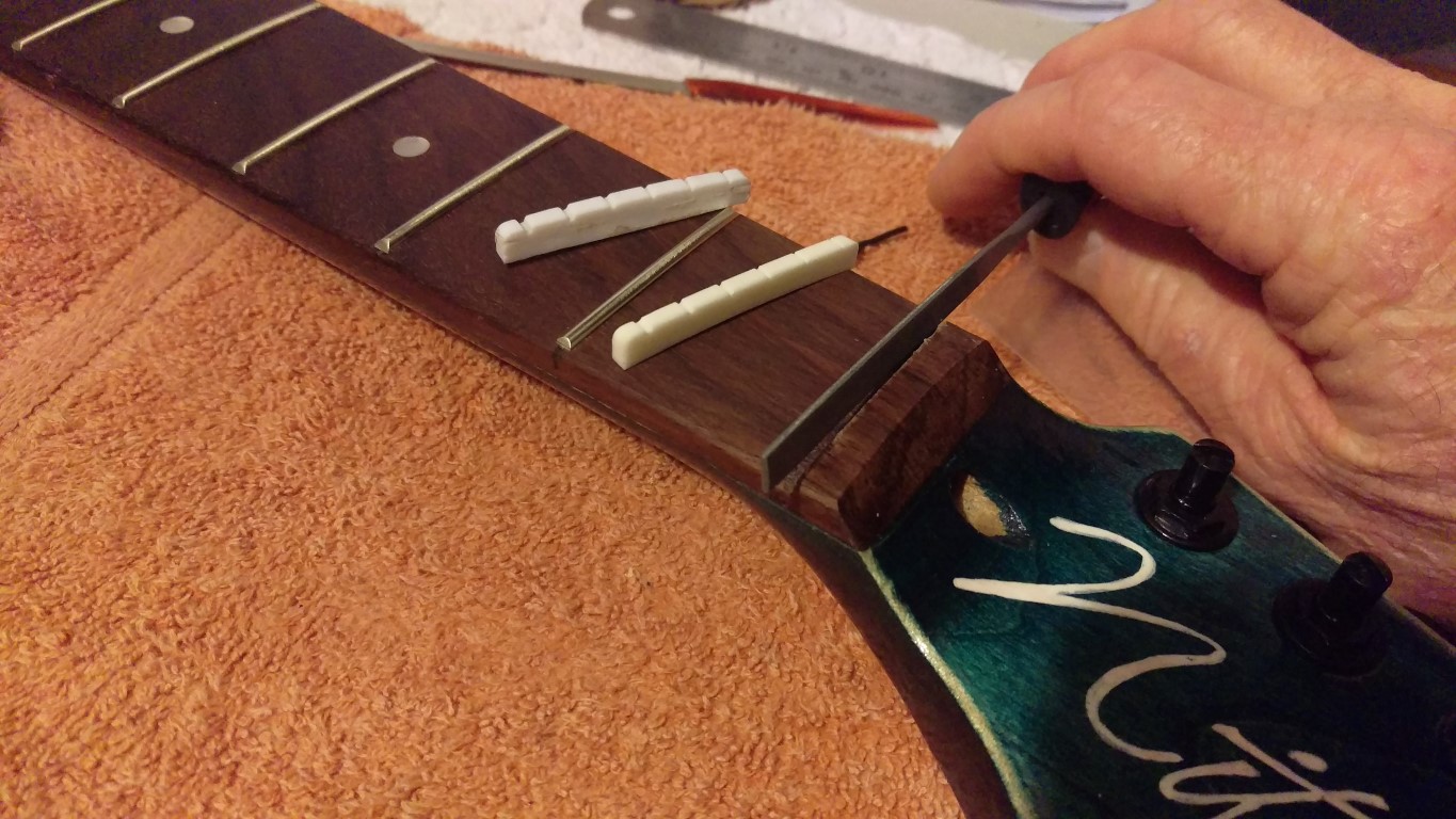

    Im doing well tonight...next i replaced the plastic nut for a bone one. It slipped in like a glove, glued it in with a couple of drops of LokTite.

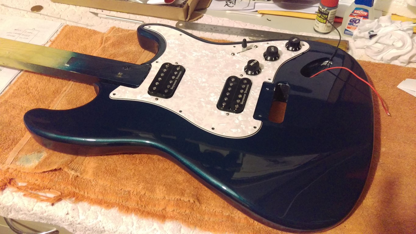

    Last thing to do, check to see if pickguard fits....YAY all is well, perfect fit.
