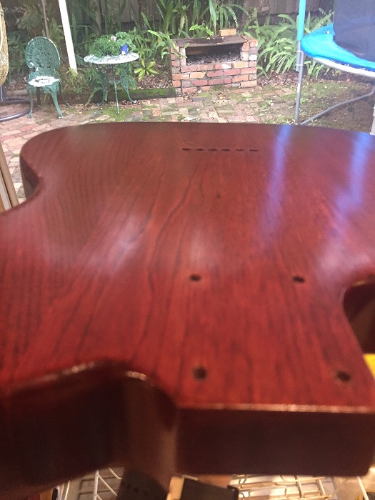

    No there was no colour change with the DT final coat.
    Reckon I got the knack of this Dingo tone final coat thingy.
    So my updated technique works like a charm. If you wanted a satin/low gloss finish, you wouldn't even need to sand back or polish!
    Laid another thin coat down last night, its dry, not cured. Given that it was pissing rain, shows that even if its pissing down rain and cold, the technique prevails.
    Sorry pics slightly out of focus.

    looks unreal Andy you have passed the Dingotone test with flying colours
    Must be close to wiring and assembly ?
    Love you still got a wood fired bbq in the background, can't beat them haha
    Lol yep 70's house and inherited with that house. lol
    Just got to wait the 21 days or so for it to fully cure.

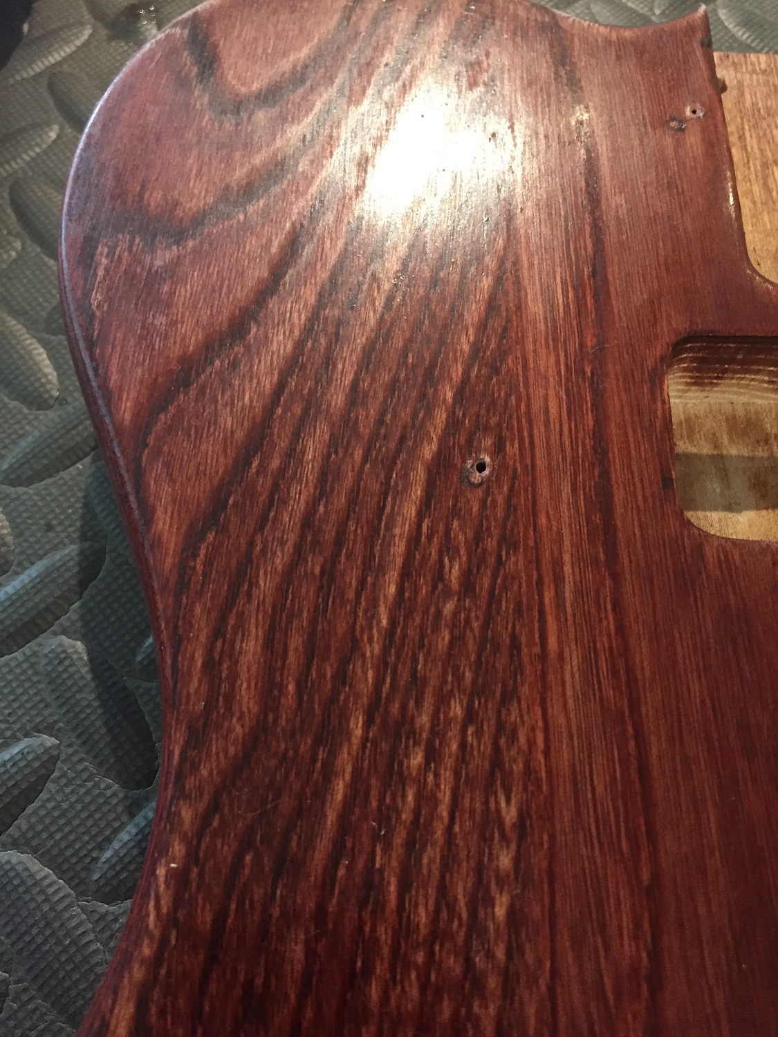

    After a about somewhere between 6 and 9 thin DT final coats and a further 21 days of curing time I managed to wet sand through the finish, the intensifier and stain coats in an attempt to level the finish. I only lightly used 600 grit and 1500 grit.
    You cannot see how bad it is in the photo but you can get the idea.
    I've had to restain it.
    I'm not going to post anymore until I get this back on track. The depths of my dissappointedness knows no bounds.
    Ouch....those coats must be thinner than TO's to go through that easy.
    I reckon starting with 1500 for wet sanding is about the right grit level as even it can take off drastic amounts of finish if not too careful. On my fretless neck conversion I started off at 2000 every time and still went through in patches.
    Must be a Tele thing as mine needs a few touch up's too and just ordered some more naughty oil from PBG less than an hour ago.
    Hope this doesn't set you back for too long.
    600 can be surprisingly bitey Thats a bummer Andy
    Back on track.....watch this space!
