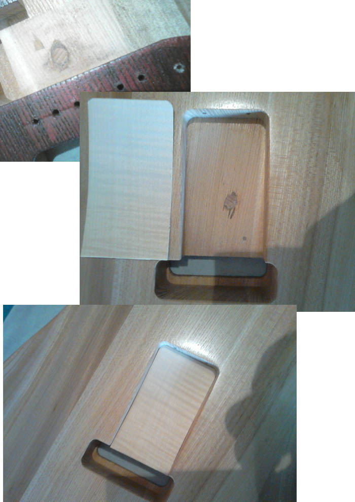

    So that's the dirty great earth hole doweled, filled and sanded. You can really see the extent of the damage and chipping caused when it was drilled.
    Got the veneer cut and all in all it's a pretty nice fit. The veneer's only just sitting in the top of the cavity in the pic as I'm not keen on pushing it all the way home until I'm ready to glue, I don't think I'd be able to get it out again without ruining it.
    I'll get a vinyl cut this arvo and etch a logo into it, should look cool hopefully.

  6. #206
    Flamed veneer for the inside of the spring cavity. Now that's how you overdo it.
    haha I reckon aye man, now to polish the tuner holes:P

    Hey Barge, you are now adding the icing to the already perfect cake so to speak! Its all these little details that give this axe a lot of depth. A true thing of beauty. The more you look, the more there is to see!
  9. #209
    Now you just need to drill the earth hole so it is hidden by the claw, solder the earth wire on the bottom of the claw (out of site) and you will have winner.
    Yup, exactly what I had in mind Fretty, great minds think alike;-)
