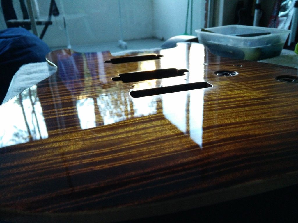

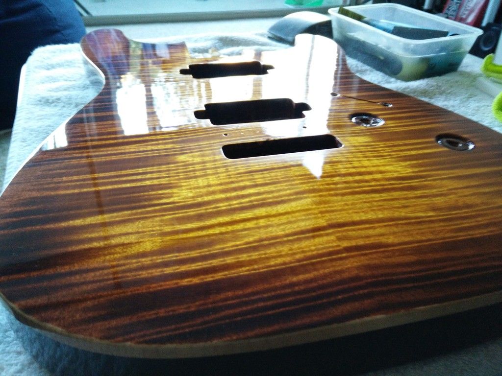

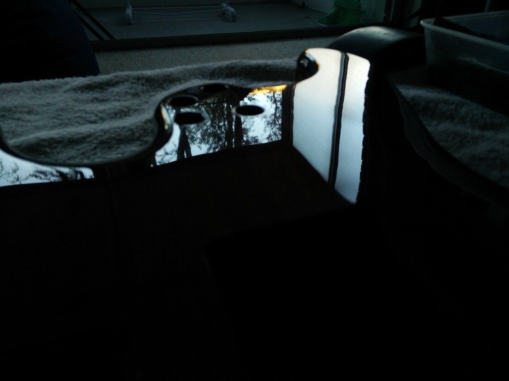

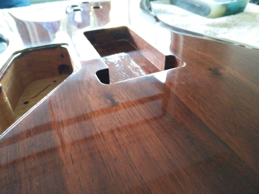

    Just spent the whole day wet sanding and buffing the body. My arms are so sore right now.
    I'll leave it for a few days before assembling. I'll do the neck tomorrow.
    The mahogany was a pain to wet sand. I probably didn't grain fill enough and I had a few shiny low spots which I couldn't level out. I could continue wet sanding and level them out but I risk sanding through and I think the latter is worse. I already accepted it isn't perfect but it's good enough for me!
    OOOOHHH SHINY! Great work dude!
