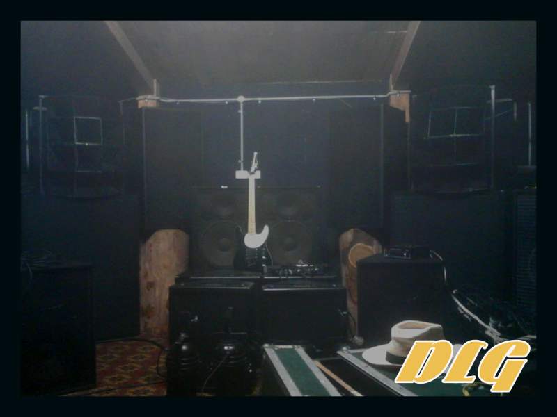

  6. #196
    Banned bargeloobs's Avatar
    Mar 2014
    1,700
    Caught in a purple haze, ready to hit the road.....
