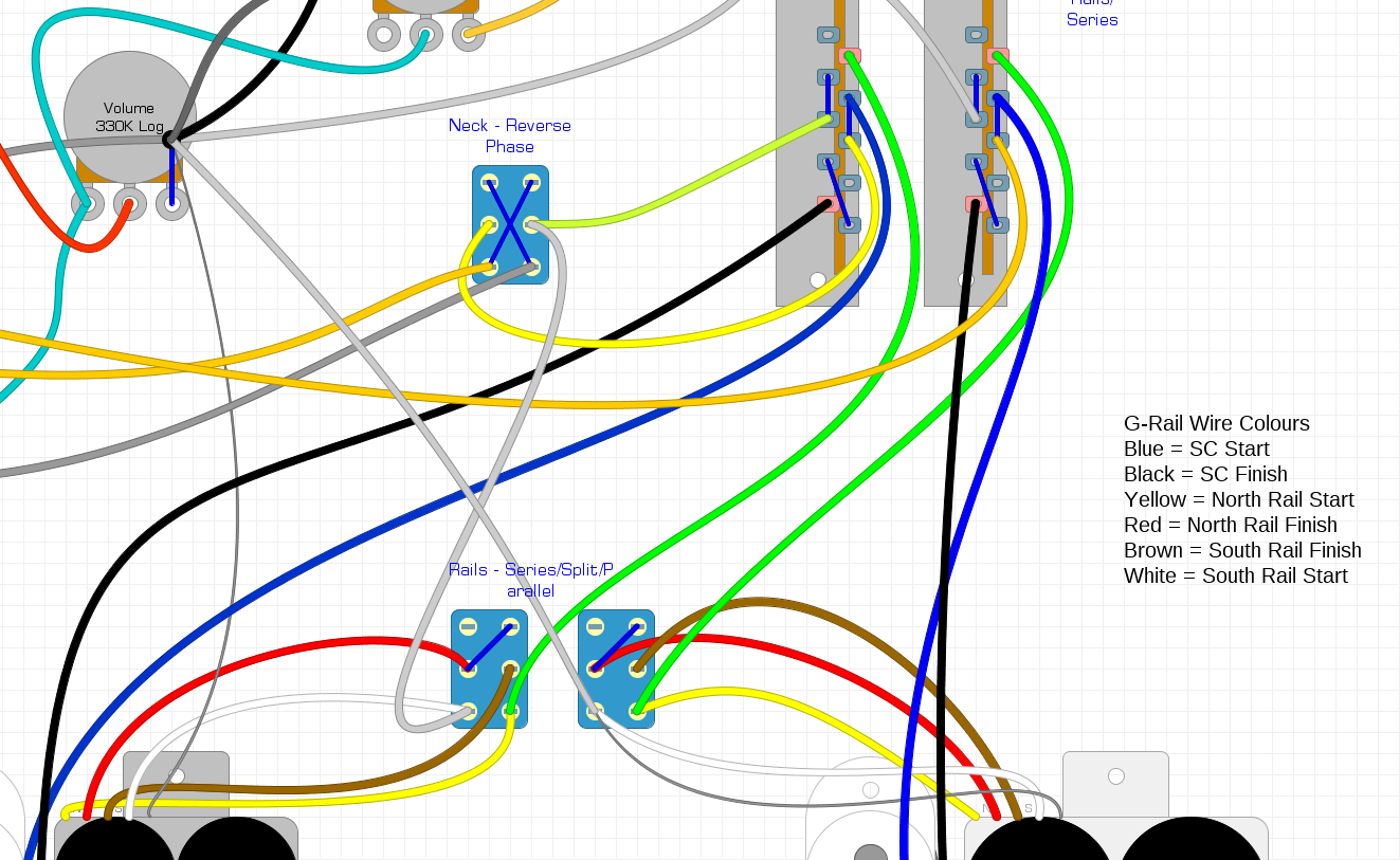

Thread: Wiring Plans Checkup
    Yep, you’ve got it. Now whichever part of the Neck pickup is selected (SC/Rail/Both) the phase switch will put it out of phase when used in combination with the Bridge pup.
  3. Liked by: B'Lark
    Awesome!! Thanks for the help with this man!!
