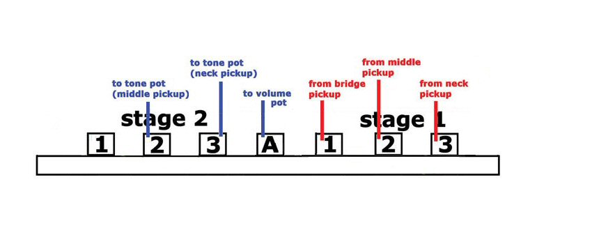

    The basic issue is that all the wiring diagrams have a 5 way switch which have a total of 8 connecting points to it. The PBG switch has inline 6 points. As I am unsure how to convert the wiring to the PBG switch I was thinking about changing out the switch to match the wiring diagram.
    The stock PBG 5-way has 7 lugs/pads, set up as 1 2 3 (4) 5 6 7, where 4 is the common lug for both sides/halves. This works fine for ‘standard’ Strat style wiring, but as it has a single shared common it can’t do much more than that on it’s own. The CRL/Grigsby type lever switches that you see in diagrams have three lugs plus a common on each side, completely separate from each other (ie. 2 ‘poles’), which allows some additional wiring options. Then there’s the ‘4 pole’ super-switches which have four separate banks of x lugs plus a common.
    To map the PBG switch to a CRL style layout, it would be like:
    .1...|..(4)
    .2...|...5
    .3...|...6
    (4)..|...7
    If you get what I mean.

    Thanks Scott,
    Very helpful. So from this I am guessing that I would need to upgrade the switch to change the wiring which is what I had thought. However, this is very helpful
    I should point out that the above mapping is only valid when the diagram you’re using has the two commons linked on the switch, ie., a wire between the two (4) lugs. If it doesn’t have that link then the poles are being used separately and you can’t map it to the PBG switch.

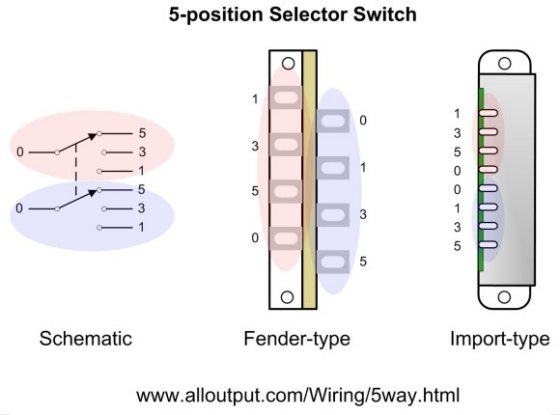

  6. #16
    Here's a handy diagram.
    I'm pretty sure you can still do the 7 sound toggle switch with the import switch. Let me check my note and get back to you tomorrow. It's late...
Name:	Import 5_way_switch.jpg
    Here's a 7 lug one:
Name:	7 Lug _5way wiring.jpg
