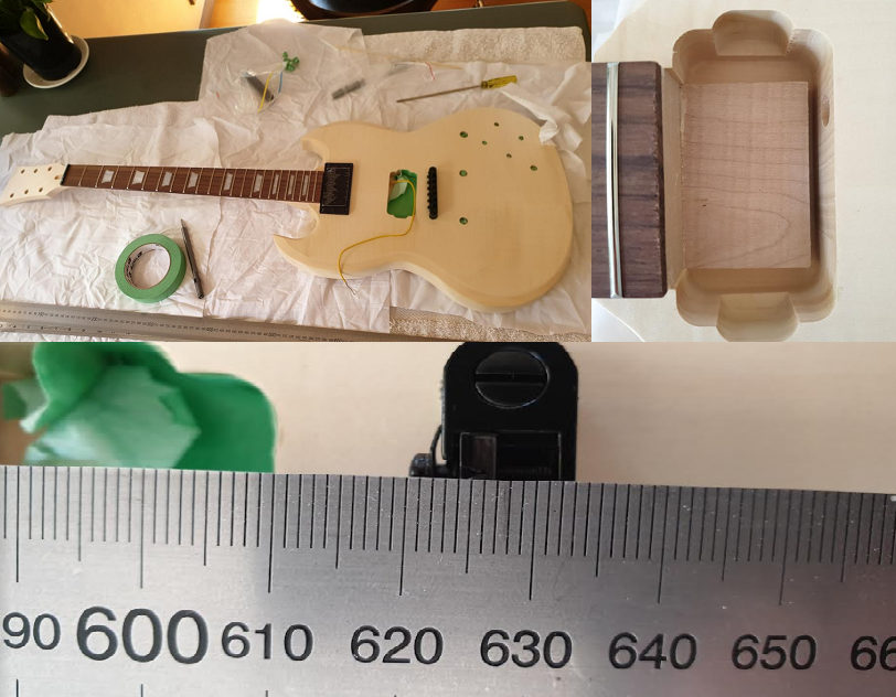

    Proceeding on, hopefully the neck doesn't end up failing when i get to the end point... hahaha *stress!*
    Been sussing the scale length, wasn't too sure as the product description for AG-1F or other similar AG series guitars doesnt have it included (i could be blind), but with the neck slotted mostly all the way in so the neck pickup fits and covers all of the pickup hole it sits close to 628. Gibson SG guitars have a 628mm scale length, so i thought going with that would be safe.
    Pic shows with the saddles all the way forward, high E string would sit at 624mm, saddle can extend back to 630mm.
    Not in the pic, but the low E sits at 626mm

    I was just presuming the scale to 24.75 based on the type of kit, but I think I'm correct.
    To verify, measure from the fretboard-side of the nut to the centre of the crown of the 12th fret. That will be your half scale distance. That x 2 is your scale length.
    So the nut to top of 12th seems to be 312mm, 2mm short of the perfect half 628mm; 314mm.
    So i assume i should plan for 624mm as my scale length, given half is 312. Instead of just following the 628mm/24.75inches.
    Sorry, I was speaking more about finding scale length in general. (if unknown)
    You'll still want to set the neck based on 628mm. Because the TOM-type bridge is slightly angled, the 628 mark will fall at the centreline of the bridge piece at the middle, pushing the low E slightly behind the line and high E slightly ahead. (clear as mud, right?)
    There is enough adjustment in the individual saddles that correct intonation (individual string length) can still be achieved. Some builders play with the numbers a little bit but 628mm is your working figure in this case. Typically .5-1mm won't make a critical difference.
    For example my PBG PRS-1TS (24.75" scale) measures out like this: nut to centre 12th fret = 313mm; nut to middle of bridge piece at centreline = 629mm. This guitar intonates perfectly (literally).
    Whilst accuracy is important in doing this stuff, nothing is ever etched in stone. We're not dealing in microns here.
    There is most always a margin of wiggle room that will still result in a fine playing instrument. At least that's my opinion.

    Thanks for clarifying that one, seems like the measurement in my original picture measuring over the bridge is getting there. Will tripple, quadruple check those measurements before i continue with working the wood. Bit short on e, bit long on E, makes sense. Ive been measuring the length at the high e. I appreciate the guidance mate. Thank you very much.

    Double checked the scale length, the point i marked and initially had it in my prior post was spot on.

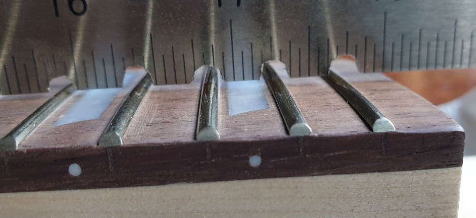

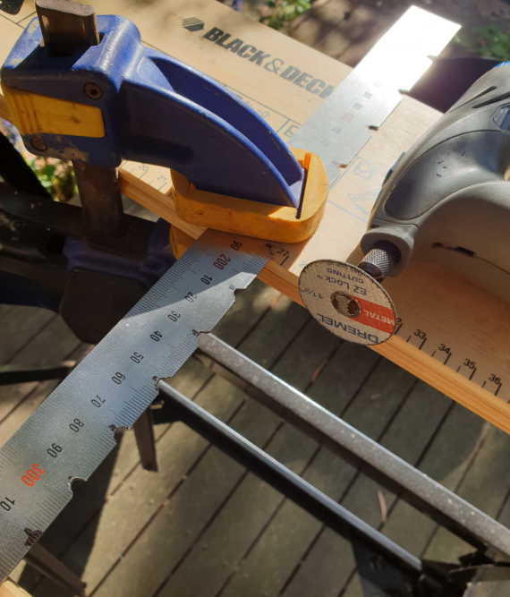

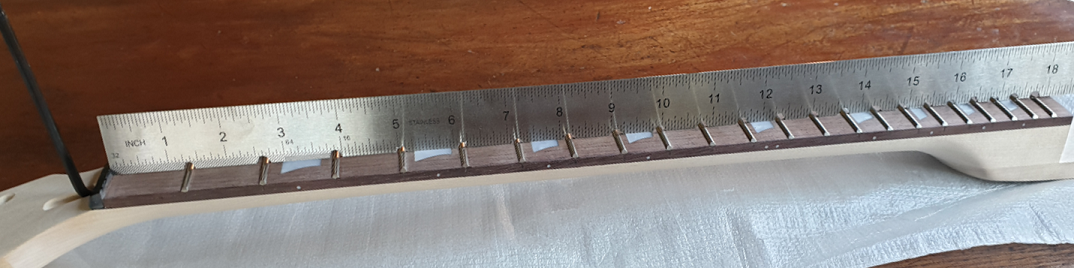

    Jumped into making the tools ill need, made a notched straight edge with a long stainless steel ruler, and chopping up a shorter ruler currently to make fret rockers. After thats all good ill have an understanding of how much the frets need to be worked.
    THE NECK IS ALL GOOD!!!!
    One huge worry i had with the kit when it first arrived was the truss rock sticking out, thankfully many helpful people in this forum and also Adam gave me some help. But now with the notched straight edge, i realised the neck was a tad convex and turning the truss rod fixed that right up. Very pleased there is no issue with a dud truss.
Name:	Making notched straight edge.png

    Hard to see with the full shot, but I've left the neck slightly convex so when the strings are put on, hopefully they will do the rest!

    EDIT: Just finished with making the fret rockers, there are only a few frets that seem to be higher by the smallest margin. So thinking i will leave the frets as they are for the time being. After putting it all together, if there is sign of buzz and fret catching ill jump on it.

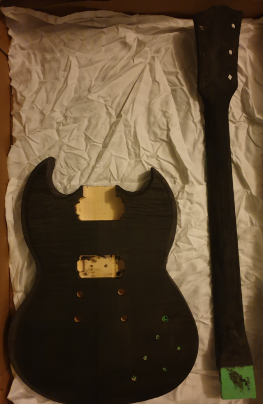

    Finished with sanding, and have covered the body and neck in ebony timbermate + feast watson japan black, and the front veneer with just the japan black. Will let it sit overnight then sand back tomorrow.

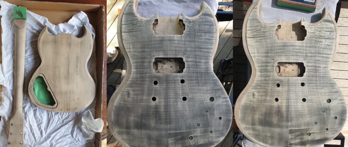

    Sanded down the body and neck, and have been working on the veneer. The top half is coming up great, although i think the bottom half is an utter dud! Even prior to sanding i could see the inconsistent flame and the awful big blotchy bits. Sanding that down has highlighted some of that. The vertical streakiness is just the veneer grain as i have sanded circular. I thought i may have sanded through on a couple of spots down the bottom but not yet, its just a pretty average bit of veneer. Looks like the top part were 2 pieces bookmatched well, then 4 segments just squished down the bottom
    The veneer also had very significant dings and scratches in it, they showed up and have been worked away.

    Sanded down the timbermate and the stained veneer

    Got onto staining
