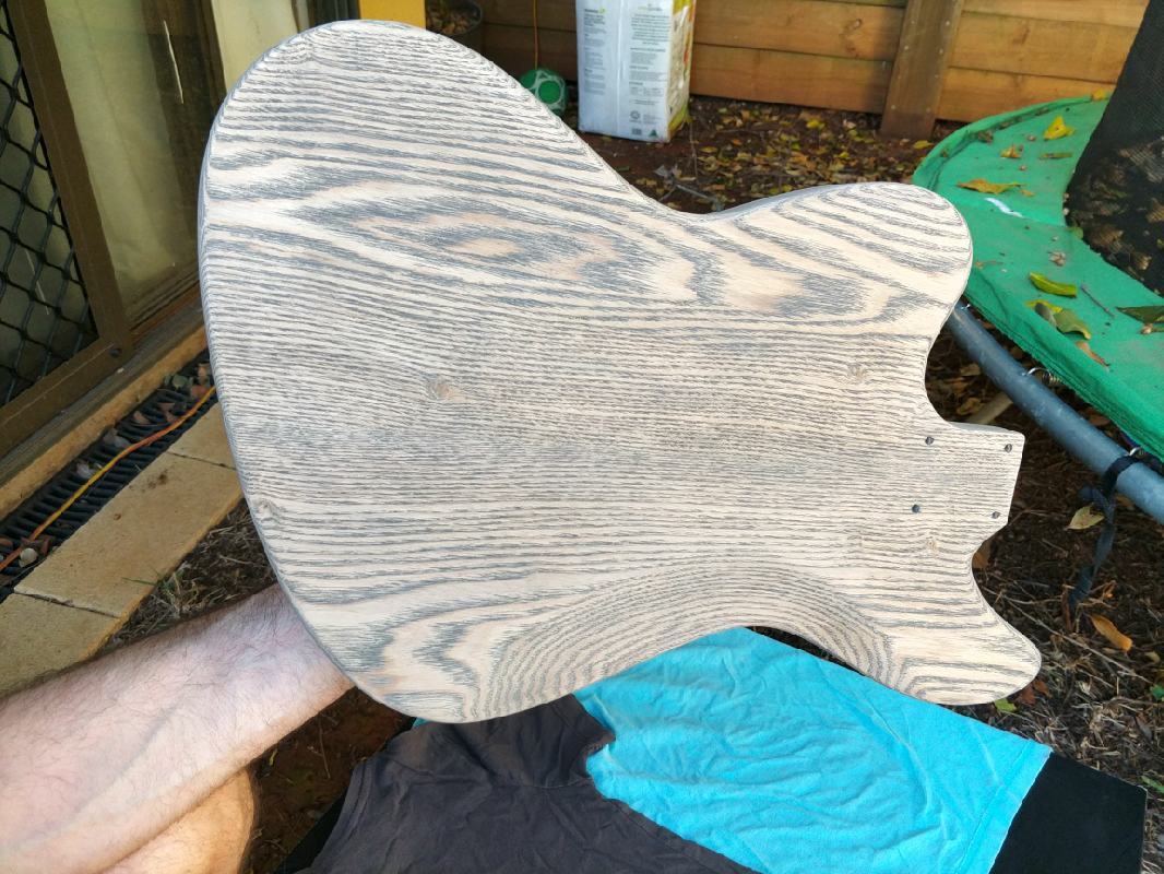

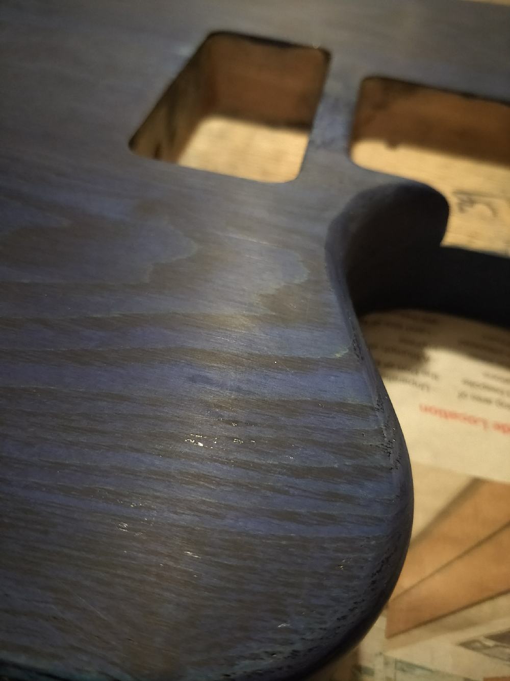

    I've started tru oiling the neck, and done 3 layers of gluboost (superglue) on the body, then sanded back to 600, with a light pass on 800.
    Ive got 2 questions on finishing I wanted to bounce off everyone :
    1) There are very small spots on the body where the superglue is lower than the surrounds. Most guides advise sanding everything flat, but here I risk sanding through the superglue for only a few small spots. Will these generally be filled by the clear acrylic spray (sca rattlecan) which is my next step, and not be noticeable anyway? (shiny spots in picture 1)
    2) Some of the pores must not have been filled with the superglue around the edges, and have collected some of the fine white dust from the superglue when I sanded it back. Are there any tricks to getting this out or colouring it? (white specs in the picture 2),
    What do you guys reckon?

    Grab a tack cloth from Bunnings to get the white sanding residue out. A tooth brush might help dislodge it as well. Generally that white sanding build-up will dissapear into the clear coat and not be noticable, but worth trying to get rid of as much as possible.
    Those little low spots are fine. Just spend time building up a really good coat of acrylic clear over it and there will be enough to knock it back flat without cutting through.
