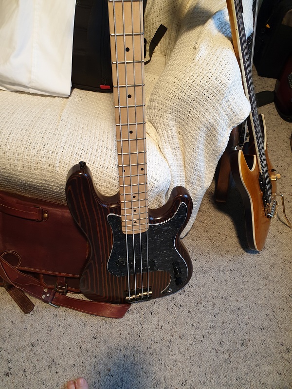

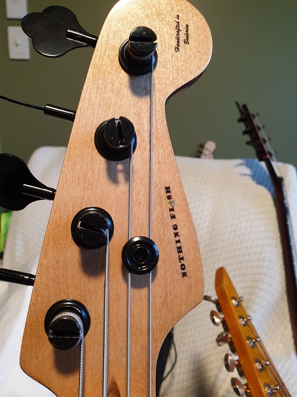

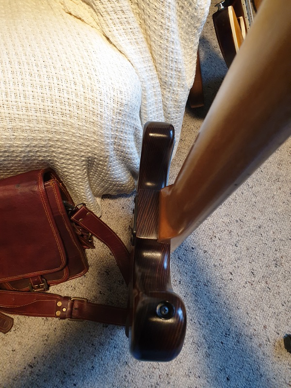

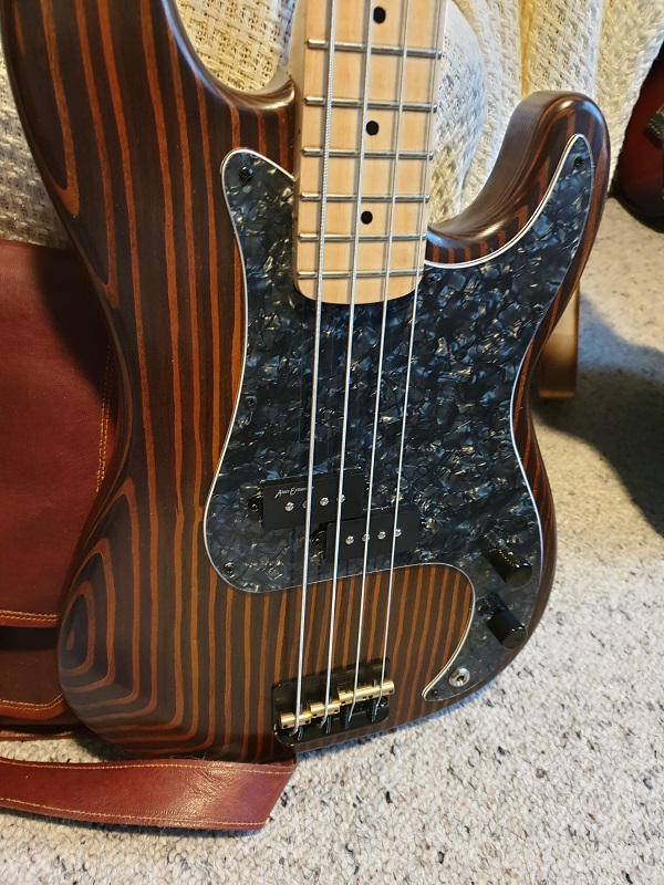

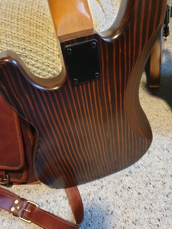

    She is done. World this is "Paddle Pop."
    This is a PBG Zebrawood Body precision base with a maple neck and maple fingerboard. A Black pearloid pickguard holds a set of Entwistle Pickups (Ceramic Bar). The volume and tone circuit is a repeat of my norm....split the P-Bass pickup and use a push pull volume pot. The Tone Pot is a Bourns mini pot. Orange Drop Capacitor gives tone and sound is moved out via a switchcraft jack socket. A Black Tusq nut and a complete black out hardware kit round out the fittings....the bridge has been swapped out for a Wilkinson Black Bridge I imported from the U.K.
    The body is stained in an attempted burst with Feast Watson alcohol prooftint stain. The body is then sealed with a number of coats of Feast Watson Fine Buffing Oil.
    The neck colour is Japan Brown FW stain and the neck is sealed with a couple of Tru Oil coats.
    Both the neck and the body have a number of coats of both Gillys Cabinetmakers wax and then Gillys Carnauba Polish to finish.
    I like the difference in the Entwistle pickups between ceramic bar (this one) and the Neodymium set I have in a two piece Ash Body P Bass. These ones have a brighter and rockier sound. The other ones are more Blues or Jazz focussed with lots of deep punch.
    Learning note for me.....applying the Buffing Oil with steel wool as directed will suck out a lot of the stain. (The body has Golden Teak in the middle, Red Jarrah around that and then Brown Japan on the edges and around the front and back sides.)
    The body is really light.....feels nice to hold and the whole thing plays really well.
