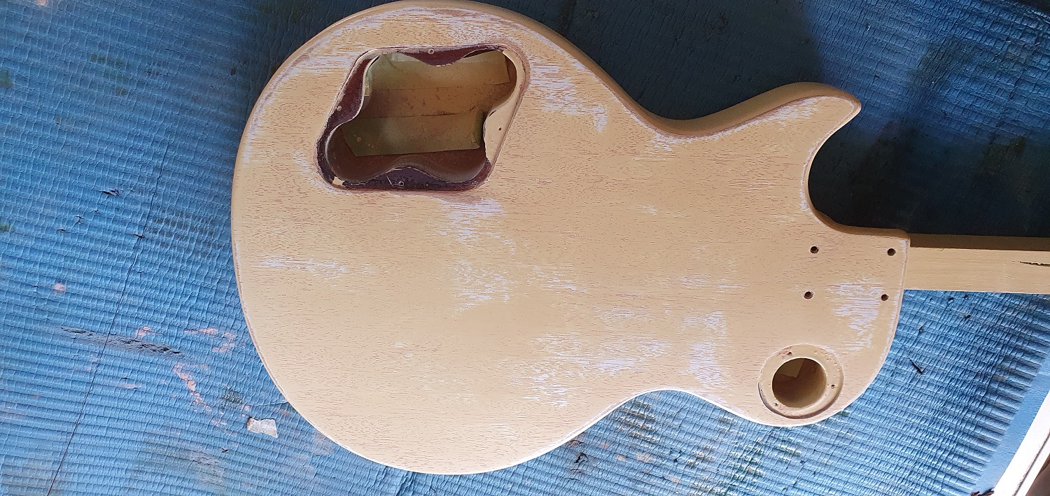

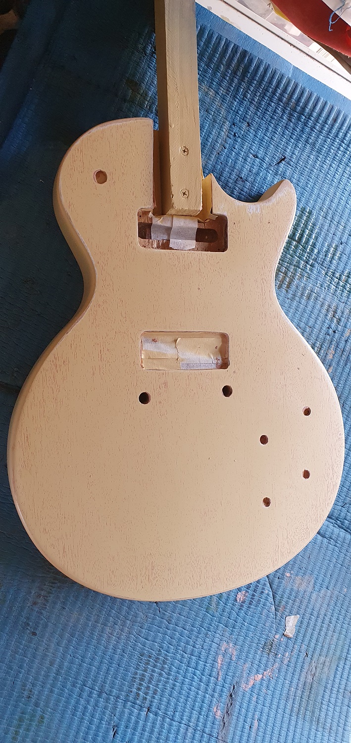

    So back to this one, didn't realise it had been sitting for 4 months. Time flys.
    After Simon's comment above I went and did some investigation and looked at old originals, as he described grain certainly visable through the TV yellow.
    So, Sanding sealer, a coat of white undercoat, and just for the hell of it a thin coat of yellow nitro, and a wet sand with 400.
    If you think something is flat, spay a coat of nitro, you will soon find out it isn't.....
    Its now been grain filled with some mahogany timbermate and sanded back with 400 again. Not worried about the edges going through at this stage.
    Far to windy today to do any spraying so progress is now down to the weather.

  8. #18
    Rant on | Bugger. Sanded through an edge one time to many.......bloody things getting reliced, and that's the end of it! | Rant off.

  10. #20
    Quote Originally Posted by Rossc0 View Post
    If you attempt to paint over Timbermate it will sink.
    cheers, Mark.
