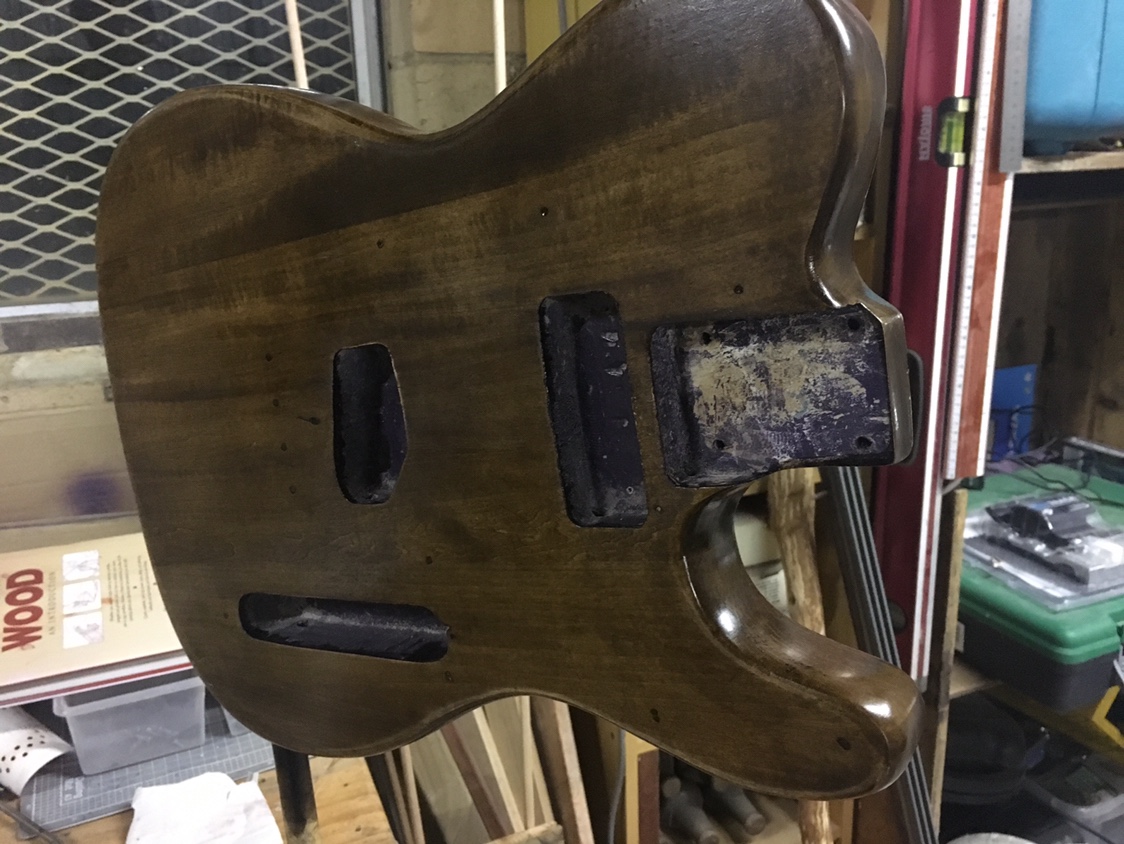

    Hi Mav & HD,
    This is what I did,
    The maple block added to the heel helped keep the bulk of that step in place for joint strength, but allowed me to taper the rear of the body into the heel. The finish on Theo’s one never quite went right so at some point, future me is going to get the irrits with it and sand it back to redo. But that will be the fifth time it’s been sanded back and current me can’t face that at this point!
    I did some other weirdness like go EMG and add a battery box as well.

    Thanks FrankenWashie,
    That's a good approach - you got the shape without compromising the strength. Can I say that finish looks terrific. Love the dark stain with the brown. Kind of relic-ed looking. Also, novel approach to the placement of the battery box.

    Thanks mate. The surface finish isn’t what I wanted, it’s quite uneven. But to be fair it was my first kit and I’d been fairly ambitious with the mods and the finish, but that’s part of the fun.
    You just need to ask yourselves how you want that joint to look, and how far you are willing to go to make it look like that.
    Adding some additional depth to the heel is pretty simple, it’s whether you want to further contour that Heel/body transition that will complicate it.
    best of luck with it!
