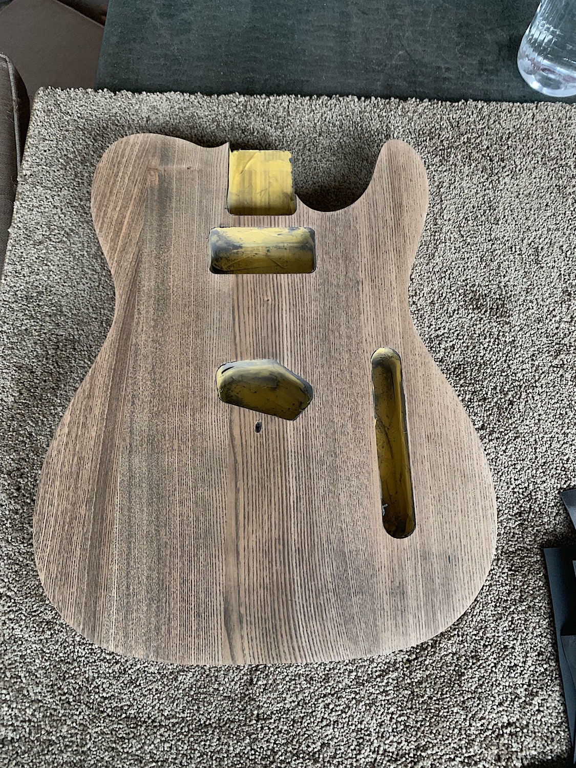

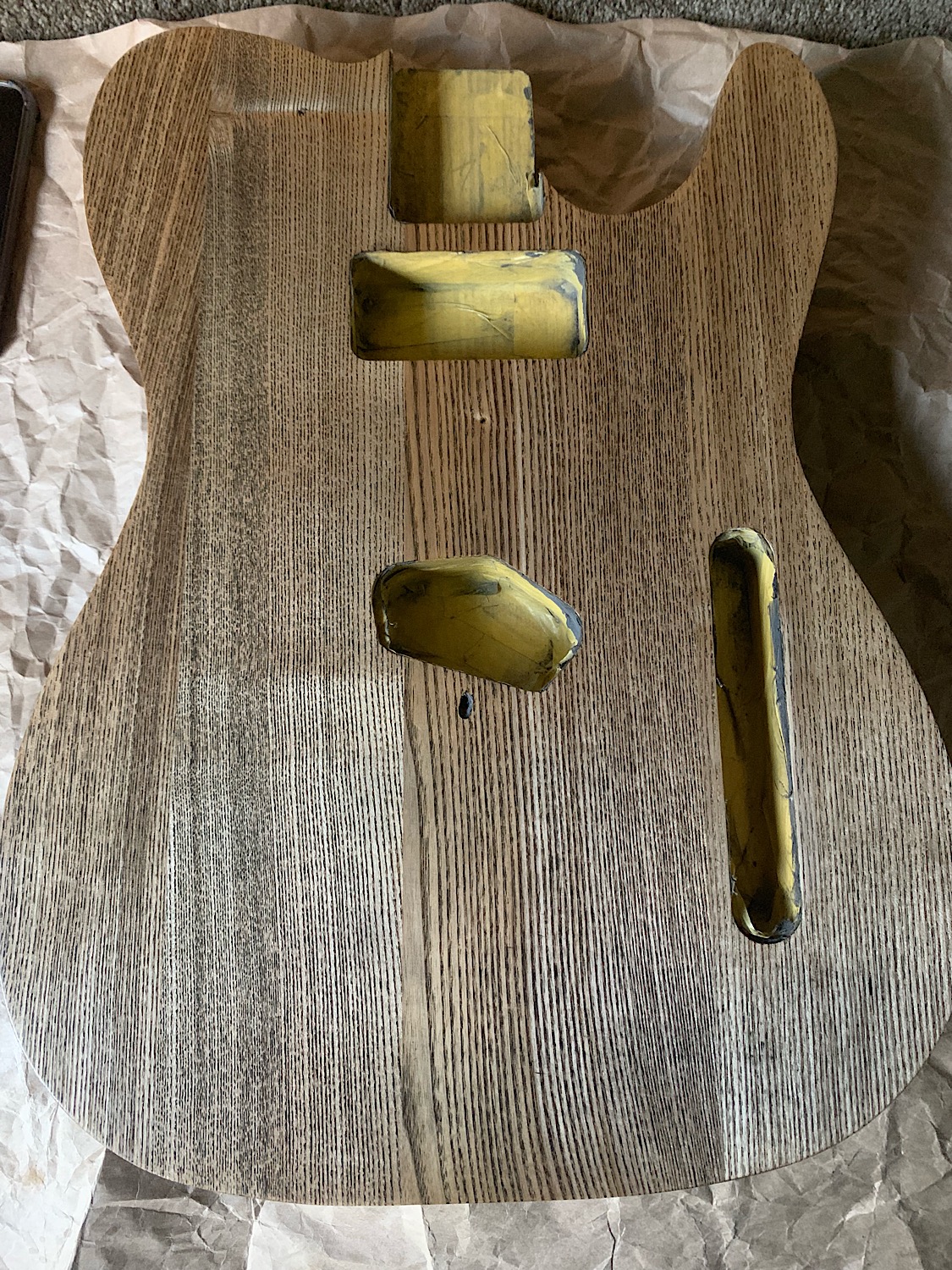

    Have been busy with sanding the guitar body in prep for grain filling. And have just filled with ebony timber mate. I am relatively happy with how this has turned out as I wanted something to pop the grain of the wood.
    Next step will be reshaping the headstock and sanding down the neck. Any advice to what grit I should be sanding the neck? I will be applying a wipe on poly over the top of the maple neck.
ID:	31643   Click image for larger version.
    That will look great when it gets "the wet look" with some clear on there!
    As for sanding the neck, I usually do just a bit of 240 then 400. No need to go any finer IMO. Some folks don't even go that fine, but I think there's still plenty for the finish to grab onto with 400.

    The grain is coming out nicely there with the stained timbermate. I'm trying to learn as much as I can about getting the grain to pop as well. Can I ask why you went with the ebony timbermate rather than a stain?
    Good luck with the rest of the project.
    Builds:
    Under way - EXM-1
    Jun 2019
    156
    Hey,
    I used the ebony timbermate as an contrasting colour. From my very limited understanding a stain will pop the grain but more inline with the colour that you are applying. I used the timbermate wood filler (diluted with a few drops of water) to highlight the grain and to really stand out from my finish.

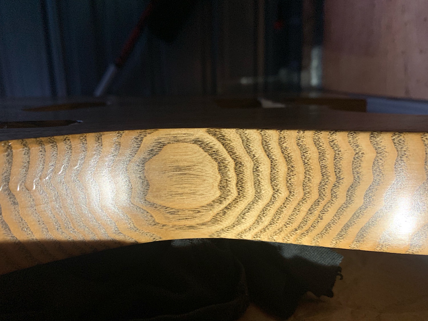

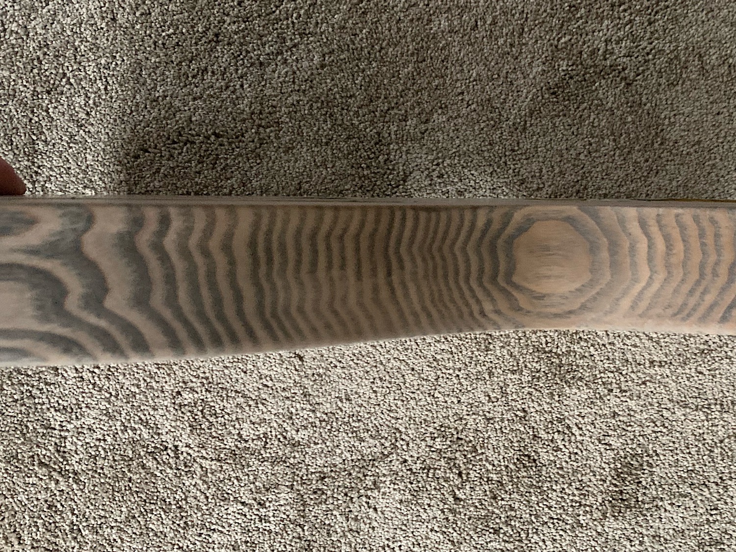

    Hi All,
    I have started finishing the body of the guitar. I started with a few coats of danish oil and was happy with the colour that was achieved. I will be applying a few coats of some wipe on poly to the guitar. I am working in a small tin shed and have noticed that lots of dust is settling on the guitar body in between coats. I have been using a tack cloth to get the dust of the top but some small spots have dried in. What is the best approach to dealing with this?
    I will be attempting to straighten out the neck of the guitar today at some point and may apply some wipe on poly to this too. It seems I will need to do a full level as the frets are all over the place in regards to hight. Anyone have any tips on the neck straightness. I am assuming this is a critical point in playability and needs to be dead on for fret leveling.
