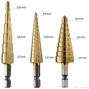

    How much wider does it need to be? Can this be done with a Dremel?
    Quote Originally Posted by TZK321 View Post
    Couple of mm (edit) both sides.
    I used one of these.
    https://www.bunnings.com.au/ozito-17...l-kit_p6290175
    cheers, Mark.
    3,080
    I'd use one of these. The nice thing about these is they are self centering. Close to idiot proof, which appeals to me. Not completely idiot proof, tho, which is how I know you need to really fasten down that control plate before trying to drill out the hole so you don't turn it into a mini lawn mower. Click image for larger version.
