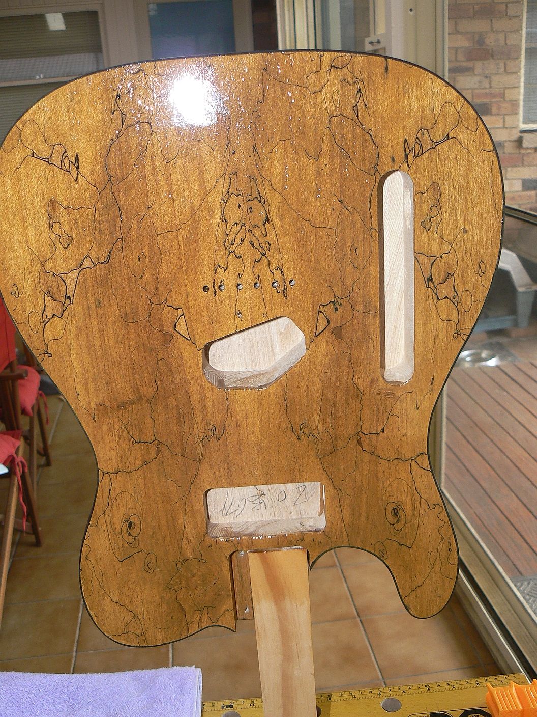

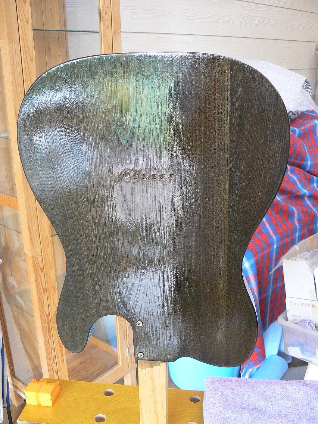

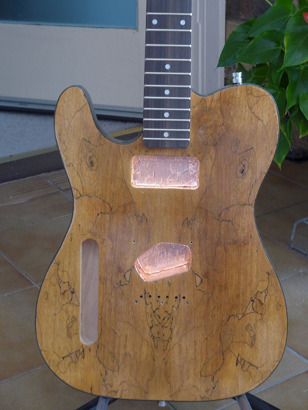

    Finally getting back to this after some interruptions.
    Colour has come up nicely on both the front and the back.
    Have piled on the coats of tru-oil. Not up to the glossy standard of the swampcaster but I am happy with it.

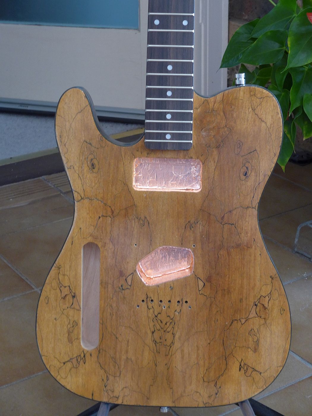

    And also have managed to copper tape the pickup holes.

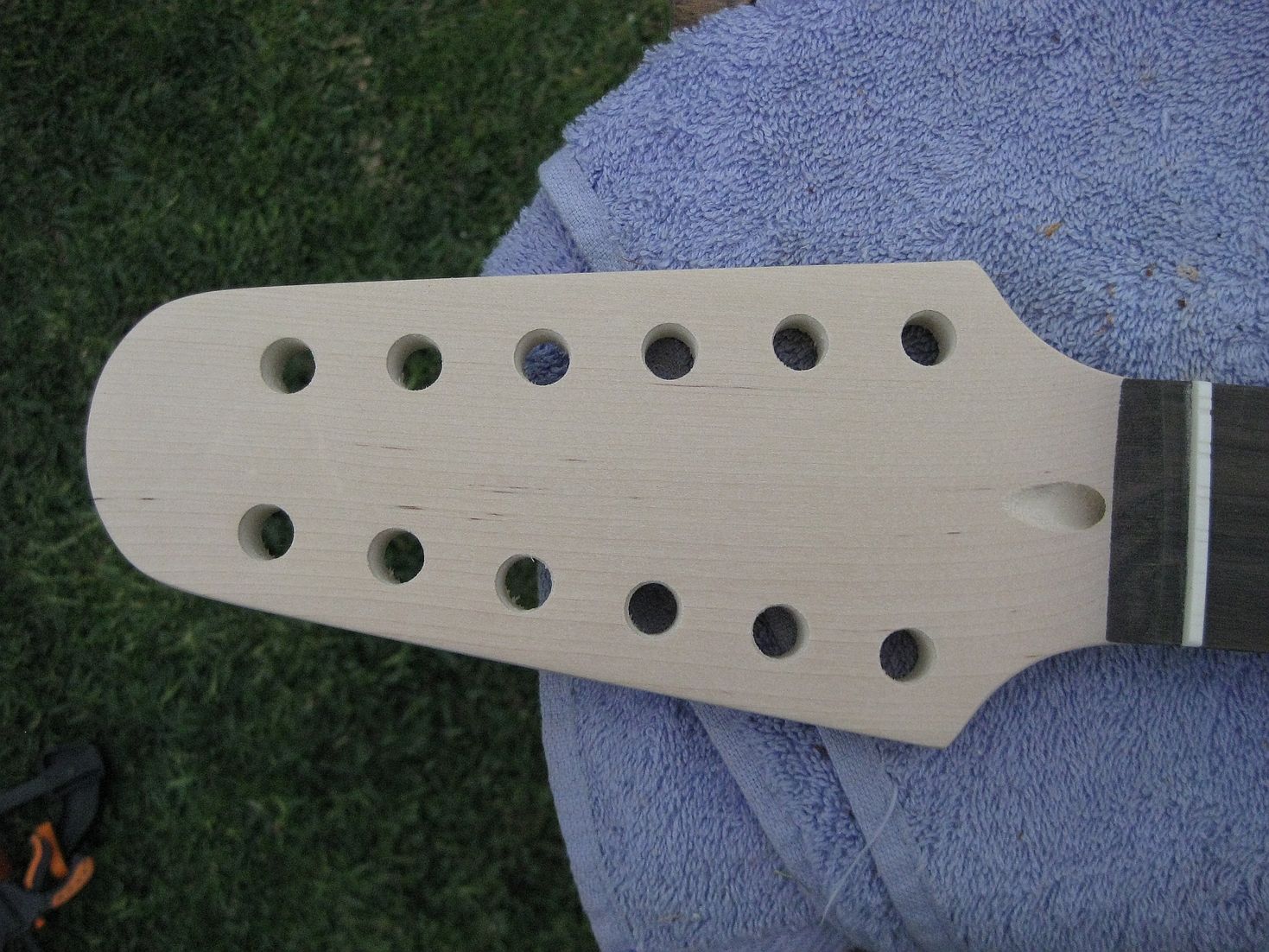

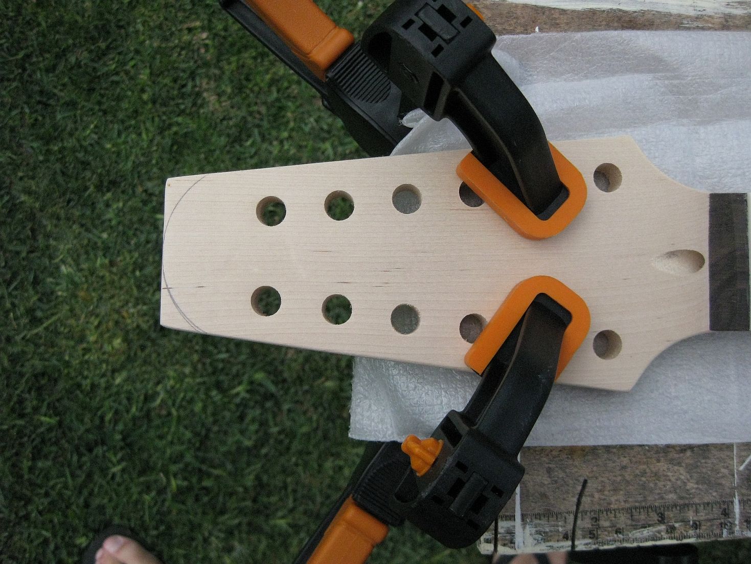

    Headstock also needed some refining.
    Rounded the edges to get a nice curve consistent with the body shape.
    Body is looking good, but at what point did this become a 12-string???
    I don't recall that in the earlier posts...
