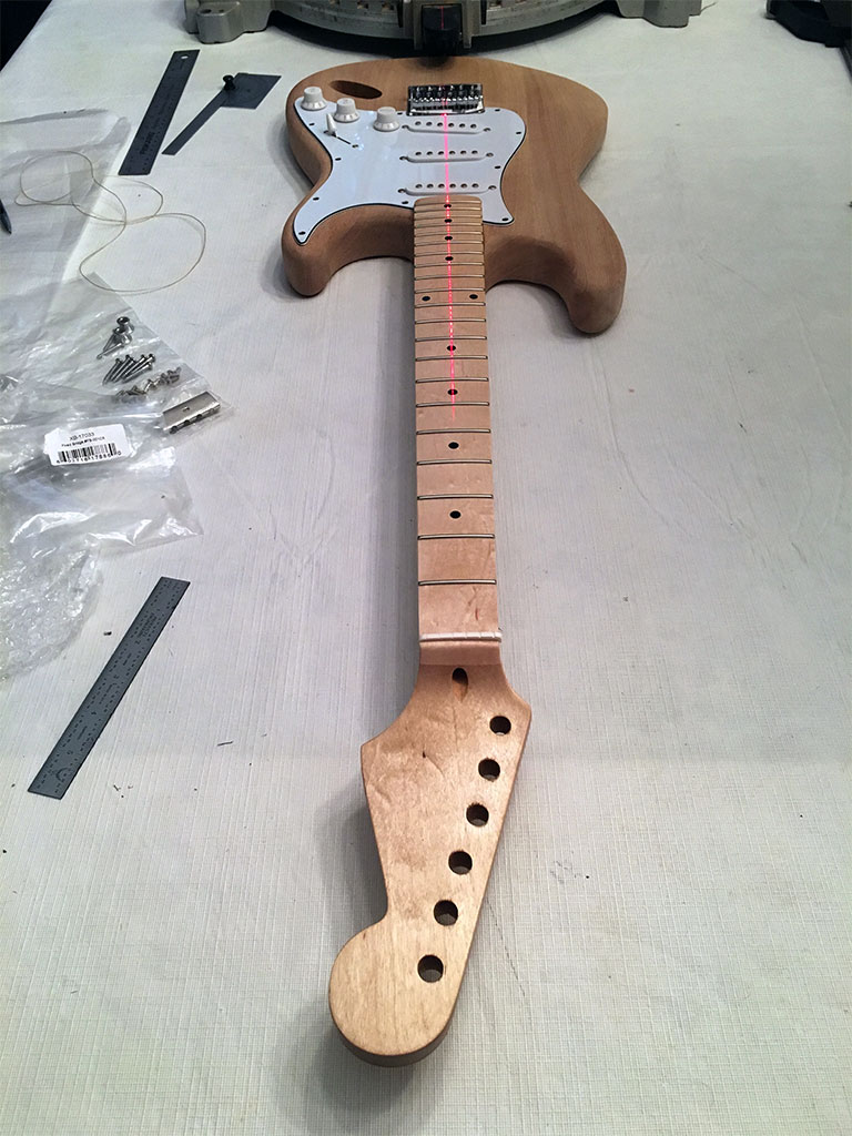

    Here's a pic of the setup on the laser:
    It's my miter saw, but it works and I have it on hand!
    The neck is just sitting there for the pic, but I held it tight in the pocket, lined up the neck, then removed the neck without moving the body.

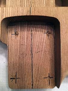

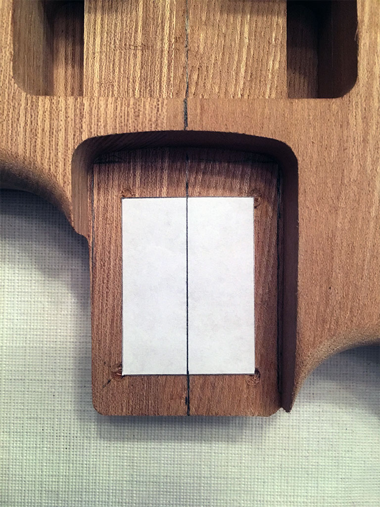

    This is the lowest tech way I could think of to mark the four new hole positions:
    A 1.5" x 2" square piece of paper with a centerline drawn to hold up to the centerline in the pocket.
    Mark the corners:

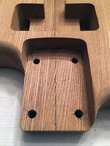

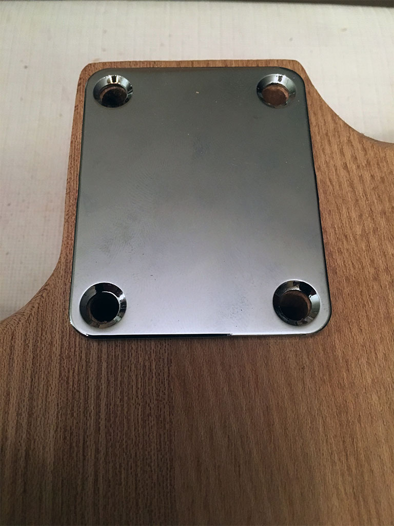

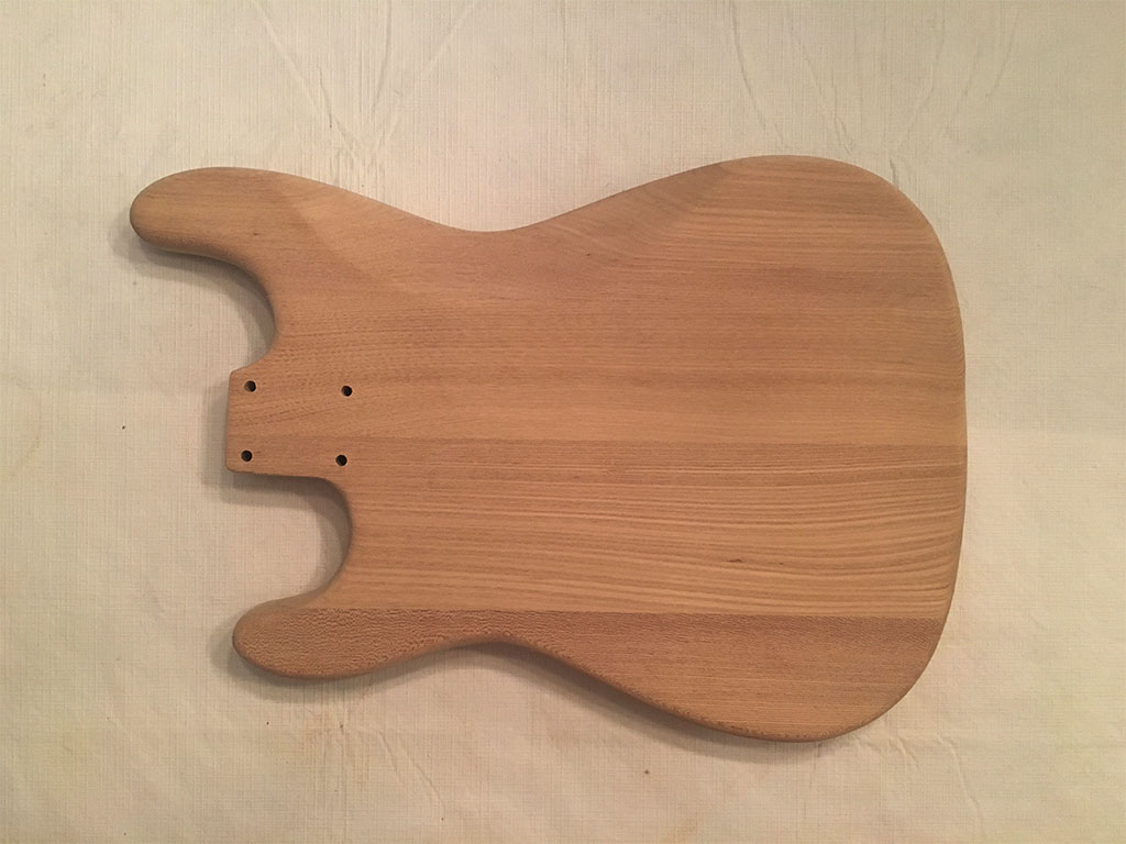

    Drill 1/4" holes (the same size as the neck plate):
    It's not perfect, but I can live with it:
    Who's the drunken monkey now?

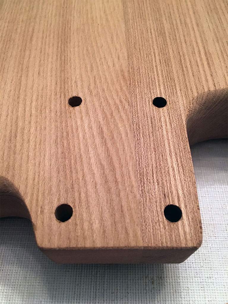

  6. #4

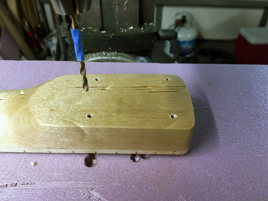

    I put the body and neck on the laser again after clamping them together to confirm alignment.
    Then took the same 1/4" drill bit I used to drill the body to just mark the neck.
    Then drilled those 4 pilot holes on the drill press:
    I then attached the neck with undersized screws so I could get rid of the clamp and put it all together on the laser again:

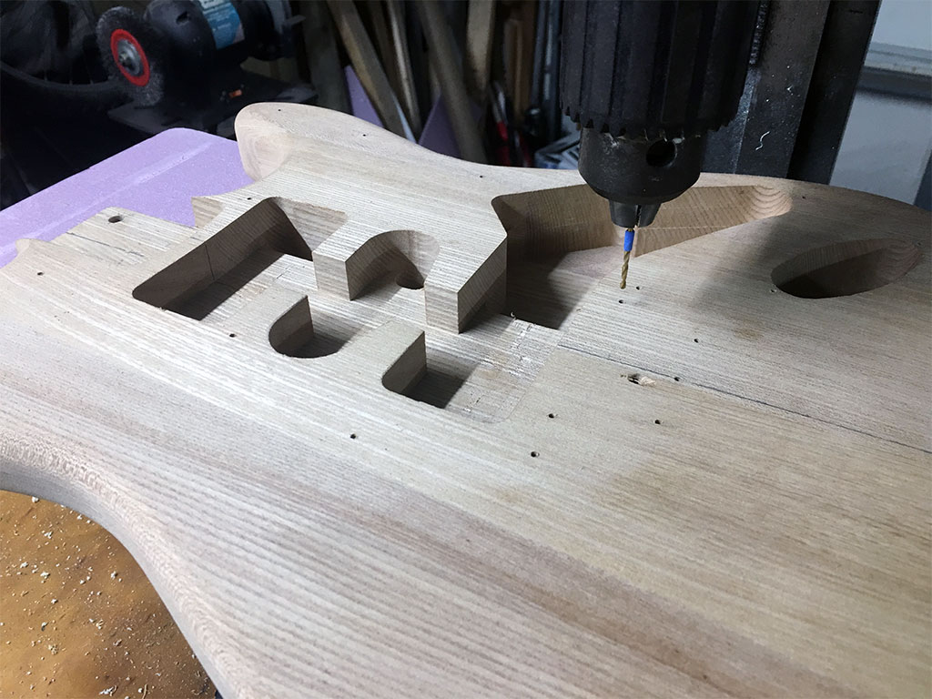

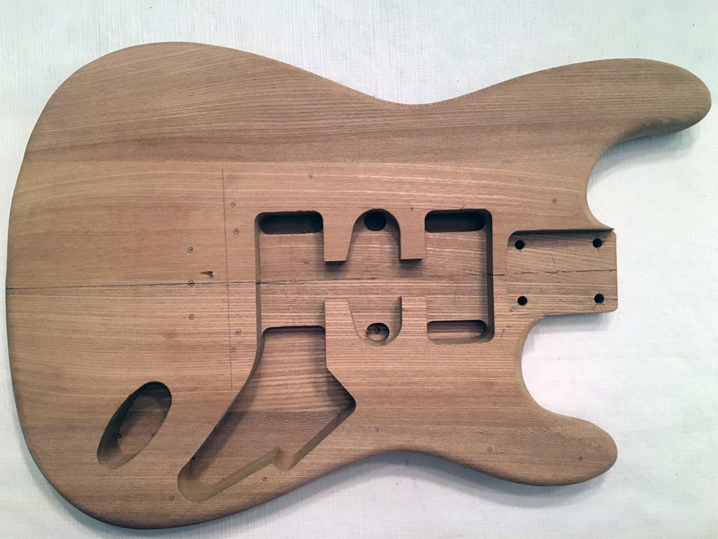

    I marked the pick guard and bridge holes:
    ...and drilled the pilot holes on the drill press:

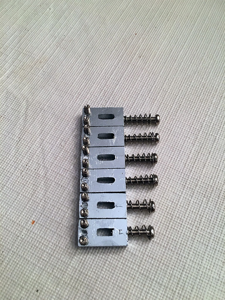

    The underside of saddles are not the cleanest either.
    I plan to file out these edges a bit.
    To help out stringing the guitar, if nothing else.
    At this point, I am considering leaving this guitar as a side load and perhaps drill the through-body holes later, once I'm convinced the bridge landed in the right place and intonation is spot on.
    On that subject, I measured the scale (25.375") and marked it on the body while the neck was screwed to the body.
    Prior to doing so, I made sure all of the saddles were adjusted to 1/3 of their travel less than fully extended.
    This would leave 7/64" (2.78mm) worth of extension capability for the high e string and 7/32" (5.56mm) worth of retraction capability for the low E string.
    With the saddles arranged in that fashion, the neck screwed in place and everything lined up on the laser, I found that everything lined up beautifully along the centerline. However, in order for the saddles to line up with the scale line I had drawn, the pick guard had to be trimmed about 3/64" (1.19mm).
    After comparing the pickguard with a fender pickguard I had on hand, I determined that they shared the same spacing for the neck to bridge.
    I decided to place the bridge up against the pickguard and not trim it.
    This configuration leaves 1/16" (1.59mm) worth of extension capability for the high e string and 17/64" (6.75mm) worth of retraction capability for the low E string. I think this will be enough, but I am not confident enough to blast 6 holes completely through the body.
    I figure over the next few years, we can go back over this guitar and get replacement tuning machines, pickguard/electronics, bridge and tackle the holes at that time. I have to leave myself room for more birthday gifts.
    At this point, the body is ready to be sanded and finished.

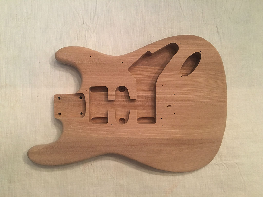

    Clean and smooth, ready for color:

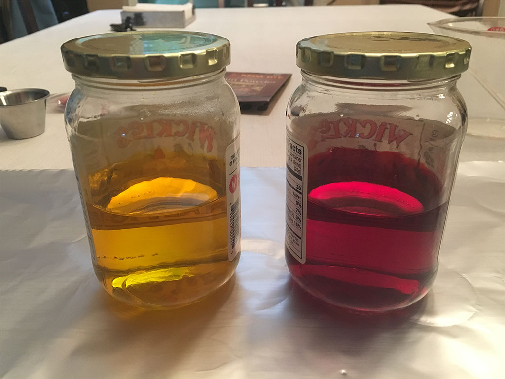

    For color, I decided to use dye powder and mix my own. I used a product line from KEDA; https://www.kedadyeinc.com
    I have no affiliation with them, just sharing for the sake of anyone looking to try a similar stunt for the first time, like myself!
    This stuff is soluble in water or alcohol. They recommend 70% rubbing alcohol because the water help dissolving the dye.
    I mixed 0.50g of dye powder with 2oz of warm water, then added 6oz of denatured alcohol.
    Here is the yellow and the red:
    I figured it would be easier to mix the dyes in liquid form, rather then weighing tiny amounts of powder.

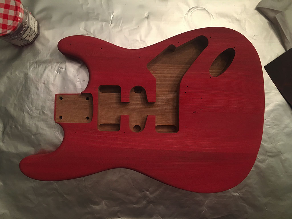

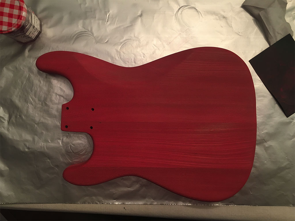

    I settled on 1 part yellow to 20 parts red for entire body.

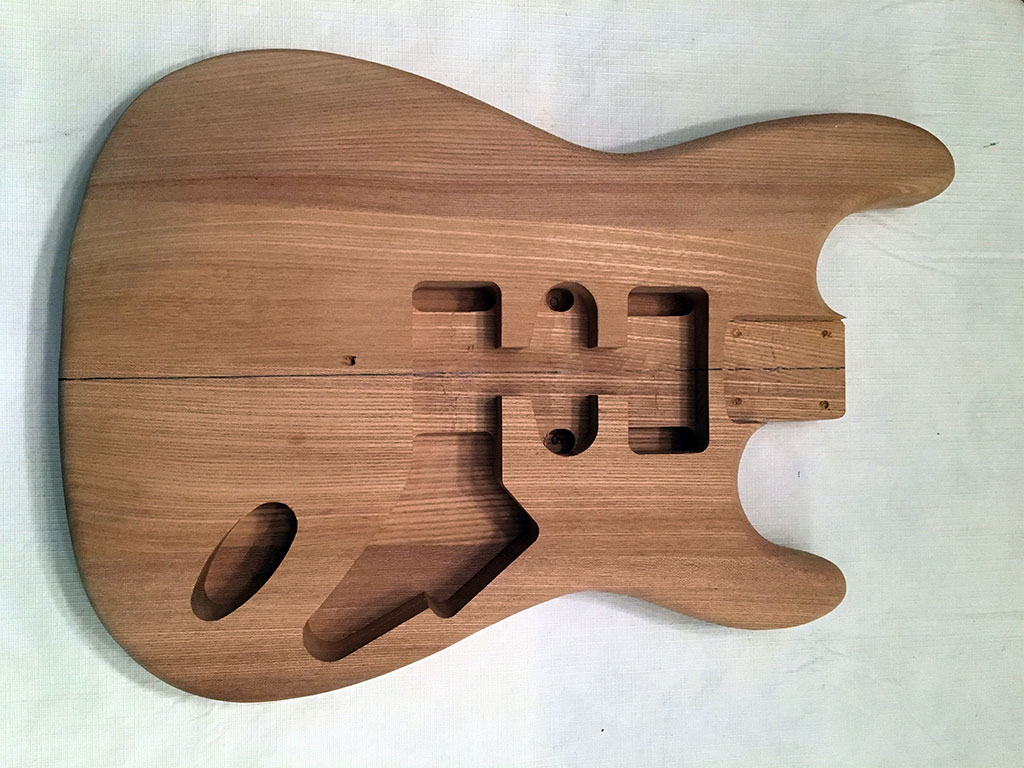

    After the first coat of dye, the grain raised a tiny bit. I used a 400 grit paper to tame those fibers, without sanding through too much color.
    Here it is after a couple coats:
    When this dye dries on the wood, the red turn a shade of pink. As soon as the dye is wet again, it turns a beautiful blood red. Here's to hoping that when the Tru-Oil hits it, it makes a nice color!

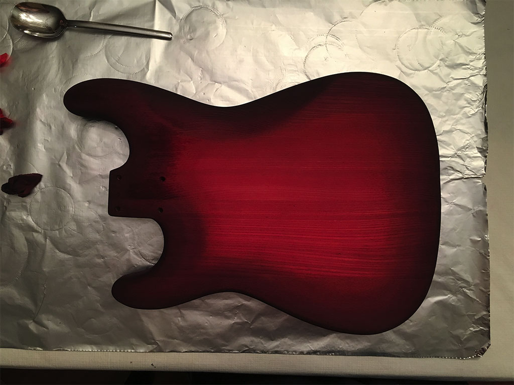

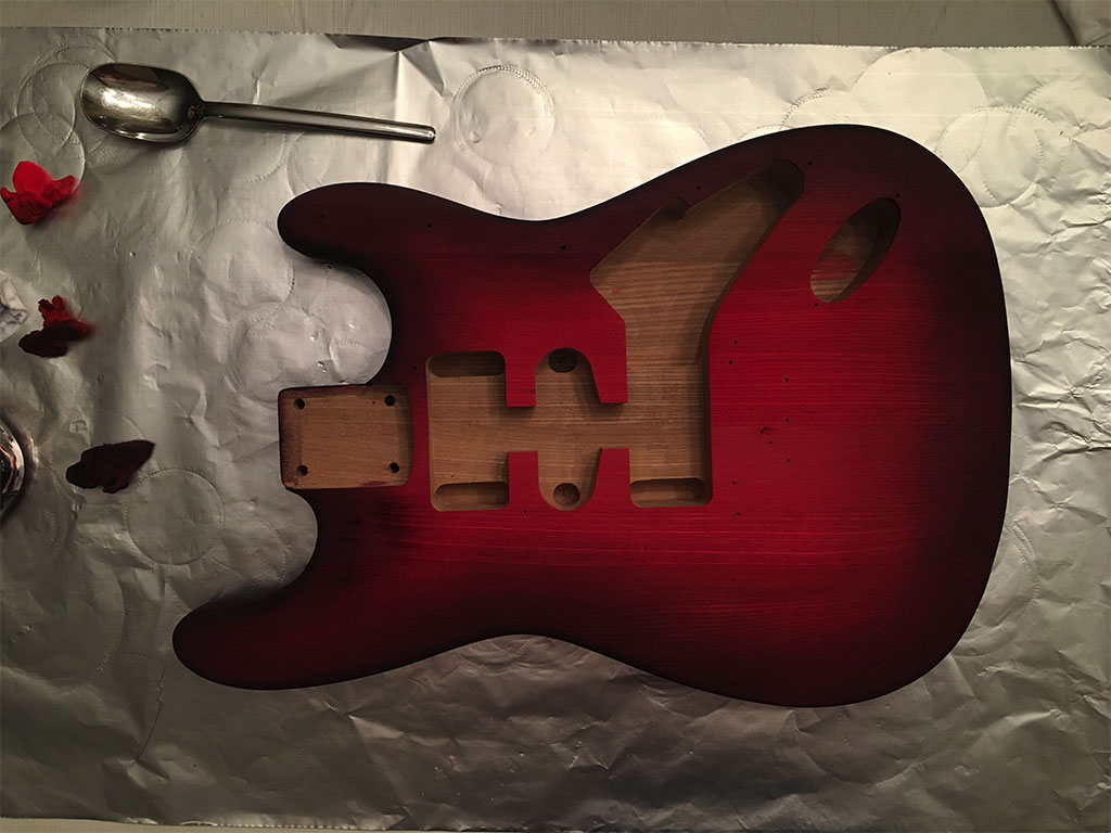

    After letting it dry overnight, I mixed up an 8oz solution of black dye to try my hand at a burst. Simple red to black.
    I started with applying the black to the edges and then rounding the edge to the back and top.
    Then mixing some red and black dye, rubbing in the edge of the black.
    Then taking some red and rubbing in the edge of the rubbed in edge.
    Rinse and repeat for a couple days until it looks right or my eyes are crossed.
    I think I am happy with it when its wet:
    It's fairly wet in these pics but already staring to dry. Alcohol does not give you much time before its gone.
    There's still a bit of streaking in the black on the edges.
    I plan to hit the entire body with red one last time tomorrow to smooth out all the streaks.
    Then let the body dry for a few days before getting the first coat of Tru-Oil applied to lock this color in!
