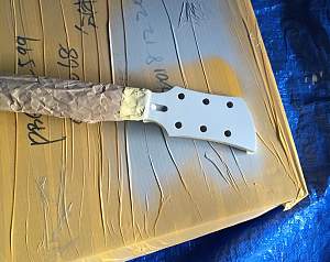

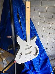

    Primer applied to headstock and body....I ended up going with Dupli-colour auto primer.
    I borrowed a proper 3M respirator thankfully....nasty smell.
    Despite a cold day, it went well. I'll give it a gentle sand then proceed with the colour this weekend. Click image for larger version.

    That痴 coming along really well mate .

    I used Duplicolour paint and clear coat acrylic for my build. It gives great results, but does seem to take a quite a while to cure properly. A rough rule of thumb - between 3 and 7 days before I was happy it was done.
    I learned to poke it - if my fingerprint remained as a texture then it was not yet cured. The good news, a quick rub and the fingerprint would disappear.
