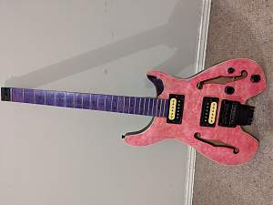

    So all the hardware is on now, and I'm really pleased with how it looks
Name:	IMG_20190909_200846 (Custom).jpg
Name:	IMG_20190909_200856 (Custom).jpg

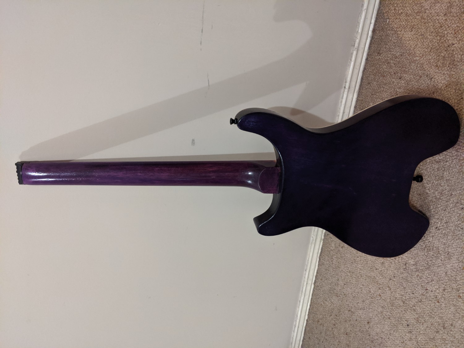

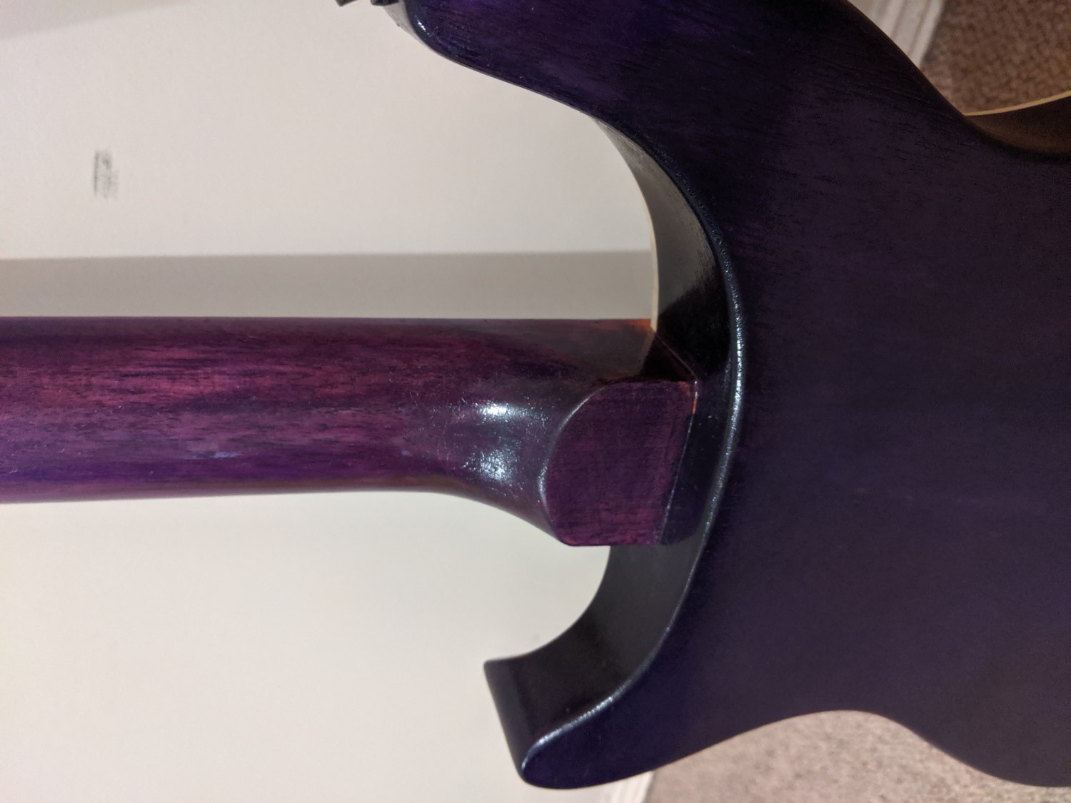

    I did mention offhand that I'd stained the back of the neck purple in one of my previous posts, but this is the first picture I've popped up. Since I used pink on it first it ended up a lighter purple than the body, which I am totally happy with, it still looks nice to me.
Name:	IMG_20190909_200900 (Custom).jpg

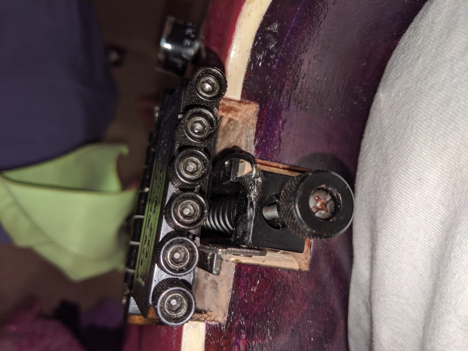

    Now, no strings on it at the moment because while I was grappling with understanding this (to me) completely alien bridge and nut system, I was trying to lock down the low strings and I'm not totally sure if I crossthreaded the screw or if it was just the metal isn't very solid, but I stripped the thread of the nut. I've ordered a replacement for it and I'll be a bit more careful with it. Hoping I don't have to resort to completely redoing things to fit a new type of nut on, but we'll see what happens.

    Got the replacement nut today, and got strings on there safely, but looks like the nut is sitting up a bit, and not pulling the B and high E strings down on the Zero fret properly. I'll have to pull it back off in the morning and see if filing the shelf down a bit will do the job, or if I'll have to fill and re-drill a hole.
  6. #16
    Alright, tried to shim and do a little bit of filing and so on to try and get the nut sitting properly, but no luck. So re-drilling it is gonna be the go. Got it all set up, just waiting on it to dry now.

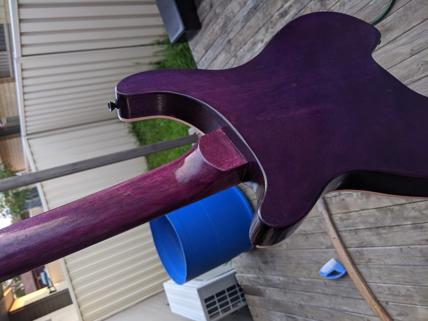

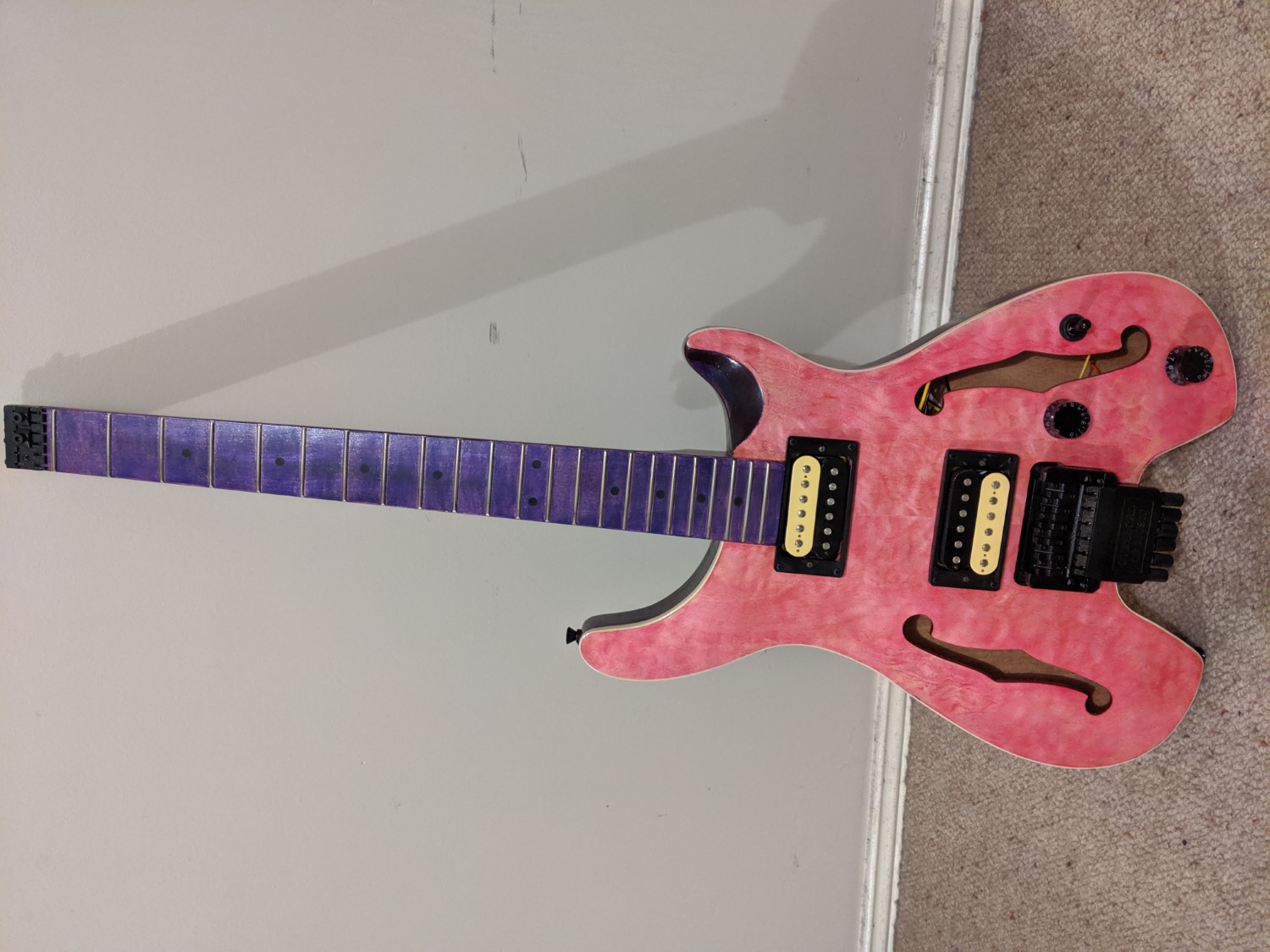

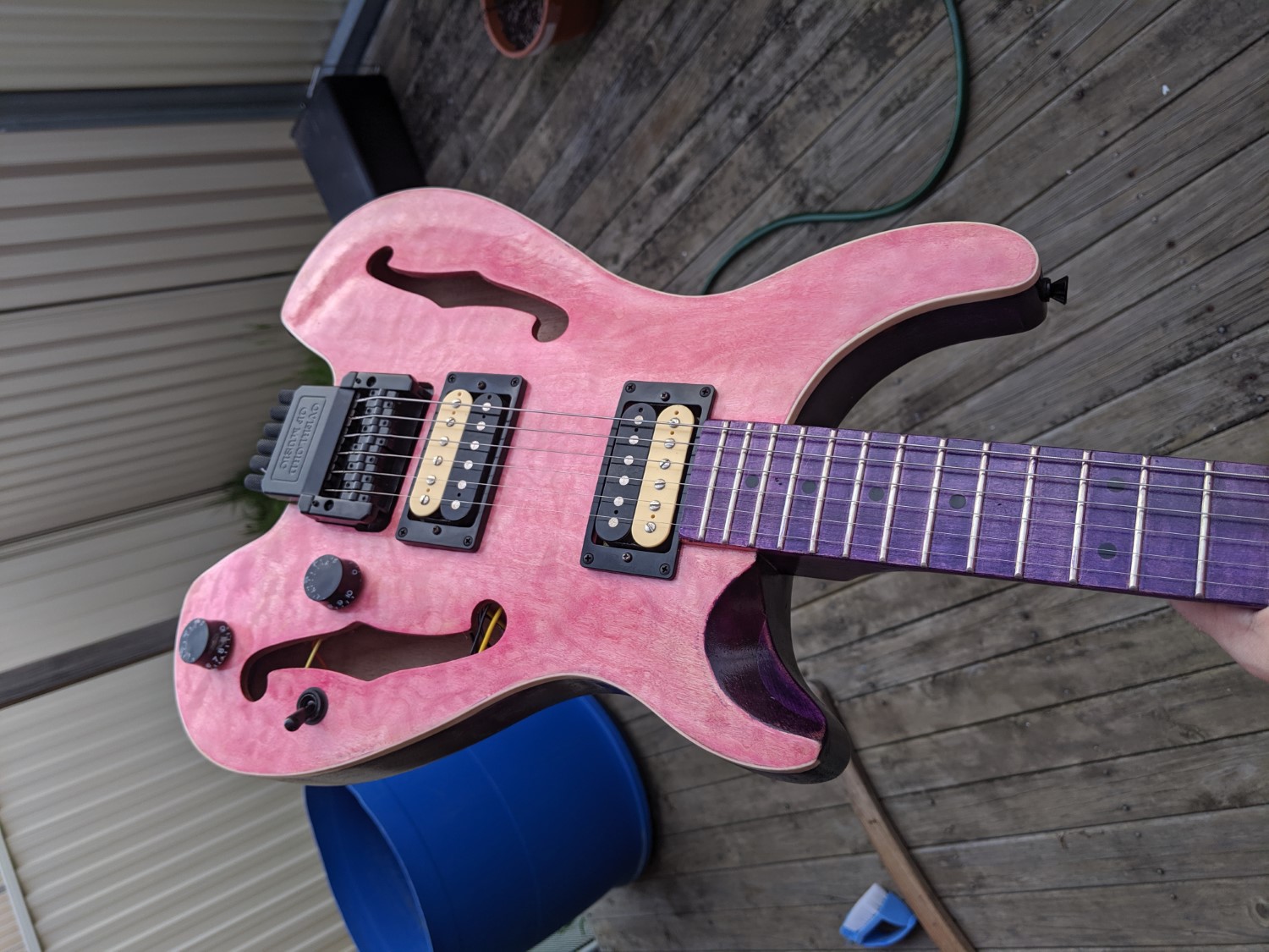

    I think we're all done now!! Had a bit of an issue with the grounding but sorted now. Had a wire heading to the bridge, and ran it under the bridge plate, but the connection there wasn't doing the job, so soldered it on to the corner of the plate. Looks a little sloppy, but it's not right up front and it saved having to take it apart at all haha
Name:	IMG_20190922_220109 (Custom).jpg
    And a couple outdoor shots
Name:	IMG_20190921_172514 (Custom).jpg
Name:	IMG_20190921_172523 (Custom).jpg
Name:	IMG_20190921_172529 (Custom).jpg
    I think that's about it! Happy with how the pickups are sounding in it too. Overall, quite happy with the build
