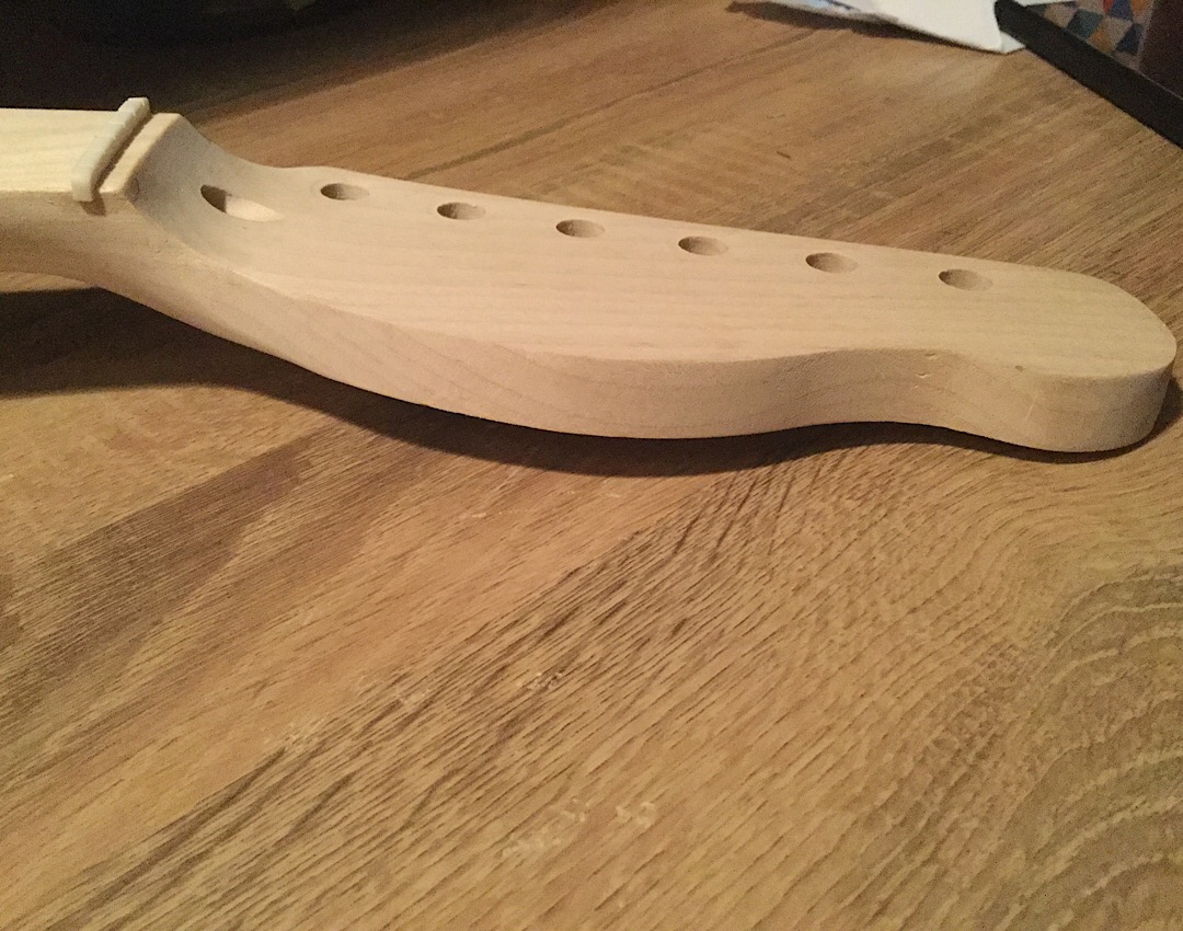

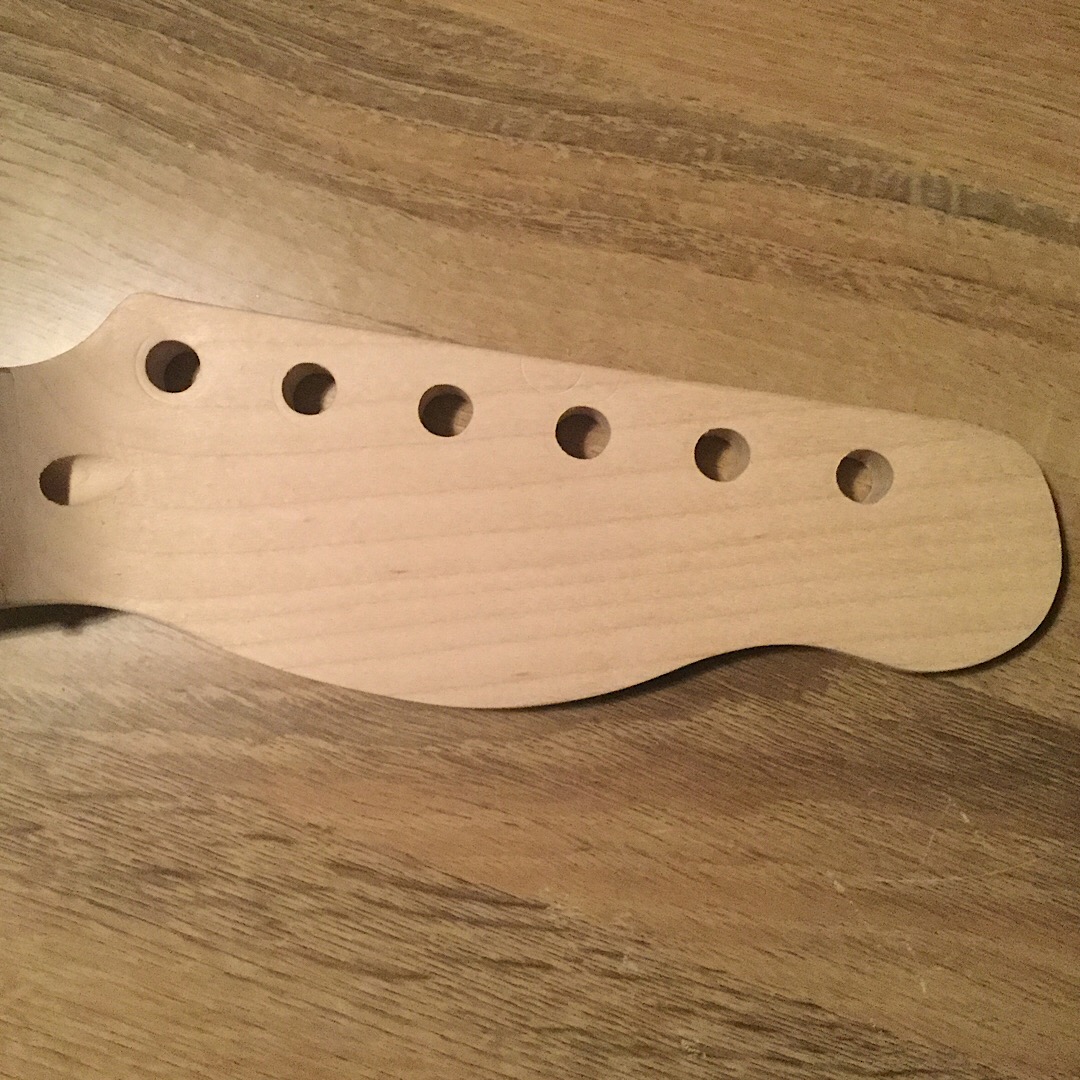

    Hello again everyone. Fortunately I haven’t had any problems but I’m glad to hear I can get help here. Today I didn’t do very much but I’m very satisfied with what I have done.
    Today I finalised the headstock shape and cut it out with help from my dad. I haven’t used a scroll saw very often and I’ve only ever cut plywood (which happens to be a lot thinner than the headstock) and softer mdf. I decided to go with my first idea but I moved the curve a bit lower down, leaving more wood and allowing me to amplify the curves.
    Here’s the result

    I’m very happy with it and after the initial cutting, the filing went well. I’ll do some sanding a bit later on, just before I paint and coat it.
    Speaking of painting, where can I get the correct paint and clear coat here in Perth (preferably north of the river)? I believe I can’t just go to Bunnings, grab some paint and go - or is this something I can do?

    You’ve done a good job there mate, looking good.
  6. #16
    Welcome Dylan, you are doing a great job. You are thinking about the process and not just barging in. A Tele is an excellent first choice. looking forward to the results

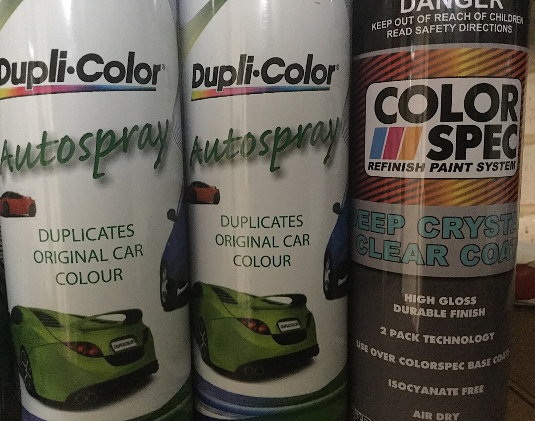

    Paint shopping
    Hello again,
    Today my dad and I went around to get some paint and necessary sandpaper. Just like I’ll Give it a Go suggested, we went to the Joondalup Super Cheap looking specifically for the Colour Spec paint, but they didn’t have all 3 parts (They only had primer. Eventually we ended up at the Balcatta one where we decided to take the pictured paints.
    We confirmed with the staff that the paints were compatible and were the same but we are going to do a test tomorrow anyway.

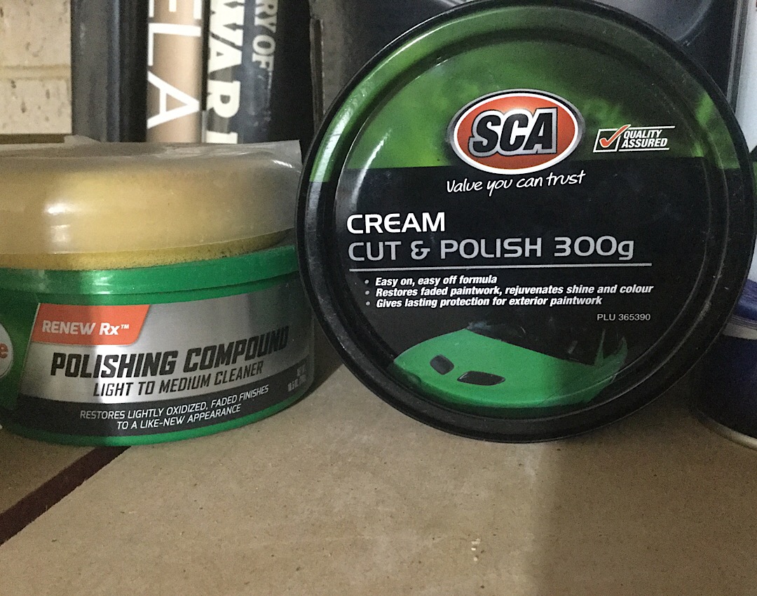

    We also picked up come polish and cutting compound as the manual suggests.
