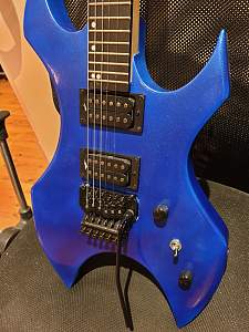

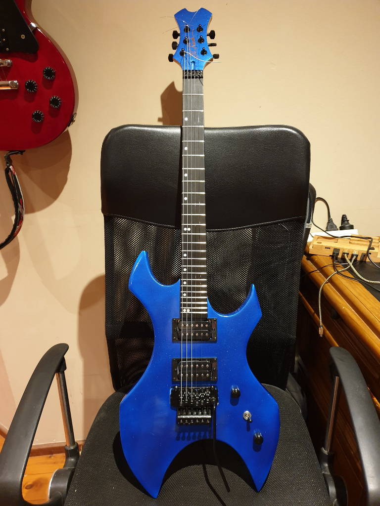

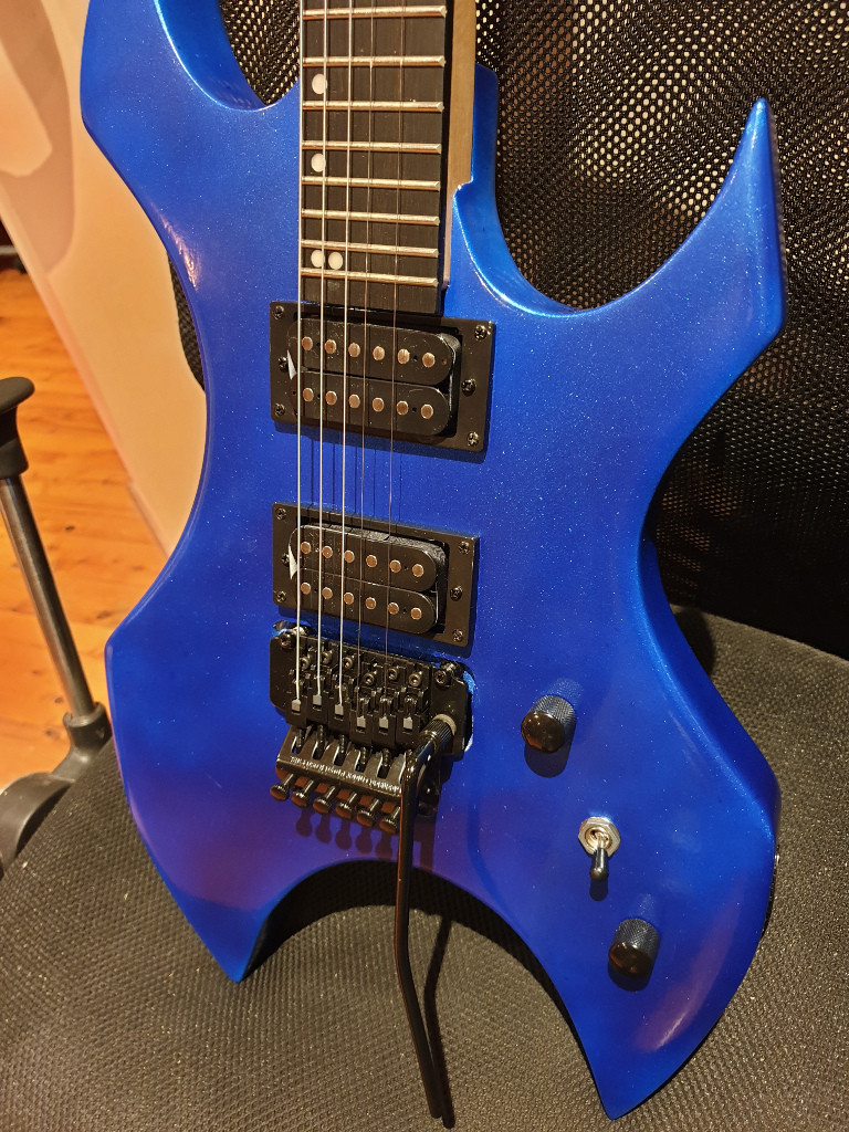

    Finally got around to giving it a polish and assembling today. First issue, I discovered the pot/switch cavity cover is missing from the kit. But, bigger issue is that after all the soldering and putting it all together, no sound. Doesn't matter the switch position, I get nothing. Not sure what I've done, but I couldn't be bothered trying to work it out right now. Hopefully I've just shorted out something, maybe a stray strand from an earth wire with any luck and hopefully I haven't fried a pot. Also going to need a lot of setup once I work out the wiring issue. Otherwise, it looks OK...

    Looks great in that colour, nice job! As you mention, probably an earthing issue.
    Pulled the pots and switch out and spent a fair bit of time testing for shorts etc. Tested resistance levels on the pots without having a complete understanding of what results to expect. Measured the same short between the middle leg of the volume pot and earth a dozen times while working under the misguided assumption that this was what was expected. After finally coming to the conclusion that it was not expected, I squinted through my poor eyesight of an old man and my glasses that are obviously requiring a prescription update and managed to spot the tiniest sliver of solder that had managed to create a short. It was like a very thin spider web strand that had somehow managed to string itself in the course of my inadequate solder job. I flicked it away with my screwdriver, and voila! ... sound. Fixed up a couple of other dodgy solder joints and put it all back together and it's all working.
