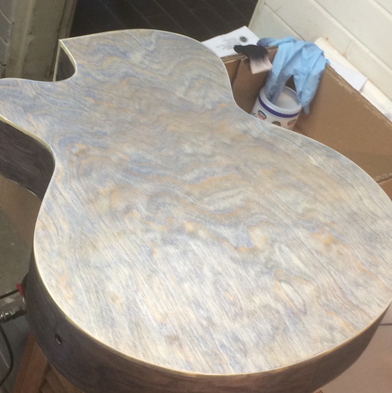

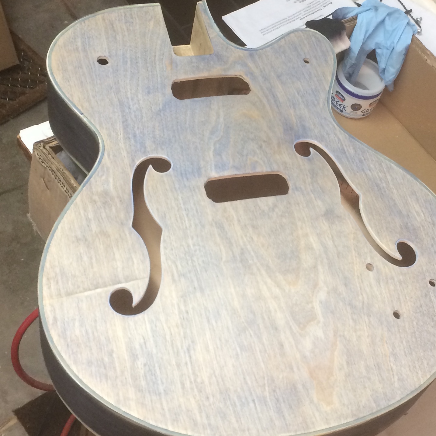

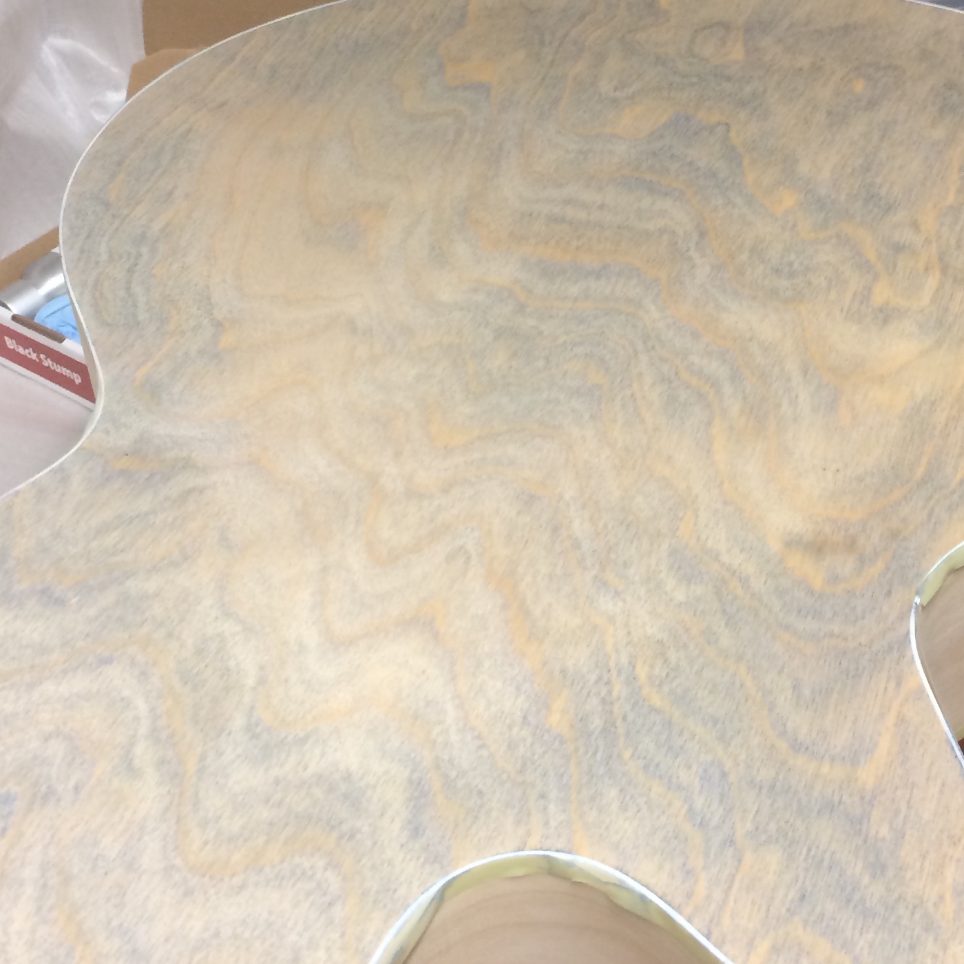

    Here are the photos of my staining progress to date. First coat then second coat and second coat on front. I think all should be good by fourth coat

    I wish you lotsa luck with trying to get some colour into that. Looks like a small amount has been picked up in the open grain but the rest is still very highly polished and may just stay looking natural timber colour.
    Might need to re-start with 80 grit and finish on 120. Once some DT is already down it could be difficult to open things up enough unless you are prepared to do a full sand-off and try again.

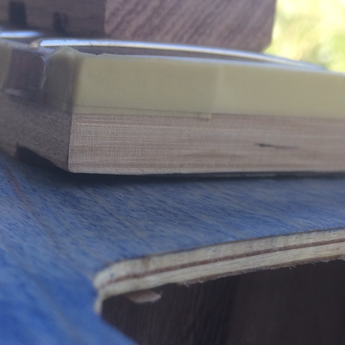

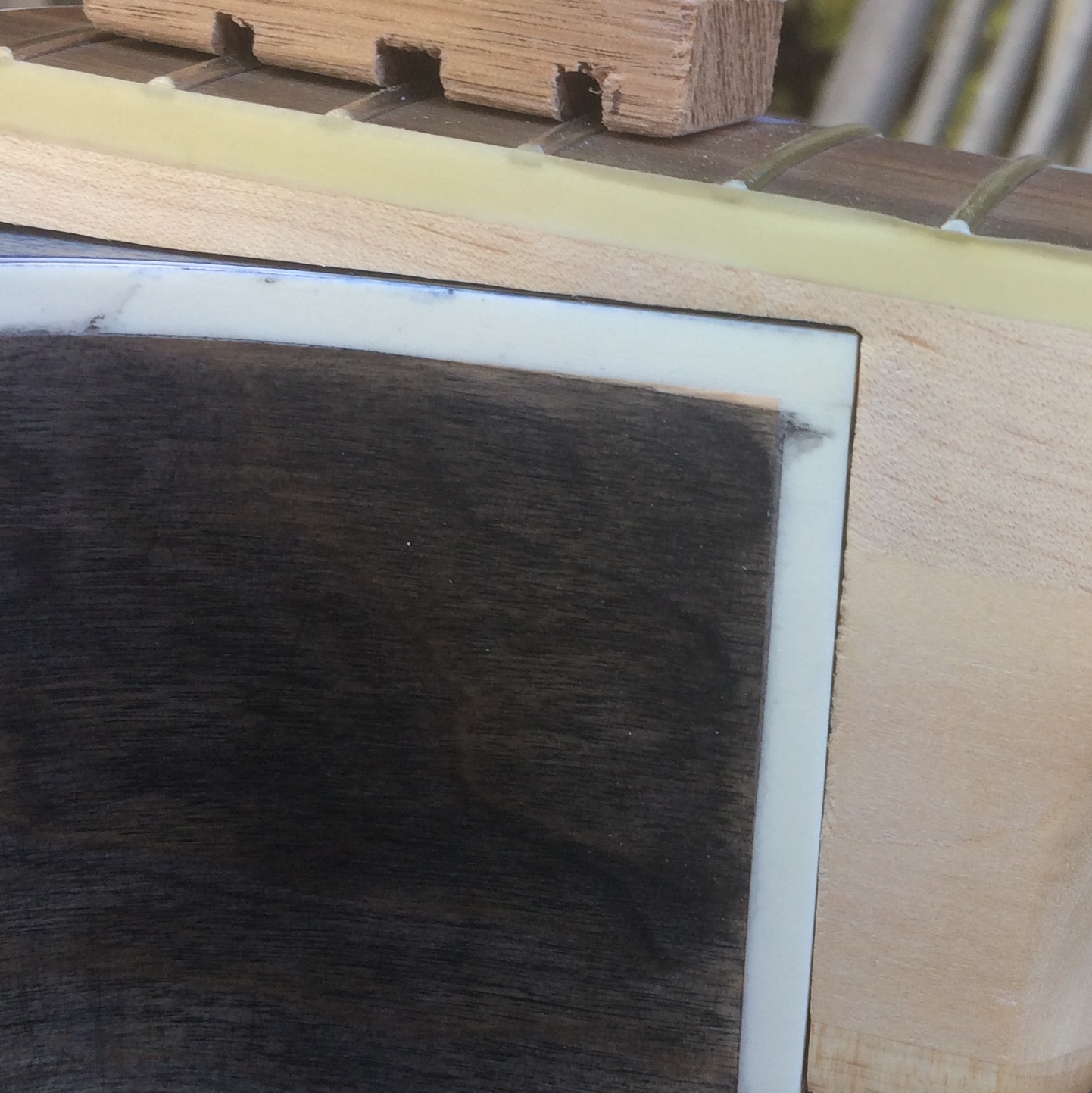

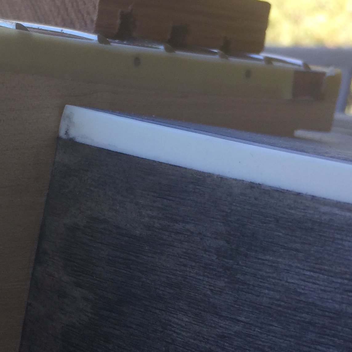

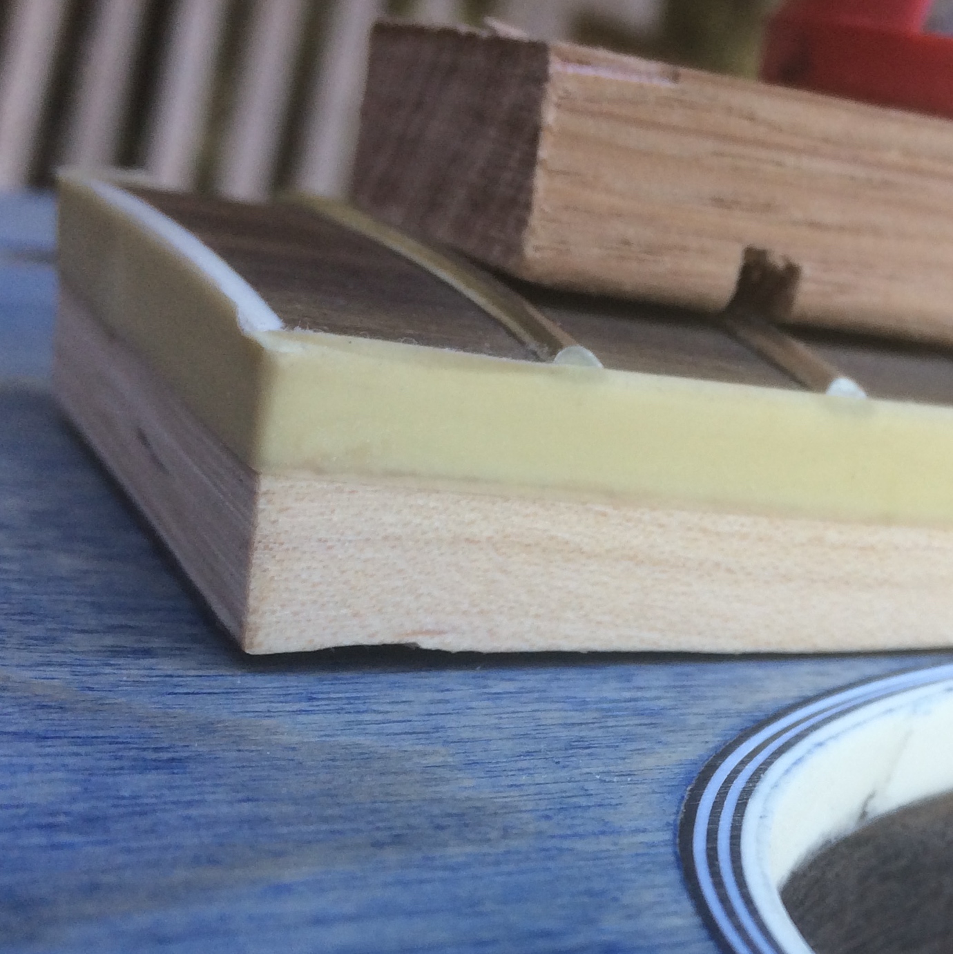

    Keeping to my schedule of no more finishing work until after Easter, I have been checking out the neck fit and I have found some slight anomalies that I would like to correct. BUT I note the caution in the Pit Bull manual, not to sand down the heel or floor of the neck pocket. The gap between the neck rebate face and the front face of the body (sound board) rises to about 2 mm. You can see about 1 mm convex curve on the neck and I have put a little Blue Tack in the floor of the neck pocket and pressed home the neck to find there is about a 1 mm gap in there at the inner part of the heel. I therefore feel I could shape the neck rebate face to the sound board and get a much closer fit. Although this may cause a little grief on the other joint surface matings.
    Is there anyone with some experience in this area? Photos below

  10. #20
    Hi,
    I had the same issue when I built mine.
    Check my diary but in the end it did not really impact the bass itself.
