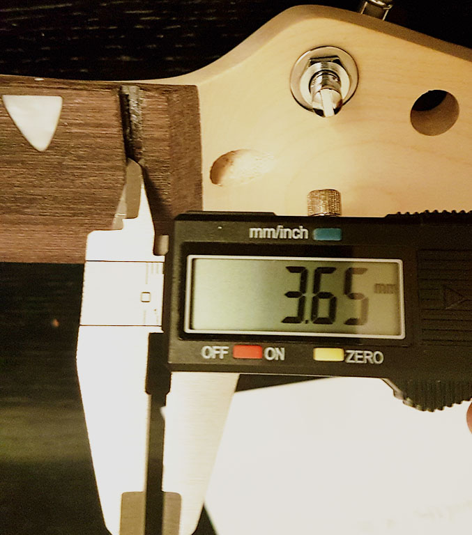

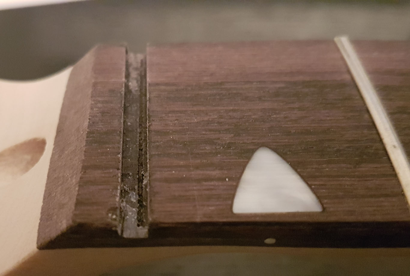

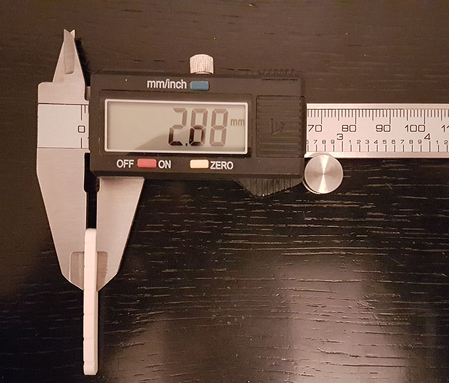

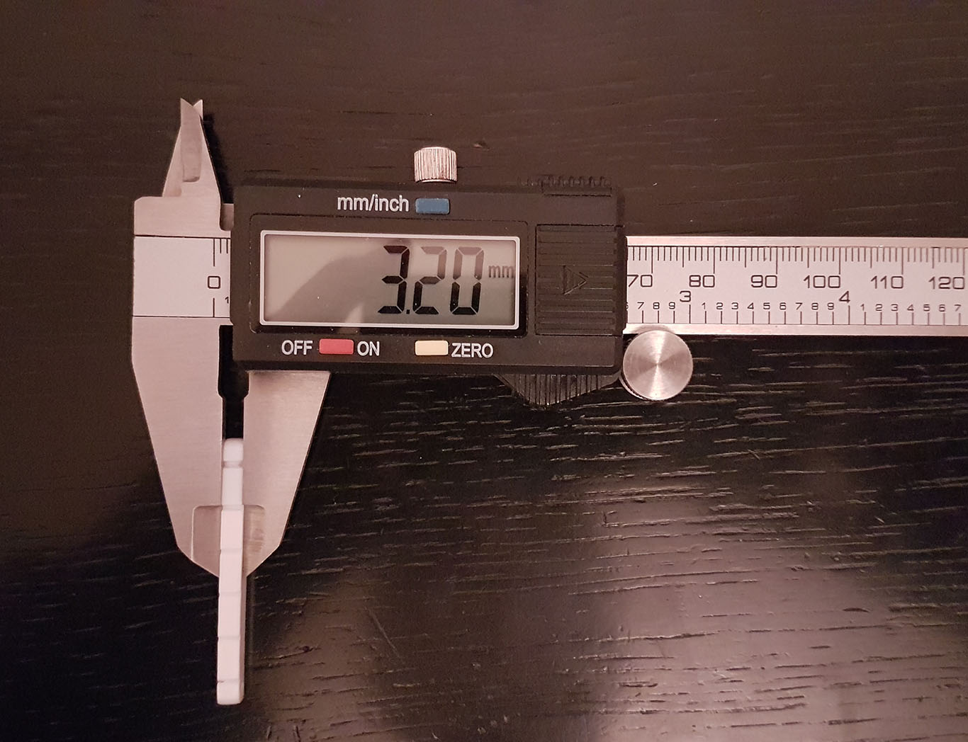

    As requested, an update on the relative size of my nuts :
    Original plastic nut:
    New Bone Nut:
    Nut Slot:
    The plastic nut, when glued in place, was fine. The bone nut is .3 of a mm too narrow, and so it flops around quite a lot in the slot.

    Yeah that’s a combination of slightly too big slot and slightly too thin nut. Theoretically it should be 3mm. A small shim should do it. You can find out what the fret measurement should be using the stew Mac fret calculator, that will tell you if you should shim in front or behind the nut.
  10. #19
    That is unusual, I'd check with Adam, perhaps you got the one in 500 that was a bit thin. I've used the Pitbull bone nuts in 90% of my builds and they have been fine so defiantly check with Adam. And failing that I'd shim it.
