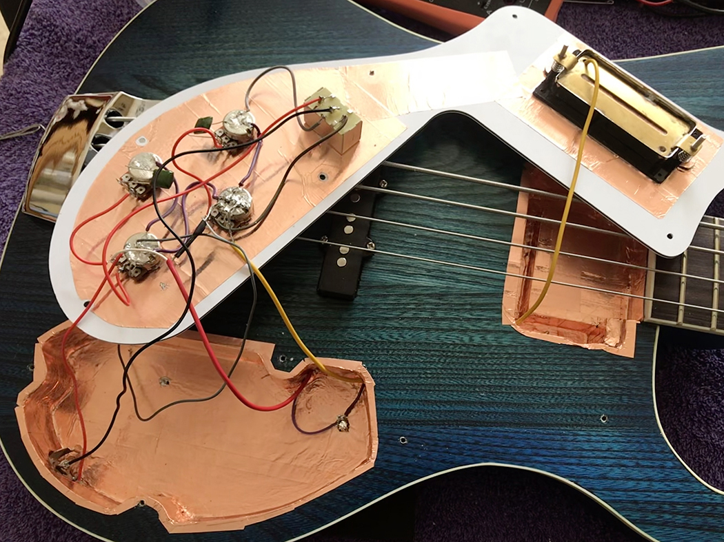

    Your jack ring to pot body readings are high, indicating a poor solder joint somewhere. Those readings should be right down in the 0.4Ω region. But it's hard to understand why as the jack ring to switch reading is low when the switch is grounded from the neck tone pot, and that is reading 8.46Ω!
    Can you take and post a picture of the wiring with the scratchplate off and showing all the connections so we can see exactly how it's wired now. I've been going by the build picture on the cardboard template, which obviously is missing a couple of connections.

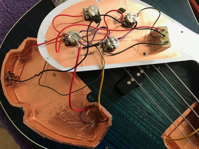

    Thanks Simon, here you go. When I originally wired it I used the colours supplied and as the Pit Bull wiring diagram but have replaced the hot wires with red ones.

    For clarity, the end of the red wire connected to the switch is not touching the switch body tab.

    Also for info, the vol pots (nearest straight edge on scratchplate) are As and the tone pots Bs.

    Going by the photos I can see and the description of the fault it looks like the signal and ground connections on the jack are reversed.
    Nil sound when either volume is at less than 10% would be normal with this wiring scheme.
