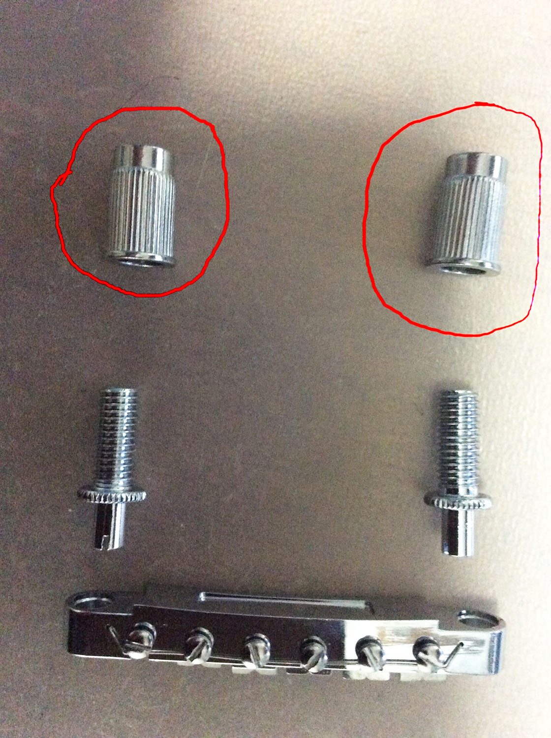

    Another newbie question from me — I know it's very basic, but, being a Fender/Ovation owner, I'm not used to these kinds of bridges. I need to install the bridge posts on this baritone (I'm talking about the inserts as circled in this photo) .....

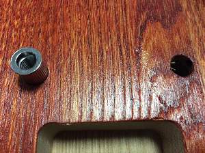

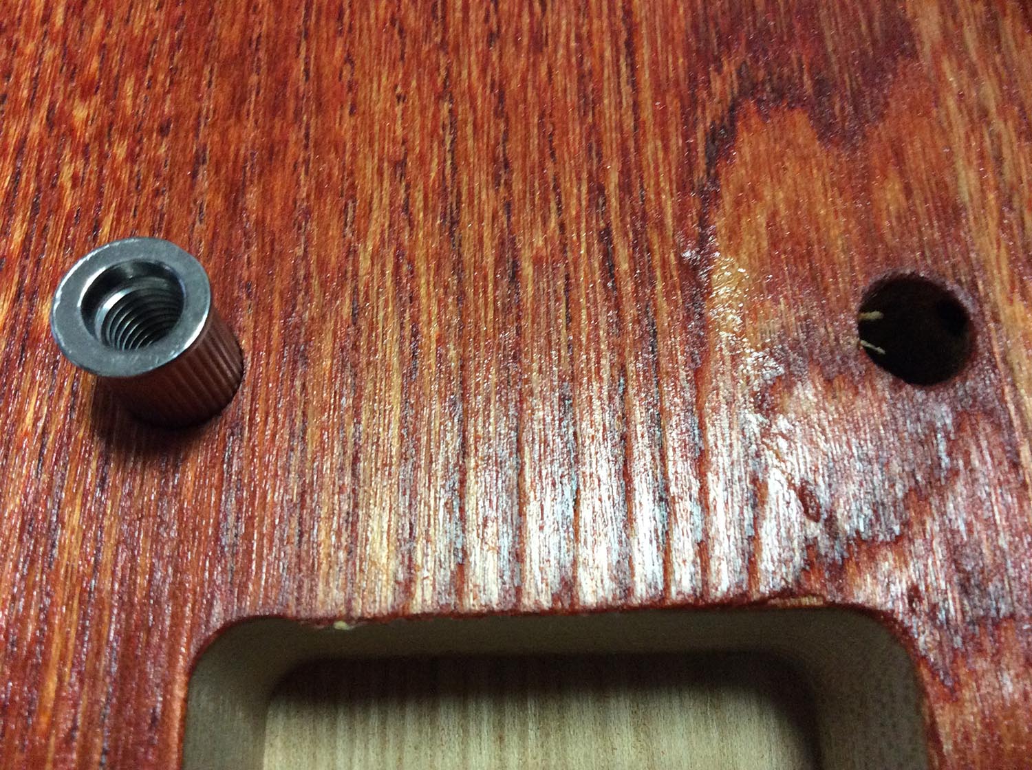

    There are holes pre-drilled in the body to accommodate these, but they're a very snug fit (without any force, the posts would go in about half-way). See next photo .....
Name:	Bridge post holes.JPG
    So, do I push (rubber mallet, maybe?) these in so the top is flush with the body, or am I completely missing the point? Thanks for any help you gurus can give me!
    Yep, just till that lip touches the body usually. Good idea to put them in the freezer for 10 minutes, it makes them easier to tap in then they expand and grab the wood. Not 100% sure on this kit, but often the earth wire needs to be fed into bridge post hole first.
