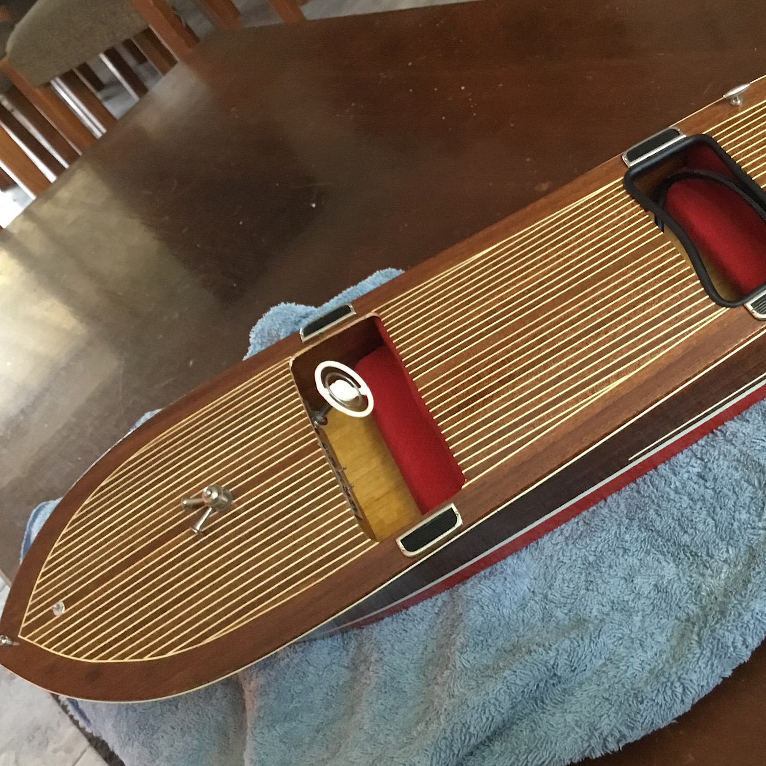

    This is what I first envisioned.The boat deck I rebuilt a few years ago.
    Attachment 29753

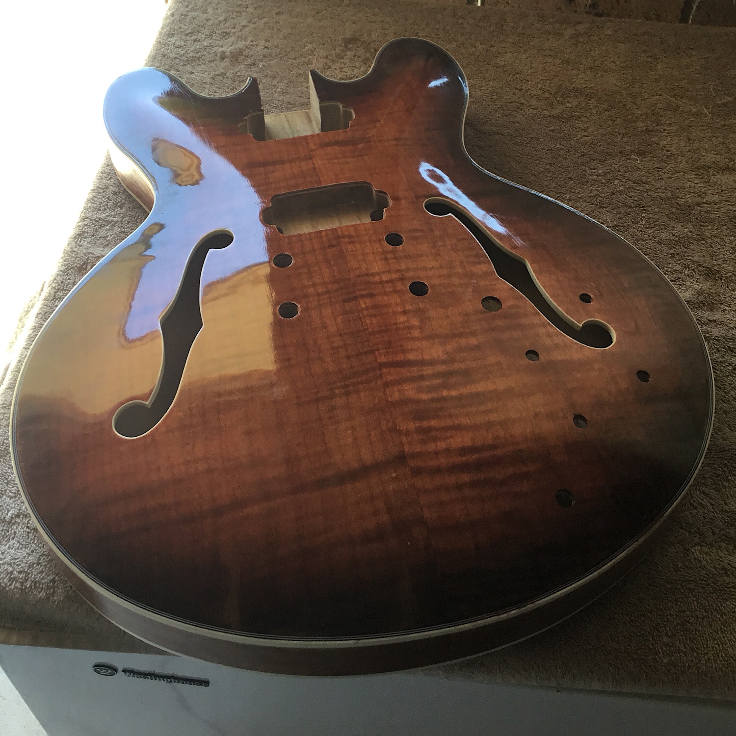

    Yesterday I put some light coats of stain on the top and it looked pretty darn good. I used color reducer to dilute the Jarrah color that I used.
    Attachment 29920
    And this morning I tried a bit of undiluted color to get a bit of a sunburst happening. And then the glue appeared,like magic.
    Attachment 29921 Attachment 29922
    Attachment 29923
    I know the veneer is only 0.6 thin so I don’t want to sand it too much. I tried Desolve-it ,but that was useless. Do we have any ideas how to get this glue off, or do I trash it? It’s so disappointing after the work I have already done.

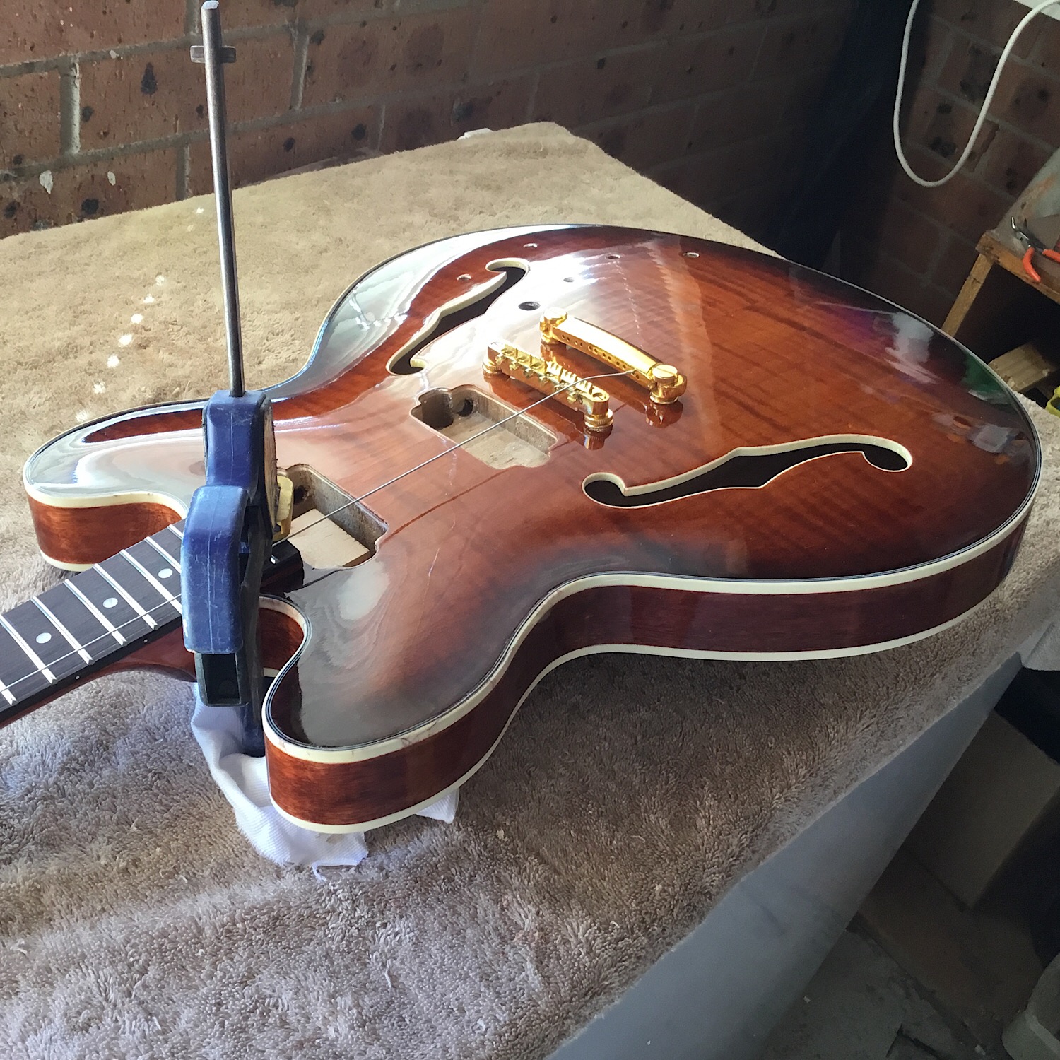

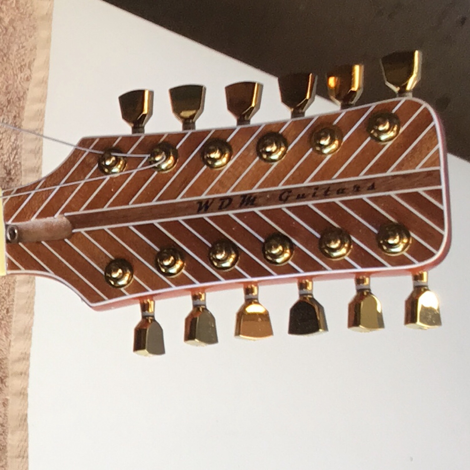

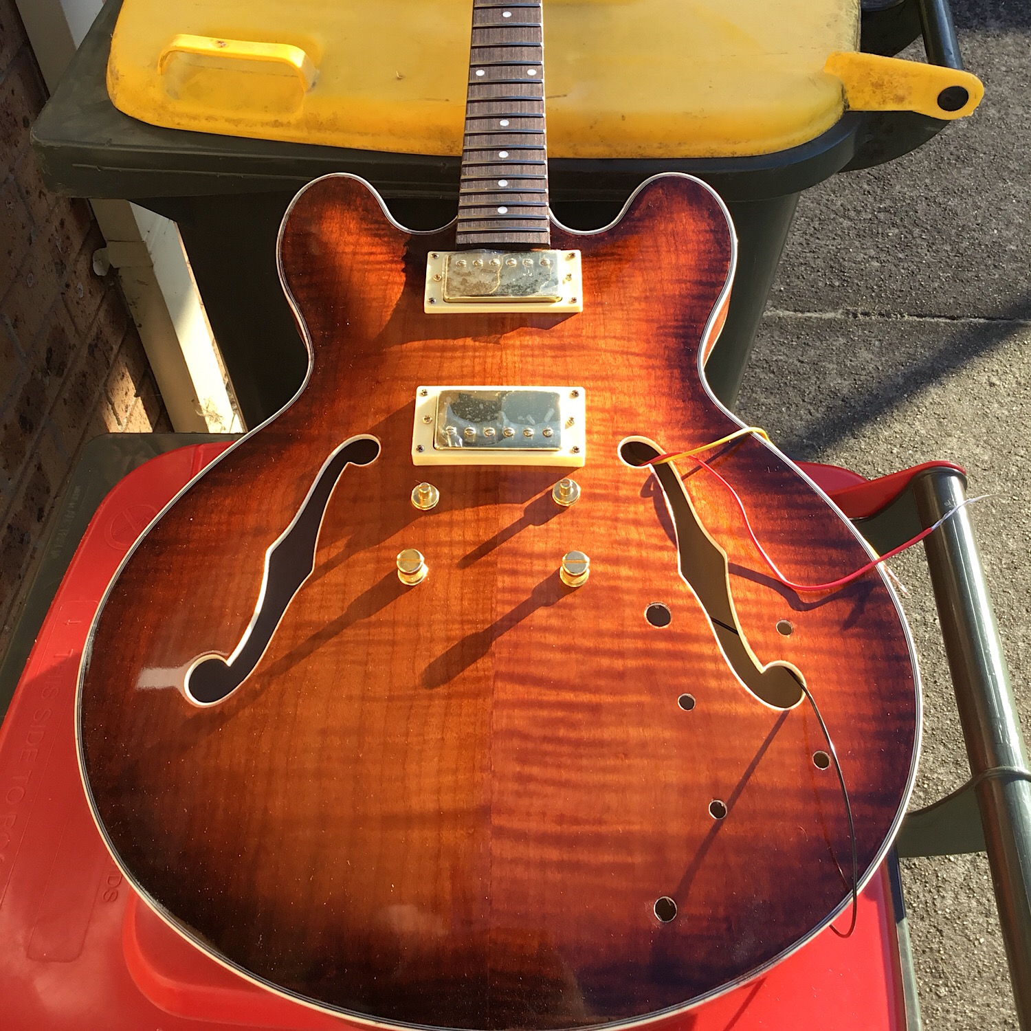

    A couple of progress pics.

    Mentor DarkMark's Avatar
    Sep 2017
    1,570
    Holy Cows! Is that a hand stained burst? Hand stained with coloured lacquer or paint burst? How did you attack the glue spots?

  10. #20
    Member Wayne.Mumford's Avatar
    CAMPBELLTOWN NSW
    236
    Thanks guys, I did the burst with Feast Watson’s timber stain in “Jarrah” . I diluted the color with feast Watson’s color reducer for the main color and tested it on an old bit of pine. I didn’t want to do a burst but the color wouldn’t penetrate the glue spots ,so I went full color around the edges with a cloth a couple of times and blended the edges with the color reducer and it still didn’t cover the glue spots. So I got some varnish that was tinted to the same color and used a small brush to touch up the glue spots before 10 coats of wipe on poly. I also masked up the centre join in the top and gave that a coat of the varnish and it worked a treat.
    This kit has been a bit of cow to work on, with glue spots on the top, and it also had some bad ripples in the flame maple veneer and the binding was really badly cracked in places as if it had been knocked, which got stain in and is now a rustic feature. But I loved every moment of it so far. These things add character to it.
