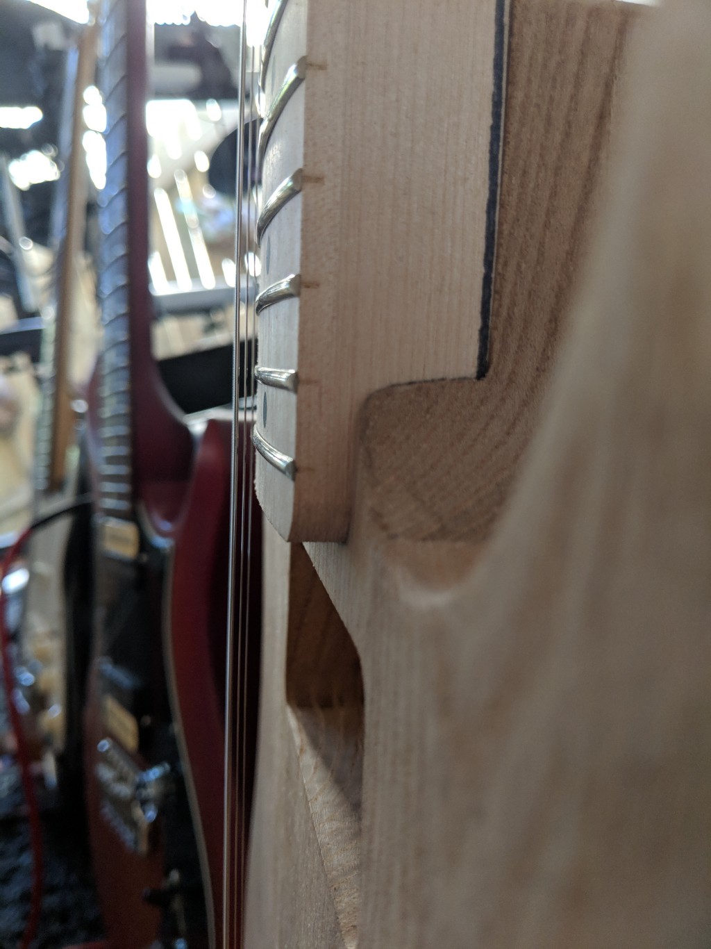

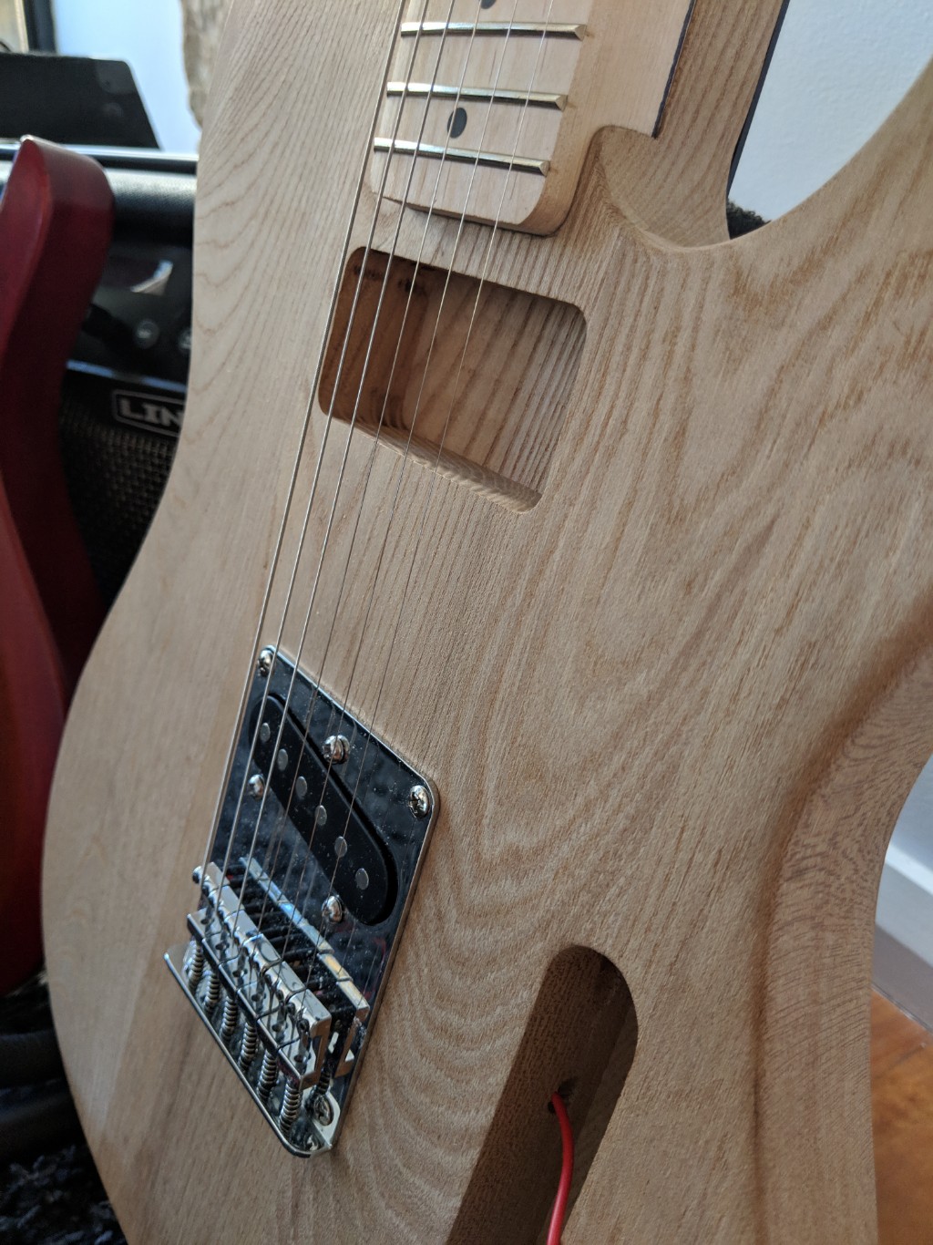

    According to the internet, fixing the pocket is the right way to go so one can preserve one's neck's standard dimensions. A router would be the right tool for the job. Thing is, at 16mm, my pocket is at the standard depth, while the neck, at 26.5, is 1 mm too tall. So I took the neck to the grinder.
    I masked the heel to about 1 mill short of the bottom as markings and sanded it flat against a sheet of 80G taped to the bench top. It was a bit of a challenge to sand it flat but the end result was quite satisfactory.
    Here are a couple photo of what she is looking like now (with saddles lowered to very reasonable heights):

    I'd try for fixing the pocket if the neck angle needed to be increased, as it's (relatively) easy to sand the headstock end of the pocket down a bit and keep the floor of the pocket level.
    But there's no particularly easy way (that I can think of) to sand the body end of the pocket down as evenly without almost certainly creating some unevenness. An experienced woodworker might be able to chisel the wood out, and those with good routing skills might be able to make up a suitable jig, but for the majority of kit builders, altering the neck heel is the easiest way to decrease the neck angle (apart from a shim at the headstock end of the neck heel).
    Good work on your neck heel. All looking great now.
