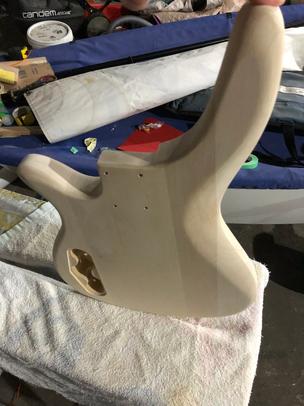

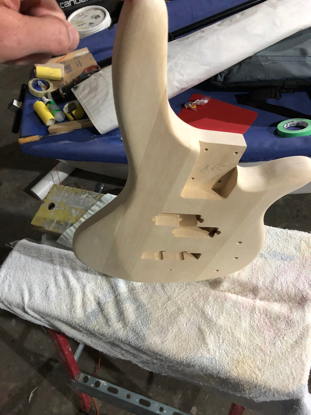

    Sanding, sanding, sanding.... I've read the stories on here, and I can confirm the truth - there's a fair bit - I found it fun, though, seeing the shape evolve. I had a plan for what I was after, but you sort seem to go an a bit of a journey with it.
    Anyway, a picture or two are better than more words.

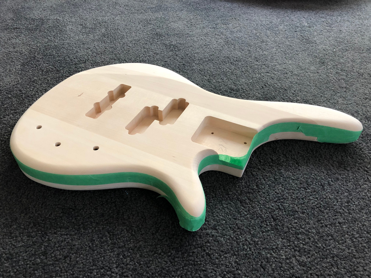

    Masking - some of you'll see where I'm going with this...

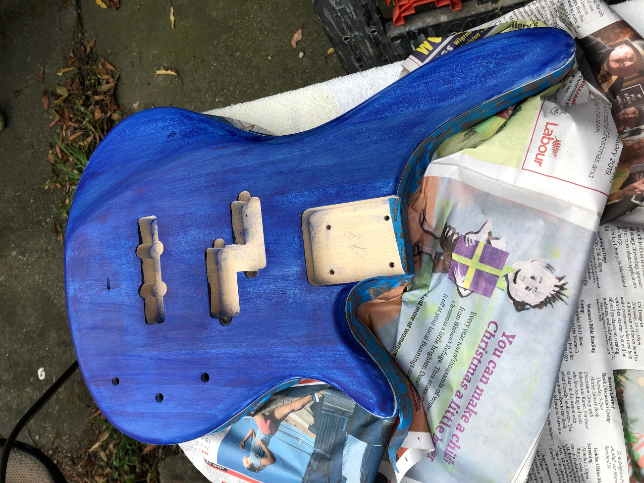

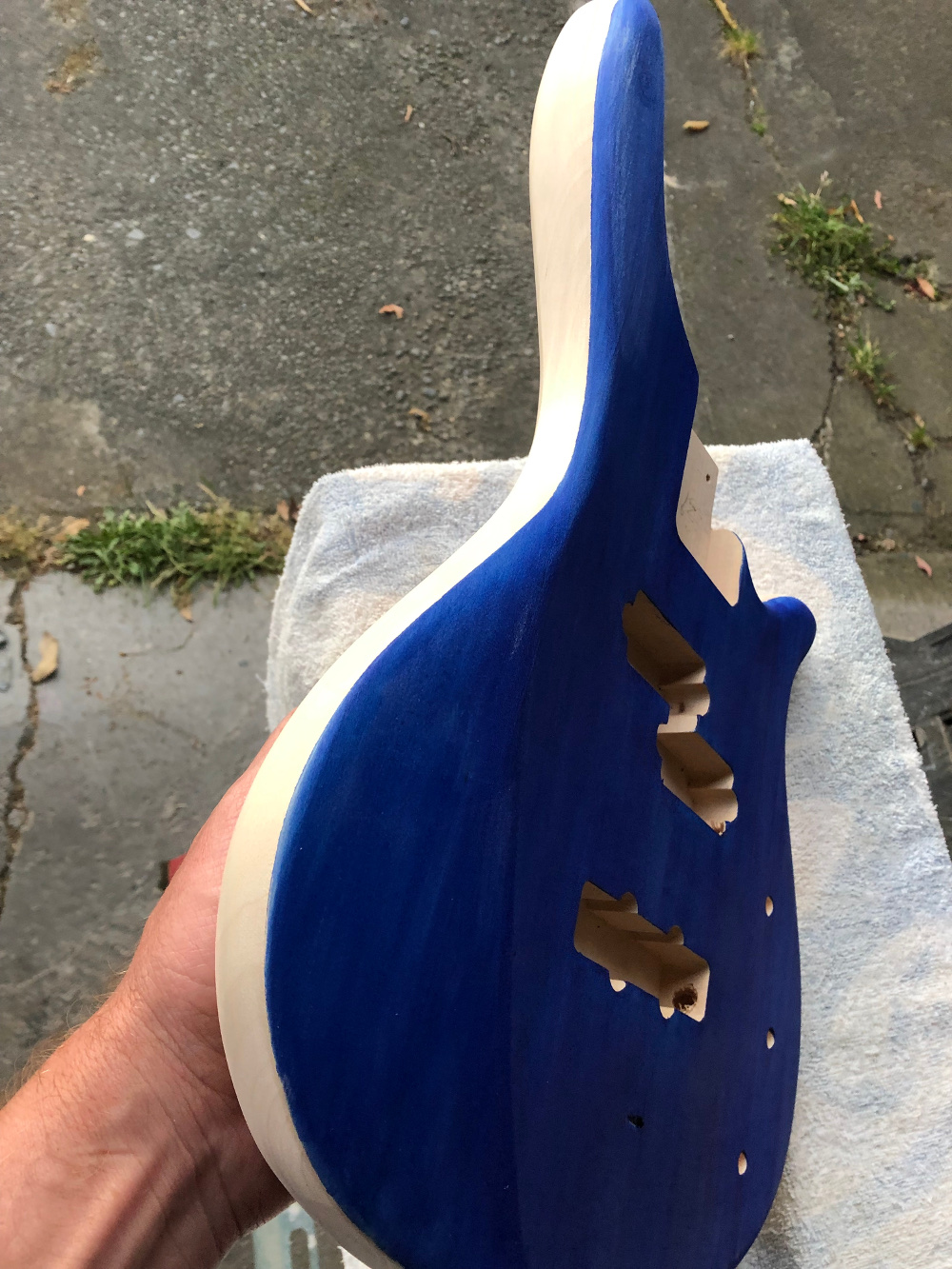

    Staining. It's a basswood body, so pretty light on grain, and with the differences in the colour of the different pieces (as you can see in the above), I did think about going for a solid colour - would have been the easy option for a first build. But I thought "stuff it" (well, the actual word was less polite), and went with my original plan anyway.
    I used Resene Colourwood Apollo Blue - even a test pot was way too much stain, could probably stain about 20 guitars from it! Anyway - for any other kiwi's doing a build looking for a decent wood stain - they have a good range.
ID:	29499Click image for larger version.

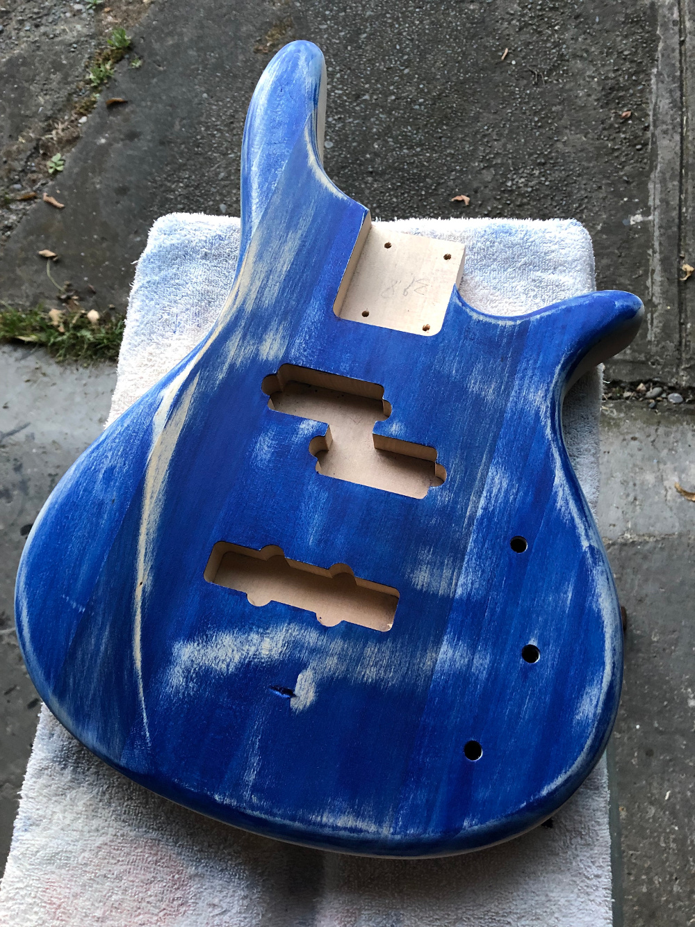

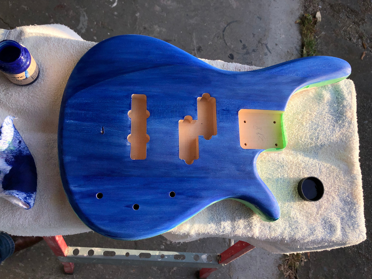

    It was looking good at that stage, then I decided to sand it. Which was a mistake at that point, because you end up with blue powdery wood stain, which goes EVERYWHERE, and is a royal PITA to clean up from any bare wood.
    Anyway, all is well that ends well, and it ended up like this prior to painting

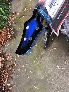

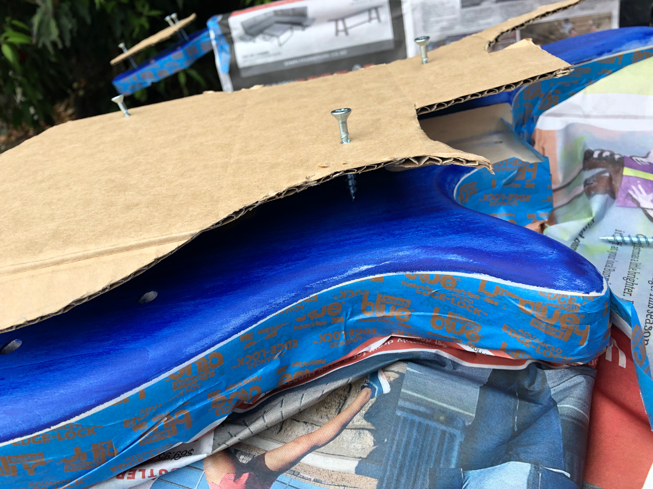

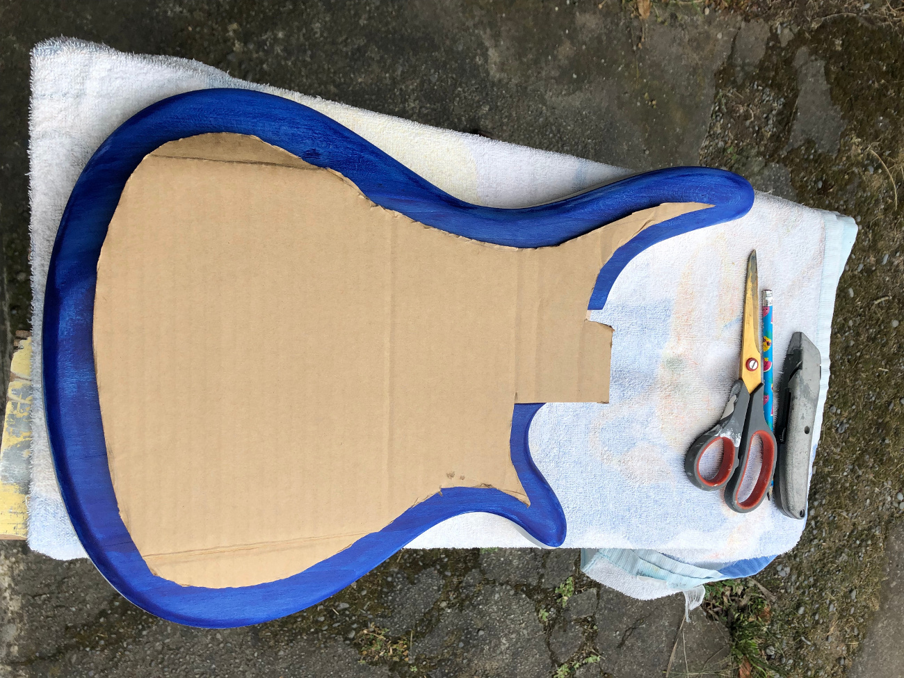

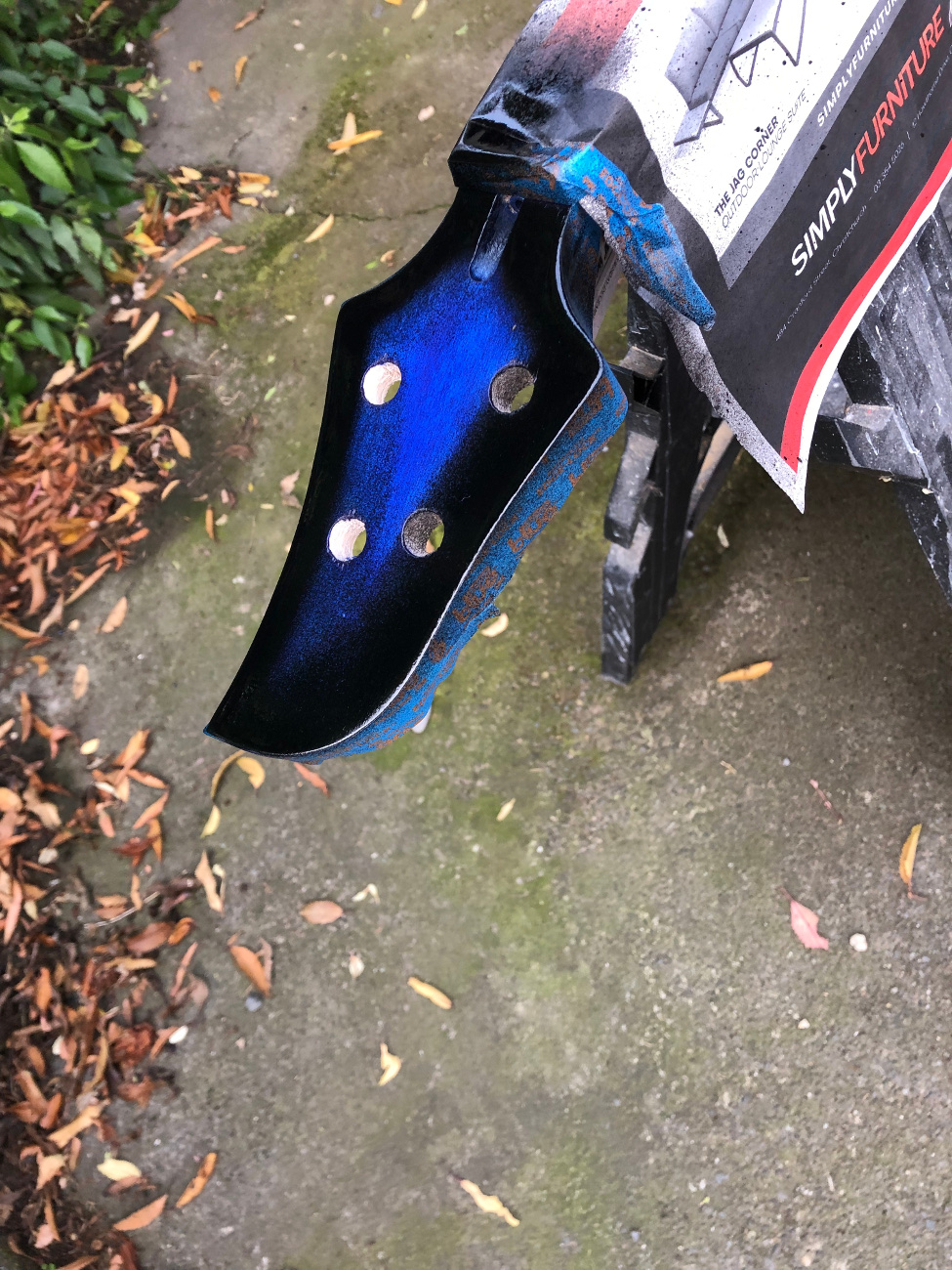

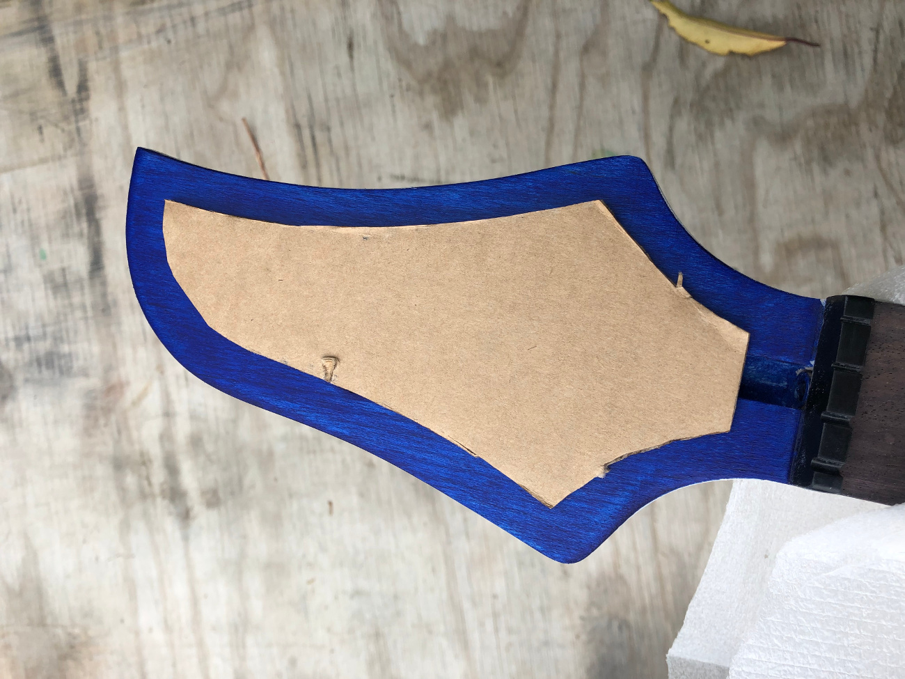

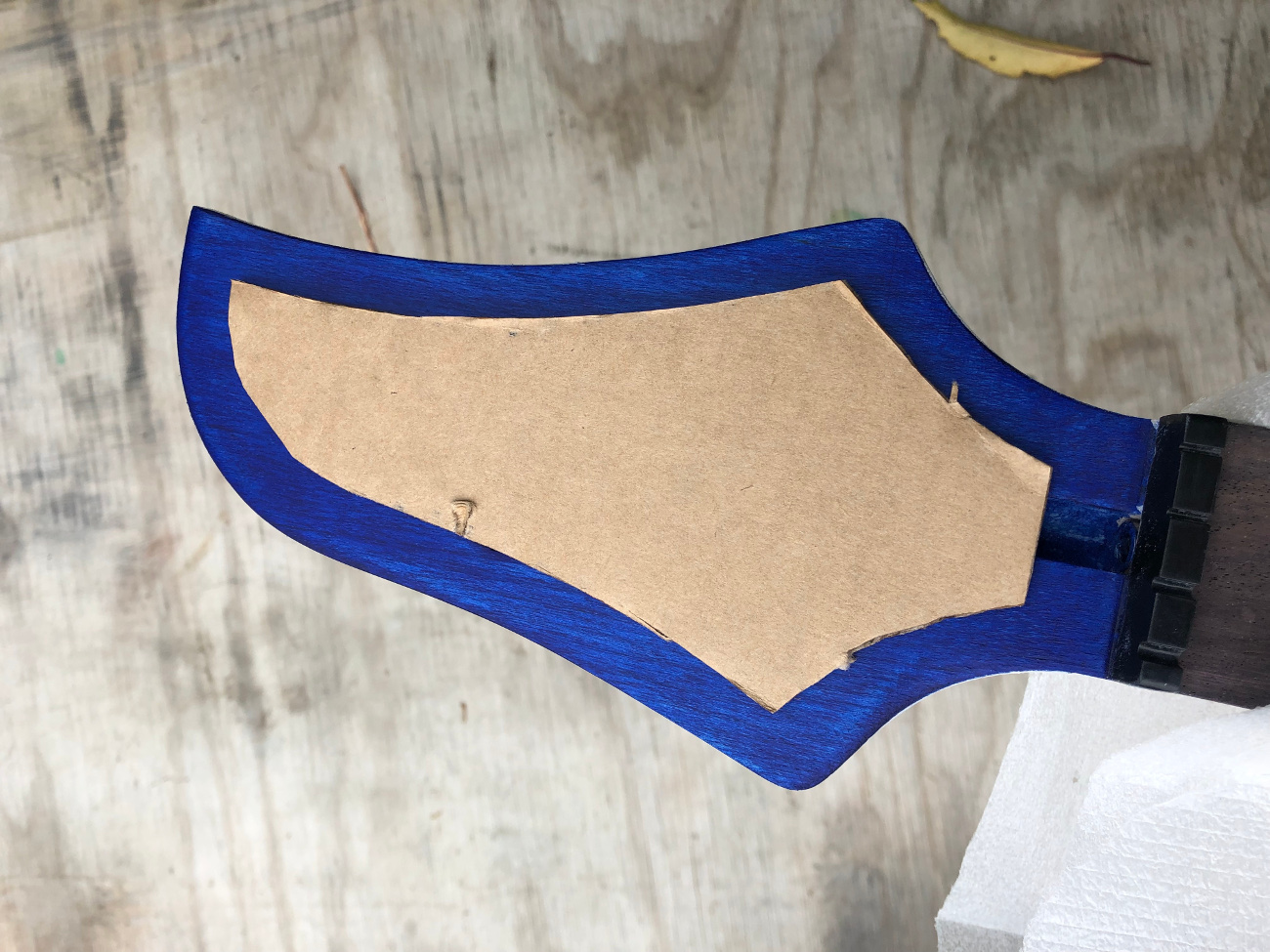

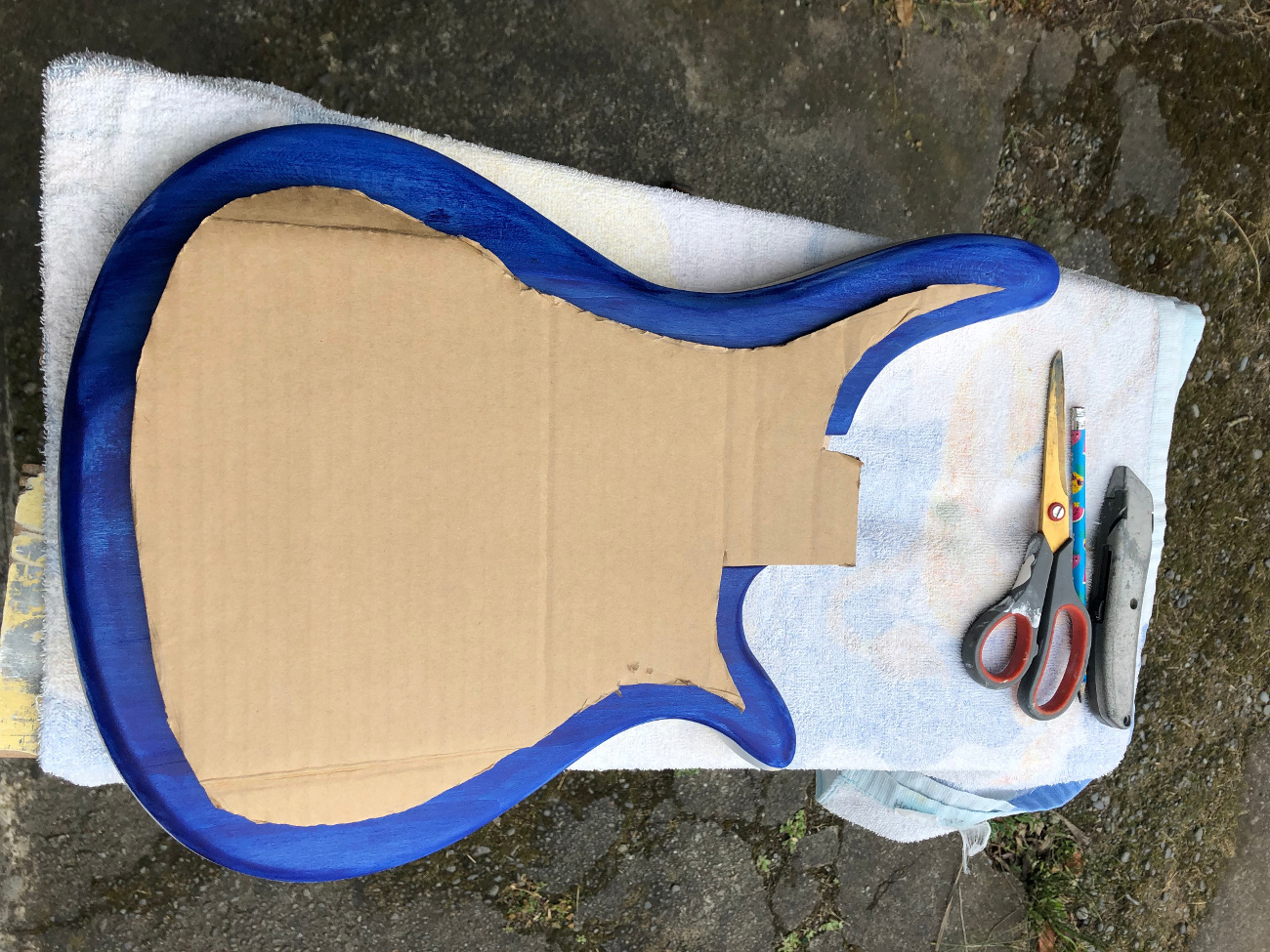

    Next up, I cut out some cardboard shields to sit above the body and headstock, no secrets here - I'm going for a black sunburst effect. I saw this method on YouTube.
ID:	29503Click image for larger version.
    You can see the headstock in the background on this next one.

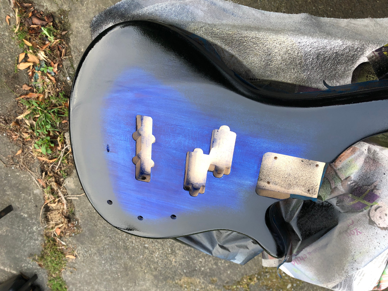

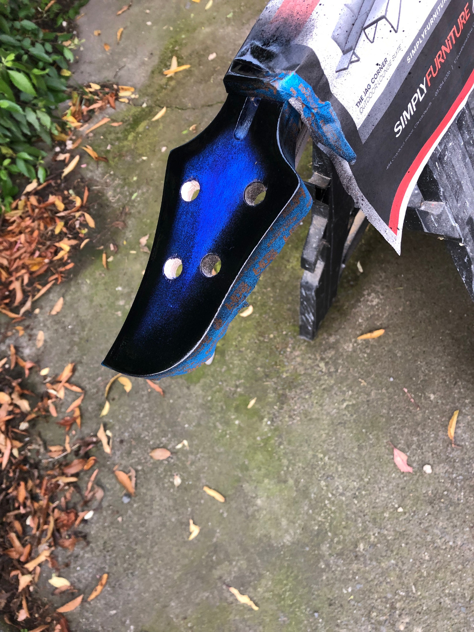

    And the results
ID:	29506Click image for larger version.
    I wasn't happy with the headstock - for obvious reasons. That required a light (very light!) sand, and another go at it. I used Dulux DuraMax spray (rattle can), which has quick recoat times, and seems to give a good result (Satin Black for the burst, and Gloss Clear over the top - but I'll get to that soon).
