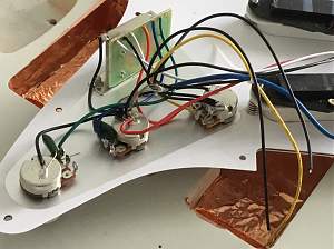

    thats what im working with. I really dont have much of a clue
    The two black wires are your ground wires, and the yellow is your output 'hot'.

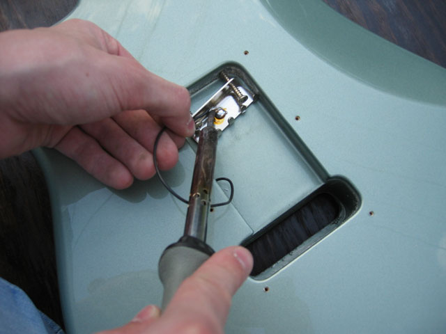

    Feed one black wire through the hole to the trem cavity and solder it to the trem claw:

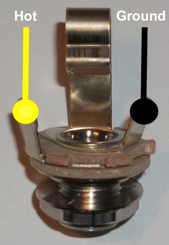

    Feed the other black wire and the yellow wire through to the jack cavity and connect them to the jack:
    Make sense?
    yes thankyou so much
