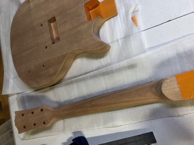

    My kit arrived 12/24. It did not take long at all!. All was in good shape from the journey.

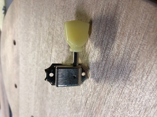

    I began to dry fit everything yesterday and I noticed a few things that are driving some questions. I see that that the neck pocket is cut quite wide thus allowing a lot of side wobble. I am not sure that it would be prudent to shim, as I would have to have extremely thin shims placed either side of the neck. When I glue it up I may have to leave the two E strings on it as I clamp it to assure that I get it on straight? Any suggestions would be helpful. I see that the neck tenon also has been planed with a significant rocker to it so that when clamped I can very the neck angle to the bridge and plane of the body significantly depending on where I place the clamp? I am taking measurements from an Epiphone bolt on Junior to use for rough comparison of potential angles. I am also now aware that I am stuck with the enclosed tuners. I had a set of Replica Kluson classics with nice plastic knobs that I had intended to use but I see that the boring in the headstock is going to be over large for the replica's press-in bushings. I also noticed that there are some voids in the laminate used for the finger board, is there a hardening sealer recommendation for that. When I first looked at it I thought that it was a crack. I don't think it is fatal but it can not be left without filler. I was looking for a project, and now I have one.

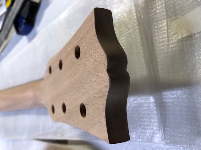

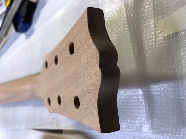

    Started Doing things today: The Gibson esque headstock went better than I thought. I haven't been doing any wood working for a year so I was worried that what skill I had left me. Some is back:

    I was able to find some bushings at StewMac so I can get my Vintage Nickel Kluson Clones to work in my over bored headstock. I am super stoked about that.

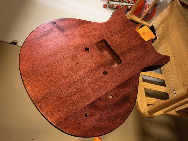

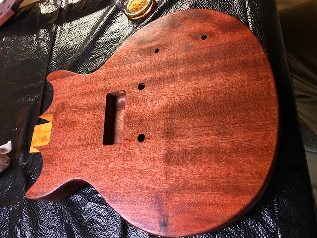

    New Years Day I put my first Transfast water based dye on the body and neck. Today I rubbed in my second coat of tung oil. I am going to do one more coat of tung oil then I plan on setting the neck. I am nervous about the neck the frets are not set very well and seem to pop back out if I tap them in. I have one of the manufactured fret boards, I am not sure if it holds the fret wire in like a solid wood would? If any one can provide some insight I would appreciate that. I may have gone beyond my pay grade right out the box?

    Transfast Light Mahogany I was looking for that SG red, looks pretty close I think?

    Nice work on that headstock shape. looks good. That Transfast Light Mahogany dye also looks the business
