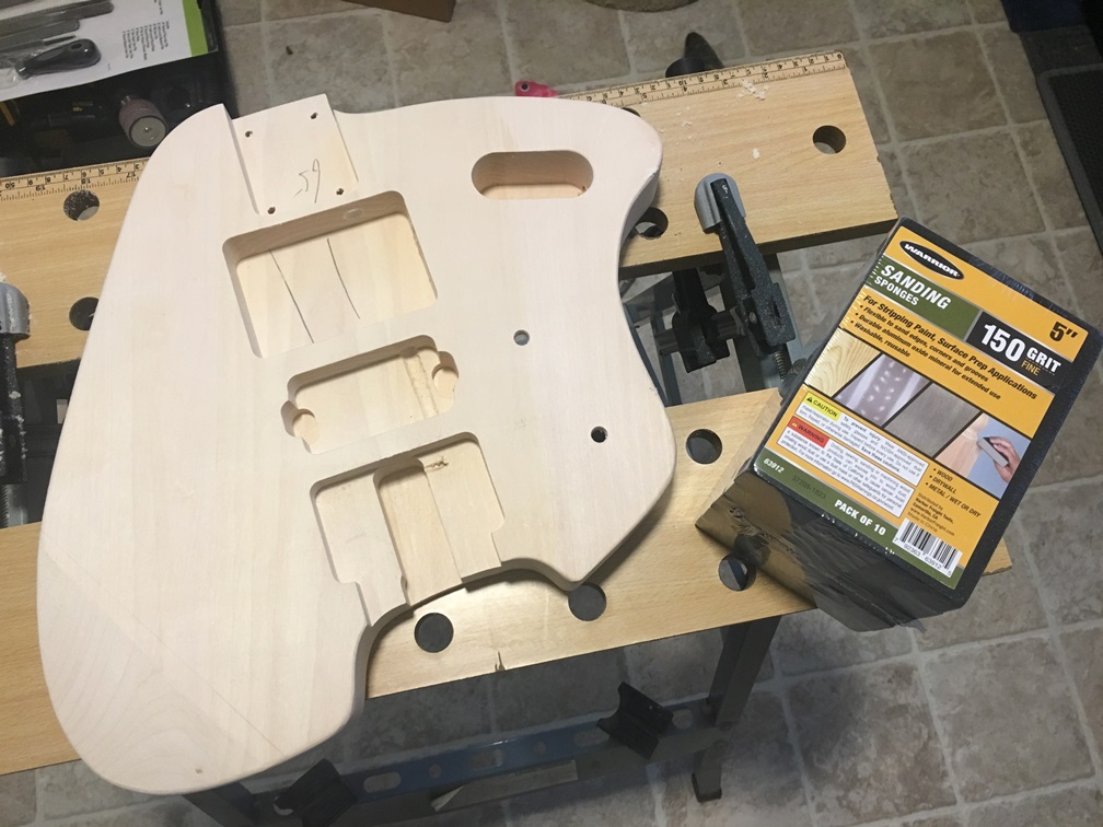

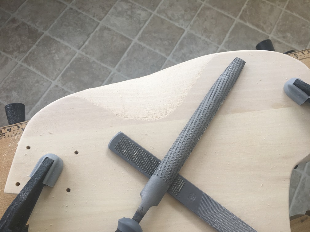

    Been awhile, but finally dedicated some time to get some work done on this build. Got the body contouring roughed in with a rasp a couple of weeks ago, then did some smoothing with a sanding drum chucked in the Dewalt last weekend.

    This weekend, I started prep sanding with sponges ...

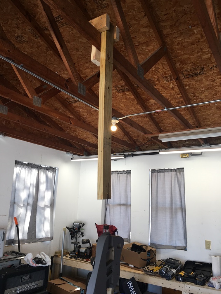

    I made a 2x4 hook hanger to hang it in the middle of the garage while painting.

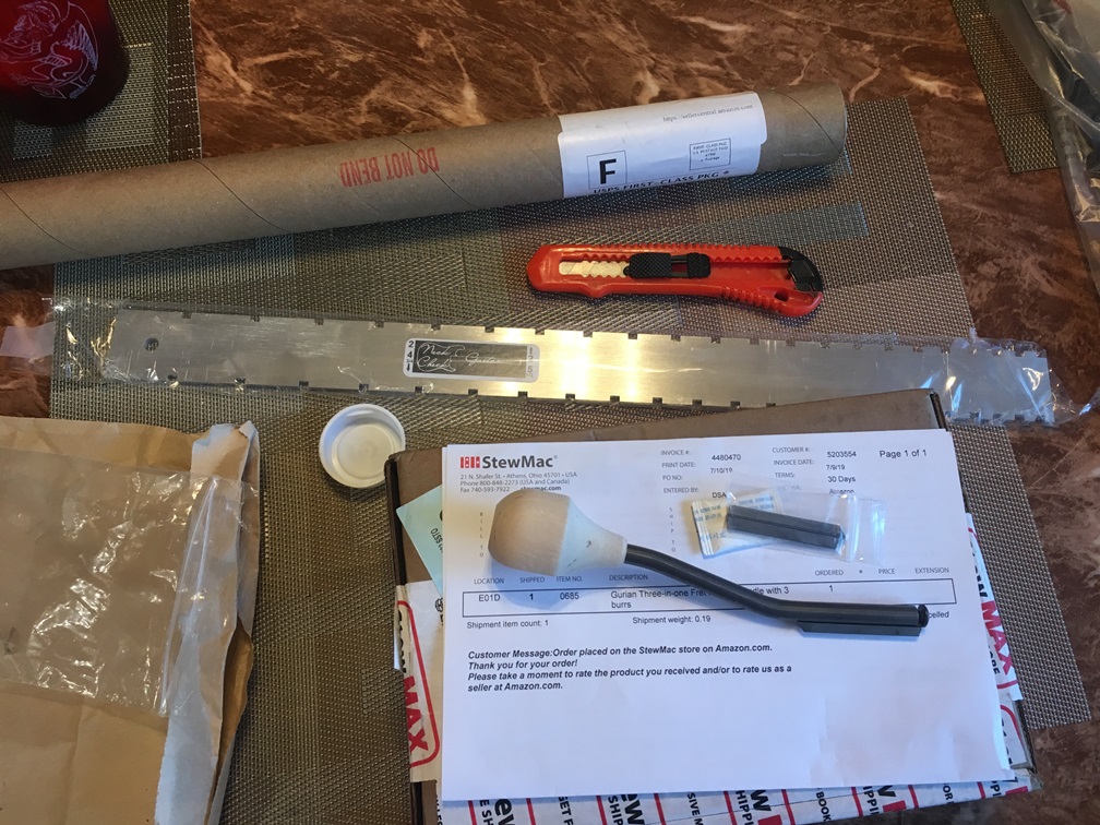

    Been letting this sit for far too long. Ordered a neck check straight edge and fret file, both found on Amazon. They both arrived Friday. Funny, several people here and on other forums suggested getting the 3-in-1 file from Amazon instead of StewMac because it's just as good and much less expensive. I chuckled when I saw the package with the file, as it came from StewMac. Apparently, the same Gurian set I bought on Amazon they are selling for much more on their own site. I'm OK with this.

    Going to try to get into the neck work this weekend. Need to order the HeadlessUSA part, too.

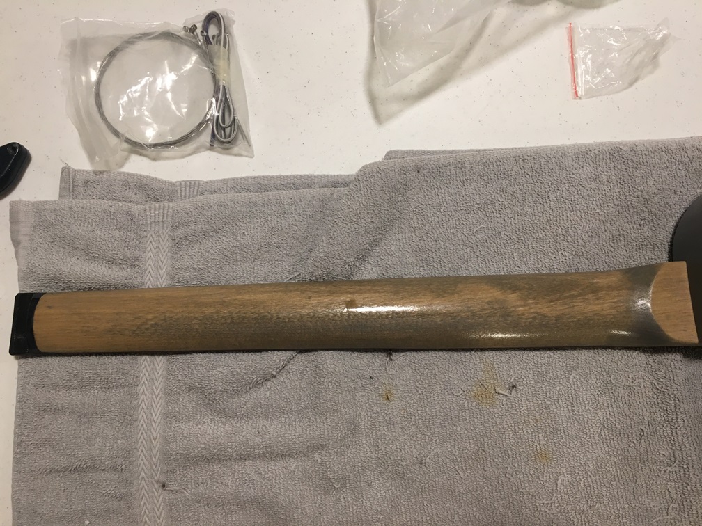

    I finally ordered the new head piece from HeadlessUSA, several weeks ago actually, and it arrived within a few days. I got the neck out Saturday evening and removed the stock head piece. Naturally, the mounting holes don't line up with the new piece. So, I filled and drilled. Actually, cleaned up the surface of the neck end on Sunday and drilled the new holes. The H-USA piece aligns perfectly with the end of the fretboard. The neck profile at the end does not quite match up with the new piece. However, it's less than 1/32" different, so I'm not going to try to reshape the neck there.
    There was a small gouge in the back of the neck when I received it. No big deal, I thought, I'll just fill it and sand it smooth. I used a tube of Minwax stainable wood filler from a plastic tube. Super easy to use. Unfortunately, it also left a big, blotchy brown stain on the wood around the repair. I tried sanding it out, but didn't want to go too deep and end up re-contouring the neck there. So, I left it. I am also using Minwax Classic Gray stain, and was kind of hoping it would mask it. After taping the fretboard and staining the back of the neck, the spot is still there, but less noticeable. I was kind of hoping that the stain would be more ... well, staining. I guess I was looking for more of an even stain, and that's not at all what I got. It now looks like a seriously worn old neck, which is actually way cooler that what I'd planned.

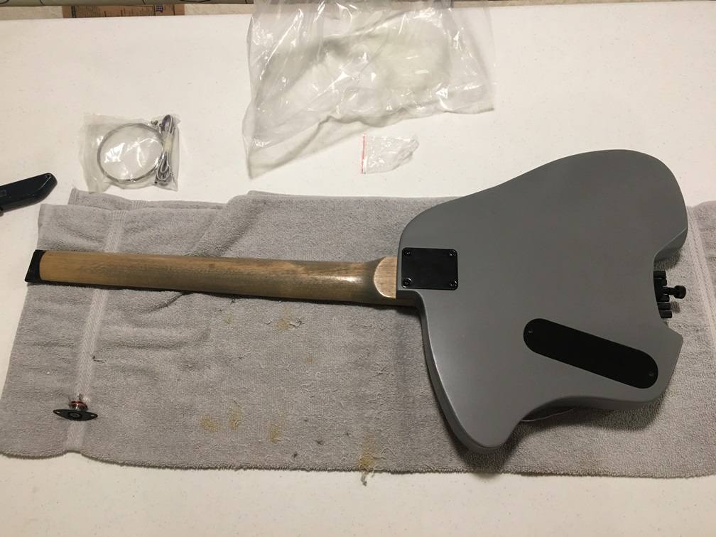

    I got four coats of Tru Oil on the neck this week, and after checking it last night, decided to stop there. I like the feel already, but don't want to make it too thick.

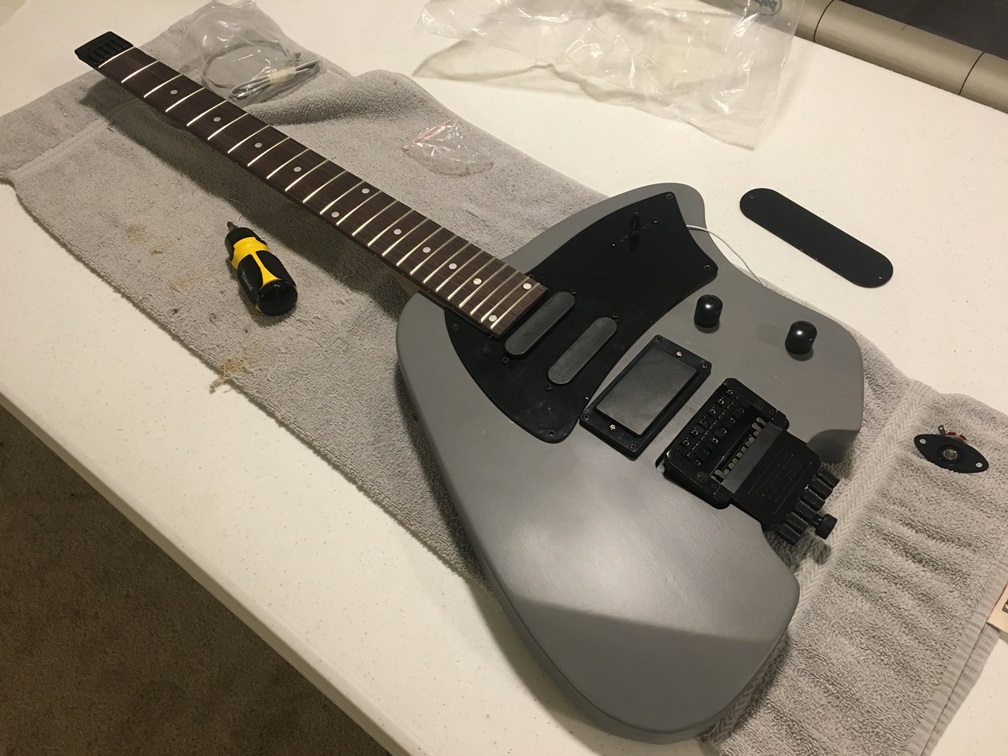

    So, last night I mounted the neck on the body and started on the hardware assembly. The bridge was a little tricky to assemble once the base was screwed into place, but I finally figured it out after some trial and error. There's no good way to compress the spring to get the top in place, other than to put one end against the tension adjustment screw, the other against the top flange, and just push it into place. Turned out I was trying to make it harder than it really is.
    I got the bridge mounted and rechecked the neck alignment with two strings. Still good. Got the selector switch and single coil pickups mounted to the pick guard, and mounted the humbucker.

    Still not happy about that brown spot on the back of the neck, but it is what it is.
    It's coming along. Planning to do all the soldering this weekend, then some setup, which should give me a playable guitar.
    I might actually finish this thing after all.
