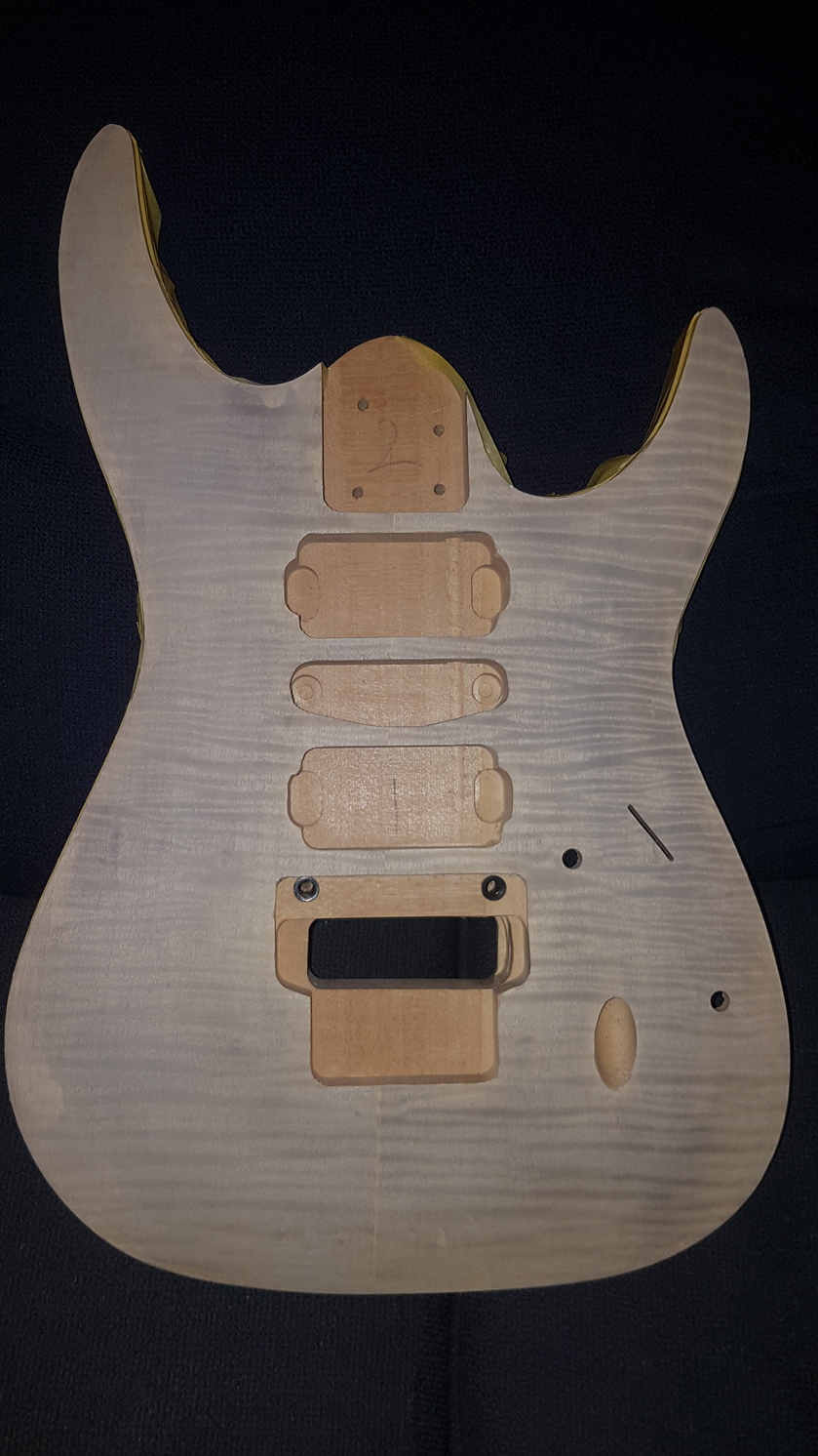

    One day later and the binding is completely gone, the insides of the horns took me almost the same, if not more time to do than the rest of the body.
    At this moment the next hurdle arrises, how to i deepen the binding slots. Went to a wood working shop but they couldn't help me, thought long and hard and finally decided that the easiest solution normally is the best solution, so i glued a piece of 180 grit sandpaper to an old credit card that could form with the contours of the body, and it worked great!
    Bering the impatient person i am, i really wanted to see what it the top was going to look like, so i diluted the black stain i had ordered, and started applying it to the top, and wiping it down with water directly afterwards so i would not have to sand that much. After the stain, some glue spots started showing (picture was taken after first diluted stain and light overal sanding), sanding some more started to hide them (after the picture was taken), but still some are visible, would a thick layer of black stain hide them or should i sand more you guys think?

    Looks like a job for goof off.

    #2 for goof off....... That veneer is very thin

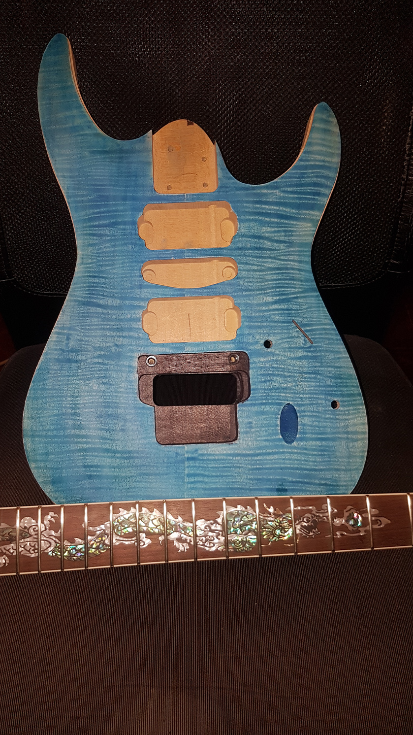

    Some days, and lots of elbo grease later, it's time for another update.
    Goof Off did the job on most of the parts so thanks for the advice!
    It took me quite some time to deepen the binding slots, but its finally done.
    Now the waiting game has begun. The new binding will take another 2-4 weeks till it arrives, so i've applied the first coat of stain and gave it a light sanding and WOW, The flame really pops on this veneer!!!
    next posts coming when the binding arrives!

  8. #18
    5,666
    That’s a fantastic first coat result, it’s such a damn shame the factory can’t seem that Center the veneers better. Great work mate!
