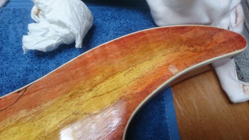

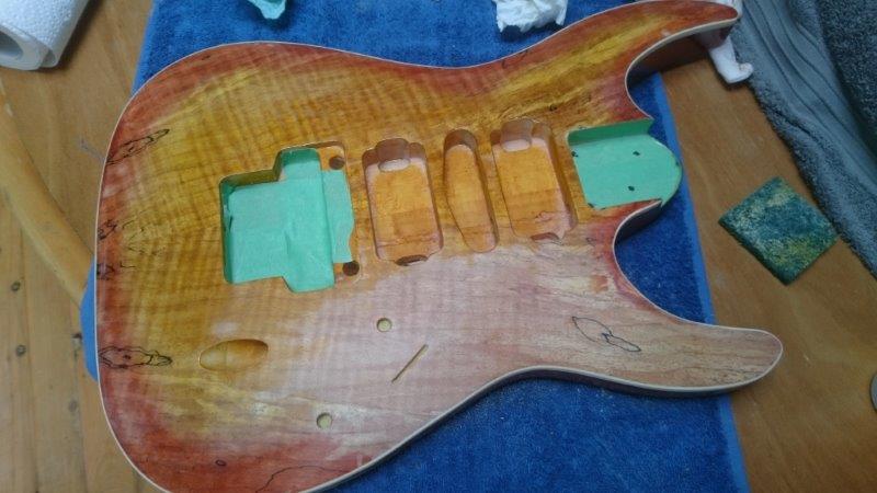

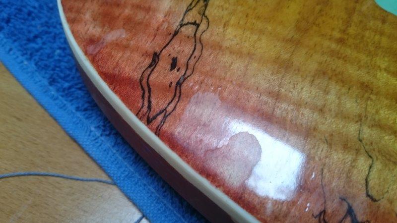

    I think I'm going to name this one the "disaster blaster"...
    Problems with streaky and beading varnish.. and ultimately, peeling off, of entire layers ...
    Oh well ... at least now I get to do it all again !
    I discovered that isopropyl alcohol helped me take all the varnish (and stain) off from the spalted maple without much risk of rubbing through...
    (I also suspect that using the same as a cleaner between varnish coats is what lead to the issues in the 1st place...)
    image 1 and 2... The problem!

    image 3 ... The long road to recovery ...
    Using the ispropyl alcohol and rough plastic scouring pads brought me back to the raw finnish.
    I've also sanded the back and sides back to raw wood too .... back to square one !

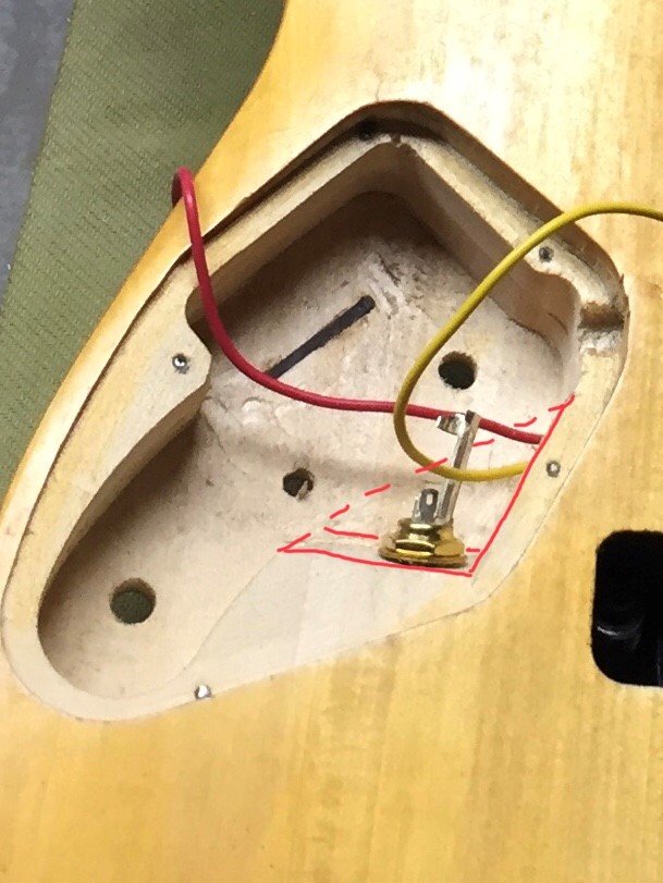

    I've run into two issues with the jack socket on the 'nez and am looking for a little reassuring....
    The socket doesn't take the whole plug...
    The photo shows how far it sticks out. It does actually work OK like this.. Is this normal with that type of socket?
    The other issue is that the socket appears to seat nicely in the body, but doesn't protrude out into the control cavity. So I can't get the nut onto it, to hold it in. Wondering how everyone else dealt with this?

    I found that i had to actually perform some surgery on the control cavity wall to:
    1. Get the nut over the end of the Jack thread
    2. angle the control cavity wall so that the nut would sit flat against it and pull straight on the thread
    See below, your cavity shape may differ as this was an earlier version of the kit
Name:	IB-1 Cavity.jpg
    the red lines are the material i had to remove to get the jack end exposed and the angle on the wall i introduced.
    All I did was get a similar sized dowel to the through hole, allow that to protrude though the cavity and measure off a 90 degree angle to that dowel. Then you just measure how long your jack is, and pare away the wall to get to the appropriate length. I did this with some careful chisel work as there is not a flat plane to set a router on, though you may be able to do similar with a dremel sanding drum or cutting wheel, or perhaps a multitool flat blade.
    I also found that the flange on the jack was almost size on size with the outer part of the hole, you might be able to get around this by trimming down the rubber washer behind the flange, or, you may need to run a dremel 80 grit barrel sander bit around the inside of the outer hole in as deep as you can.
    if you do it that way, keep the dremel moving and don't let it sit on one spot or you'll create a groove. You need to go carefully so as not to bash the dremel into your guitar face or sand through the thin edge of the jack hole.
    Hope this helps!
