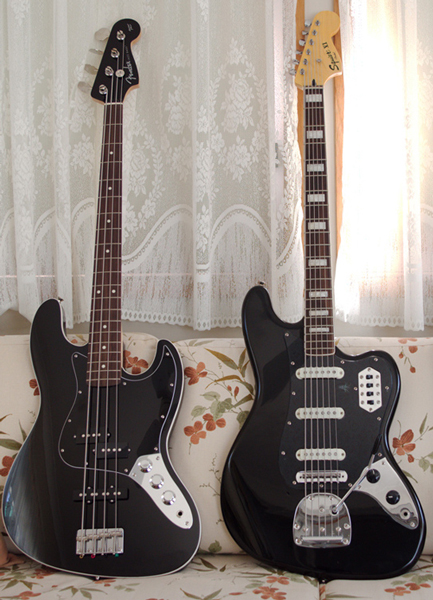

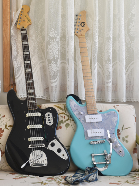

    yup the Bass6 body was more like a P bass size . I'd be tempted to leave a bit more material on the extension that holds your switches and jack, you don't want an accidental yanking on the cable busting the guard.
    Bass6 and Jazzmaster
    Bass 6 and P bass
    Bass 6 and P bass
    Yeah the body definately is a bit more Bass VI shaped. I used templates for P Bass, J Bass, Strat, JM and the supplied pickguard to get the various parts.
    I tried to get a bit more room on the extension but I also have to deal with the existing control routing in the body. Extending it changed the curves and either made it look really long and thin or if I went wider then the controls looked odd as they wouldn't be in the middle. So this design is basically doing a sort of 'S' shape for the controls following the shape of the guitar and using the existing control locations with a single extension route for the plug.
