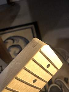

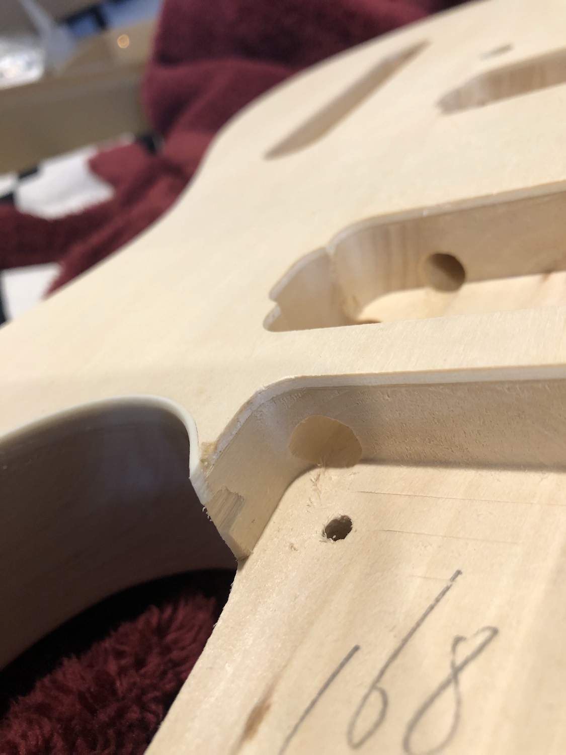

    I had a go at trying to fit the neck into the body.
    Was incredibly snug and actually caused a bit of wear and tear.
    I'm not too fussed with it as long as it wont affect tone or playability.
    Took some photos to show.

    I was also wondering, in regards to sanding the sides down to fit the neck, how do I tackle the binding (see picture)? Is it best to cut it with a box cutter, or will sanding it back as well be fine?
