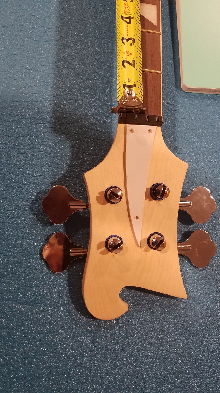

    Don't know about you but this tugs at my OCD.
    With this comparison I'd be hitting the dowels licketty split!
    I've flipped your image to make it a right-hander but you'll get the drift.

    Say Mark, I see it, but can that be cleanly done without a headstock veneer? I seen them use dowels to fill, but won't you see that afterward? Are there any other builders who've done this that I could see?
    I've done it on my guitars. Veneer is necessary if you want to keep the maple finish.
    Painting it of course means filling the gaps....but not with Timbermate (cheers Phrozin)
    There's always the option of living with it as is.
    cheers, Mark.

    Well now that you pointed it out, it kinda bothers me. It was something I noticed but hadn't considered modifying. Would veneer require shaving down the surface under the veneer? You'd fill the holes, glue down the veneer, then re-drill, huh? I'd have to route the edge after gluing?

  6. #16
    Quote Originally Posted by OctoberBassRCA-4 View Post
    No, the veneer is pretty darn thin and you wouldn't notice once it's glued down.
    I just trim it within a mm or so and then use sandpaper to finesse the edges.
    cheers, Mark.

    Mark, if I go this route, could I veneer the walnut wings and maple in the middle? I've never done this before, but what the hell? This seems rather intense.
  10. #20
    I've only done Fender style headstocks but I can't see why you couldn't experiment.
    If it all goes balls up (which it shouldn't) you can always wood fill and then paint it.
    cheers, Mark.
