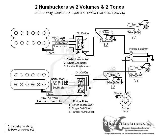

    I wanted to do a little experimenting with switching before I put the wiring harness in a semi-hollow body. I was thinking of using switching like in the diagram from guitar electronics. Position 1 and Position 2 make sense to me. For both switches this is...
    Both up series (position 1)
    Both down parallel (position 3)
    The middle has me scratching my head, though. The way it's labeled, the upper pickup, with the switch at position 2, should be single coil-North. What I see, however is that the North coil does not go to ground so it should be "off" in position 2. The hot lead seems to go to the South coil finish, and the South coil start is grounded. So, it looks to me like this is single coil-South rather than North.
    On the lower pickup position 2 is labeled single coil-South. What I see, however, is that the hot lead goes to the North coil start, and the North coil finish goes to ground. Both South start and finish go to ground so the South coil should be "off."
    So, to me, it looks like this switching will work, but that the single coil settings are actually the opposite of the way they are labeled. Do I have that right? Or am I, as usual, missing something. The switches I am using are like the on in the pic.

    Yep, the way it’s drawn the upper/neck pup splits to south coil, and the lower/bridge pup splits to north.
